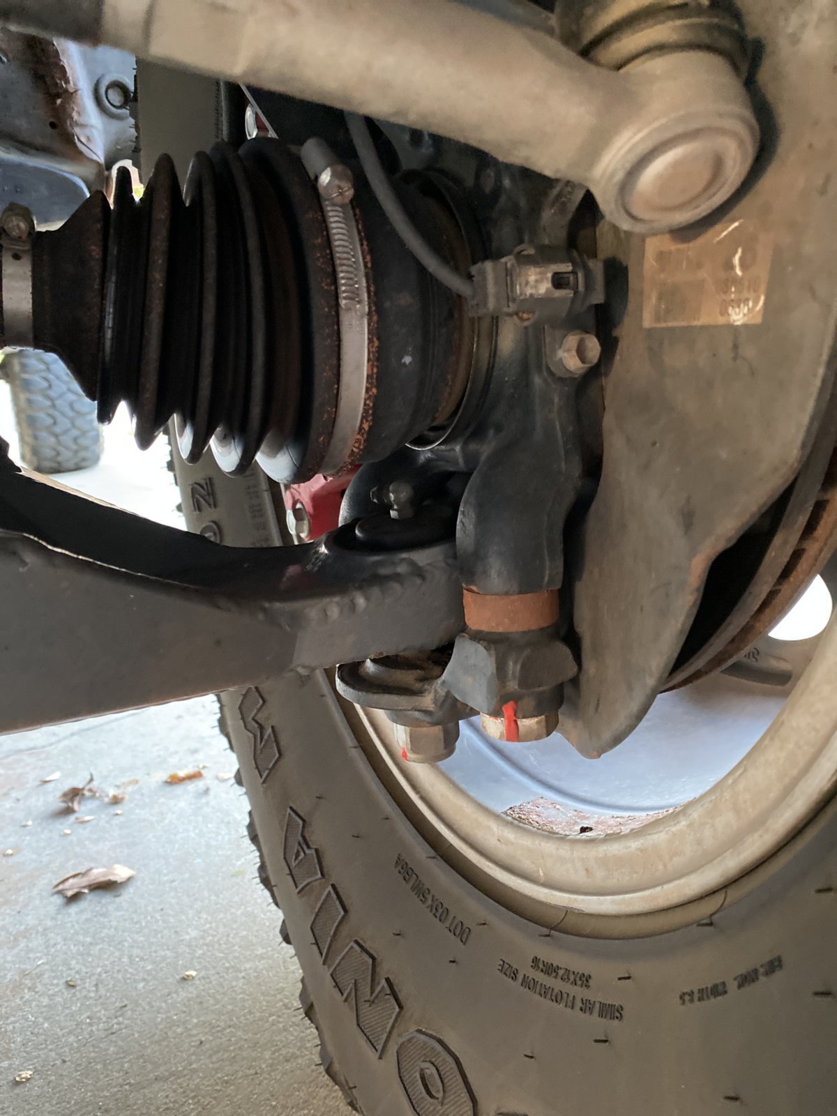

    This is a Camburg race kit. Note the ding from the bolt hitting the LCA when steering is at full lock. Any recommendations on a solution? Should I weld a pad or just not worry about it?

    I don’t worry about mine. Mine have gouges a bit bigger than that.

    plenty of us on here don’t have steering stops. So far mine hasnt even scratched up the power coat on the LCA. Where @soggyBottom is running into issues is his kit has the inverted spindle adapter that puts the bolt hitting the top of the LCA. If the adapter was hitting the arm square on, it wouldn’t be an issue. However having forces applied to the fastener like that is problematic, not to mention the nasty gouge it left. I’d add a stop to the LCA. A lot of kits keep the stock spindle adapter and cut the steering stops off.

    That was what I was thinking. I don't wrench down on the steering wheel at full lock but it does touch every now and then. I'll probably contact Camburg and see what they say. It seems like there could be a safety issue here with the bolt.
