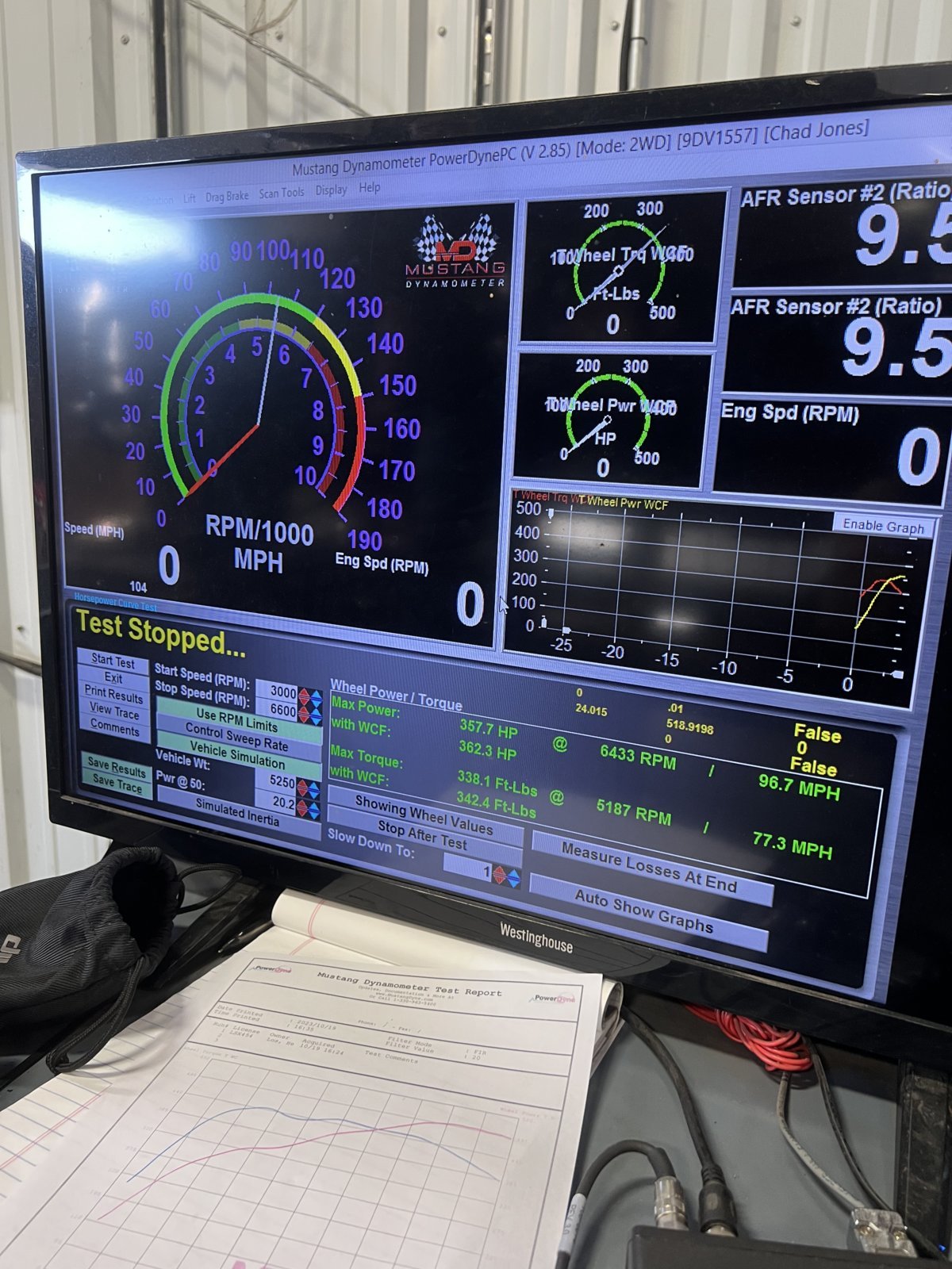

    So
    Results are
    Exhaust is choking out the motor
    And my air filter/ filter tube/ throttle body andddddd intake manifold are choking the motor
    so
    Basically I’m leaving a metric shit ton of power on the table till I fix those things
    good news tho
    She’s fuggin fast for how it is currently

    I'm surprised af at those raws.
    My 2gr setup would give you a run to find out whose driveshaft is balanced better once I get the front end to suck less ass.

    So I hadn’t put too much thought into it until now
    But
    My exhaust from the Y pipe back
    Basically necks down to 2.5 into the muffler and then after the muffler down to 1-7/8
    so the recommended fix was
    Go 4” from the Y pipe back
    and put a 5” intake tube/filter on the front

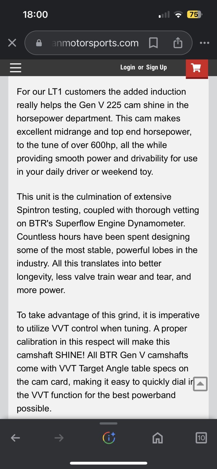

    Mustang dyno was saying est 501 crank
    So you can get an idea of how choked it is since the 225 cam alone should make 600
    but I definitely lost power on the dyno from the 4.10 diff gears and him only doing a 3rd gear pull at the limit of the driveshaft

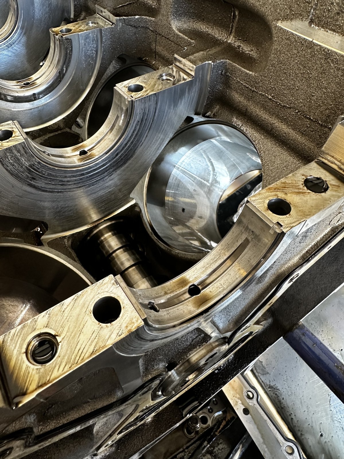

    Well I toasted the LS.
    it’s off getting a fully forged stroker rotating assembly, cam, ported heads etc.
    Who knows these motors pretty well? I have that nice sikky pan with a remote oil filter bungs, I need a remote oil filter kit than can facilitate an oil filter, as well as an oil cooler. Bonus if it can accommodate an accumulator as well. Who knows how to do this? And how to route oil lines?

    need a dislike button :( what happened in there ?

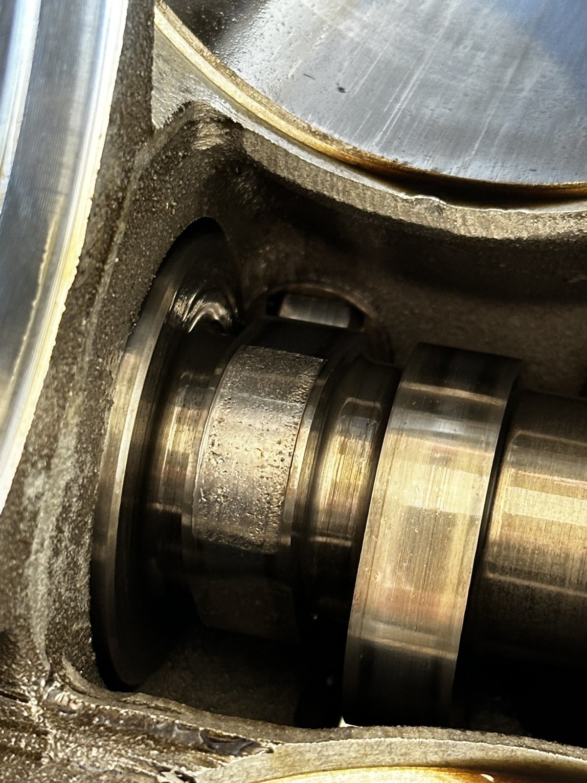

    Thrust bearing failure, destroyed the rotating assembly with all the metal, destroyed the cam, destroyed lifters. IMG_6779.jpg
    Pretty sure it was engines previous owner that caused it, and not my brand new 4L75E. The converter I had was way too high of a stall so that could be an issue too, overheating it and ballooning the converter into the crank. But I’ll have a new one on the way. The new motor is a 5 figure build so I’m deathly scared of hurting it again once it’s back.
