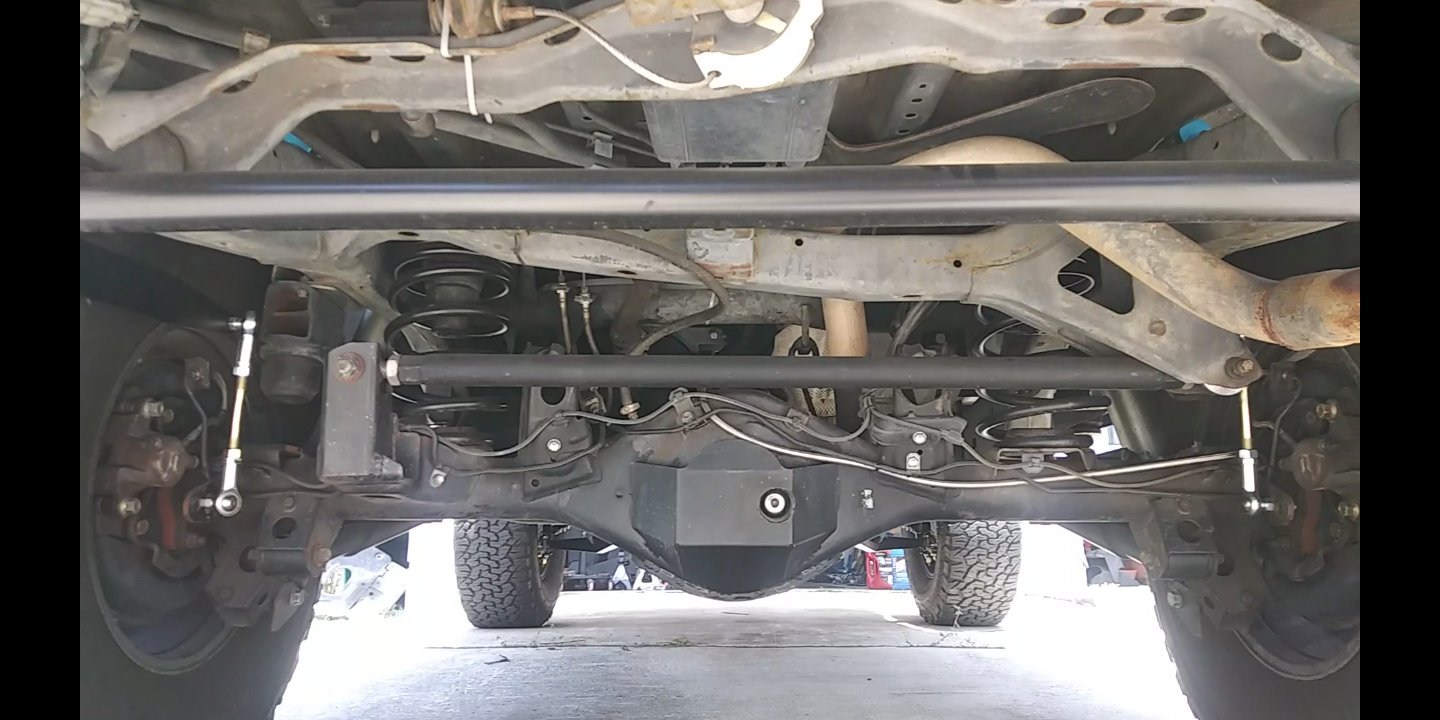

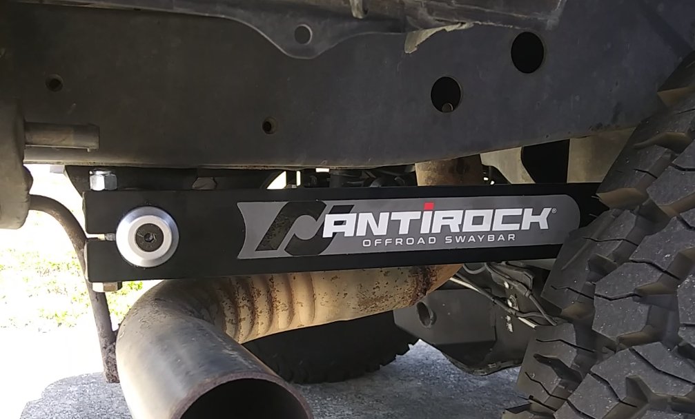

    @thegame If you aren't carrying your spare under the back, the FJ Anti Rock Bolts right up. Love mine, but damn they got pricey. Screenshot_20220908-083635~2.png Screenshot_20220818-164120.png

    It's because the Tacoma is on leaf springs which are inherently more stable than the linked coil suspension of the 4runner. That's why the Tacoma doesn't come with a rear swaybar to begin with.

    The best solution would be to get a swaybar like the one posted above, and tune it to where you are happy with body roll and suspension performance, then tune your shocks from there. If you tune your shocks to deal with body roll, it may not roll anymore, but the shocks will perform worse than they did when you just had the stock swaybar in the back to begin with.

    Damn that's serious lol. I think I'll pull the sways and plug a bleed hole in the front shocks and see what happens. Worst case it doesn't change much and I put the sway back on. Rather not go with that big anti rock, especially for $1000 :eek:
