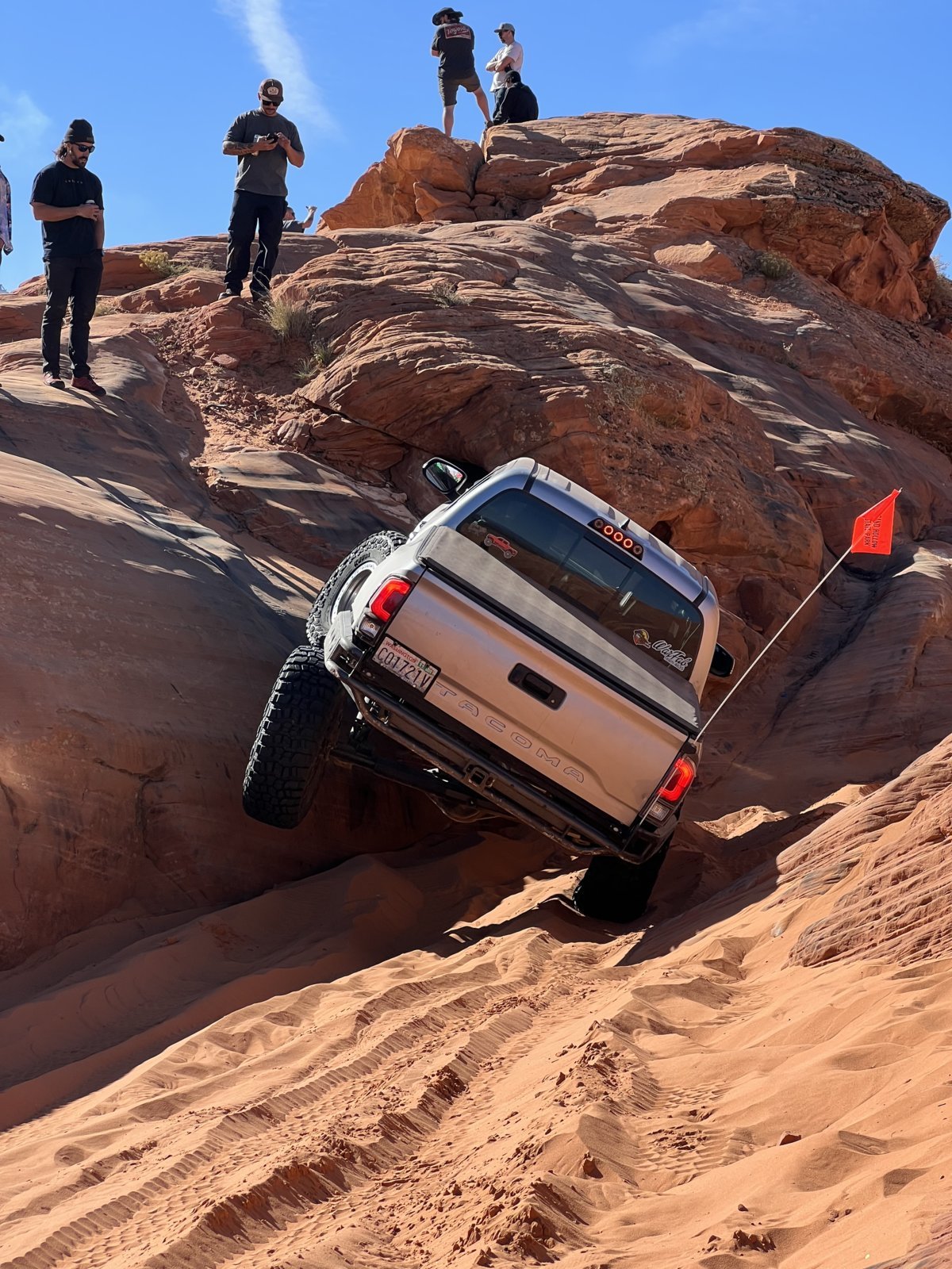

    I prefer a sooner bump so the frame or slider ain’t on the ground at any point. Keeps a higher break over angle as well. This is about the stock bump location, another buddy has probably 4” more uptravel and it drove like a Honda getting stuck on speed bumps

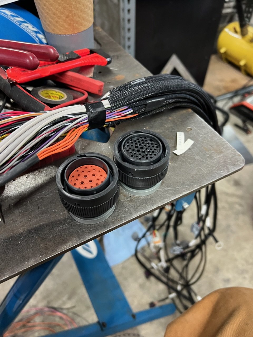

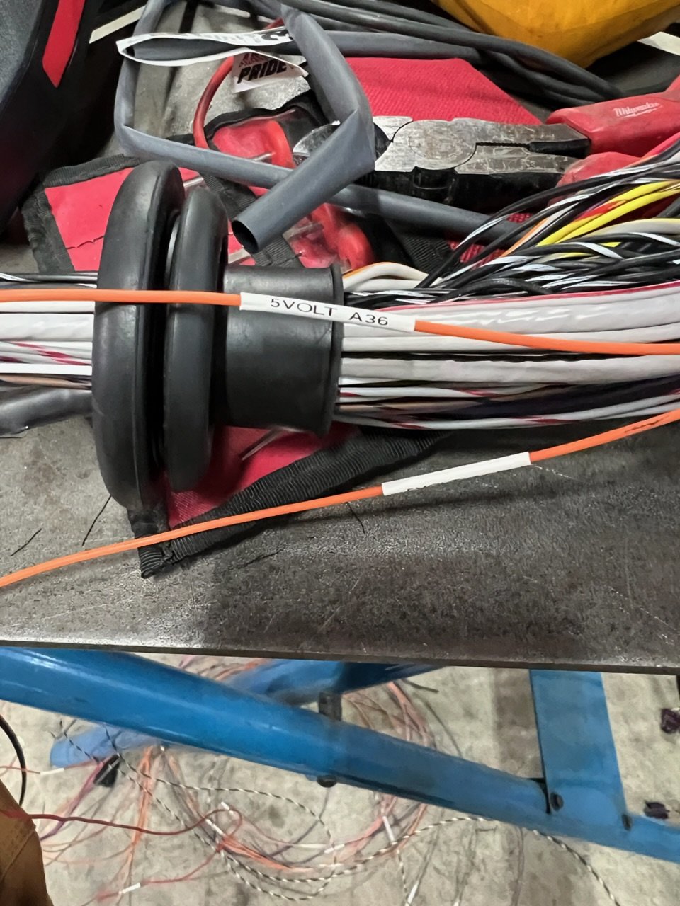

    And people wonder why it takes me so long to work on my truck… setting up for a new haltech engine harness over my old psiconversions… putting the harness thru deutsch bulkhead connectors and setting it up how I like takes a lot of time…

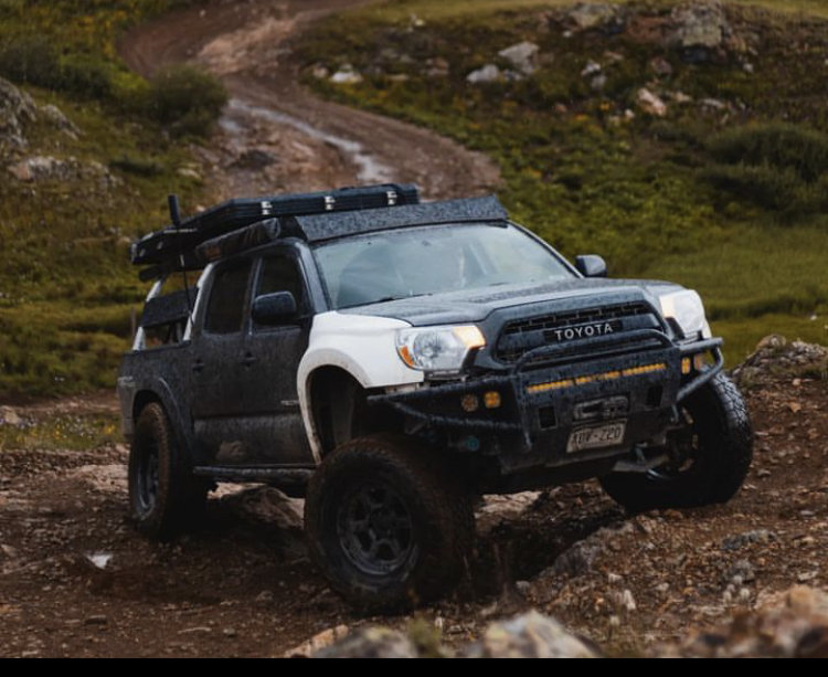

    This was from an old tundra thread comparing mcneil, adv and fiberwerx fiberglass.
    is there any truth to this? I see a lot of people switch to 4” glass and sometimes the fenders swallow up the old bumpers but sometimes they look like they fit pretty well. I could never figure out the correlation until seeing this

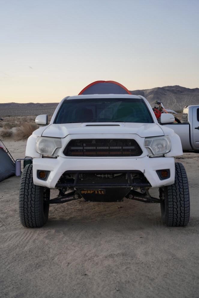

    this is my ADV 4” glass with an oem front bumper. The bumper has no fender flare piece on it, like this:

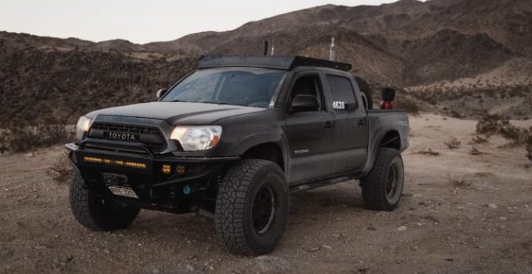

    Thanks. I was interpreting that as aftermarket bumpers idk.
    these were on instagram the old bumper seems to fit pretty good with both oe and 4” McNeil i think it is.
    but ive seen a bunch where similar looking bumpers stick way underneath certain glass. But maybe just didn’t have as much of a horn sticking out
