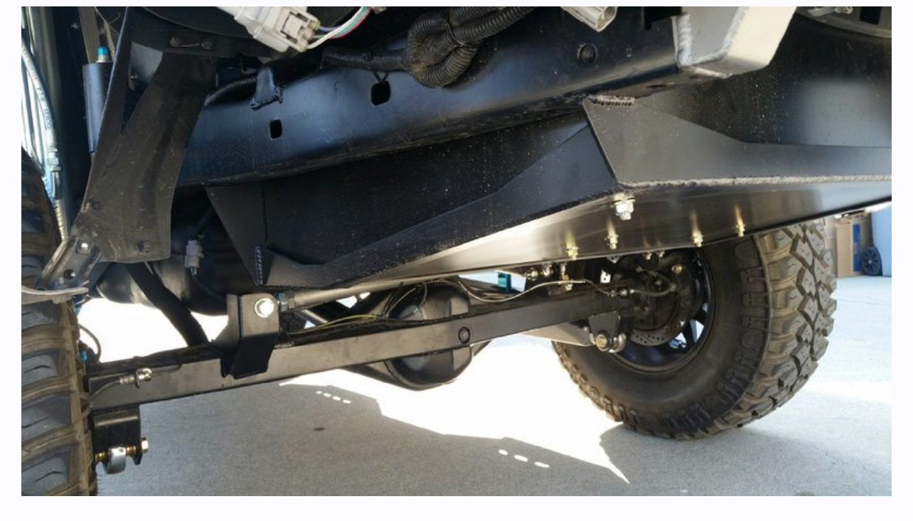

    Has anyone trussed a stock axle? I have searched and only saw 1 person that did it not on TW.

    I believe that Dirt Designs includes a truss with their 3 link kit, not sure if they would sell it separately?

    Are you just building your own? I guess I am more wondering if bending the rear axle is a possibility on these.
    My use case is going 60-70 on logging roads that sometimes have some pretty deep holes and or jumps in them. Fully loaded ~1000lbs for a weekend of camping and fishing.

    Those back trusses are interesting, I would think youd want the strength in the other direction mostly.

    I bought a truss kit from Ballistic Fab to 4 link the rear. I haven’t bent it yet but I am trussing it so I won’t have to worry about that happening.

    I did the Ruff Stuff truss on a clean axle, with the whole weld here, weld there, cool down, repeat method. The axle was so bent the truck wasn't drivable and wore out a brand new set of tires in 1500 miles. I did another with just a small truss where my original axle cracked. This time I fully assembled the housing on the bench and only welded 1-2" at a time with full cool down. I don't think this one bent. Never again will I do a full truss on a housing.

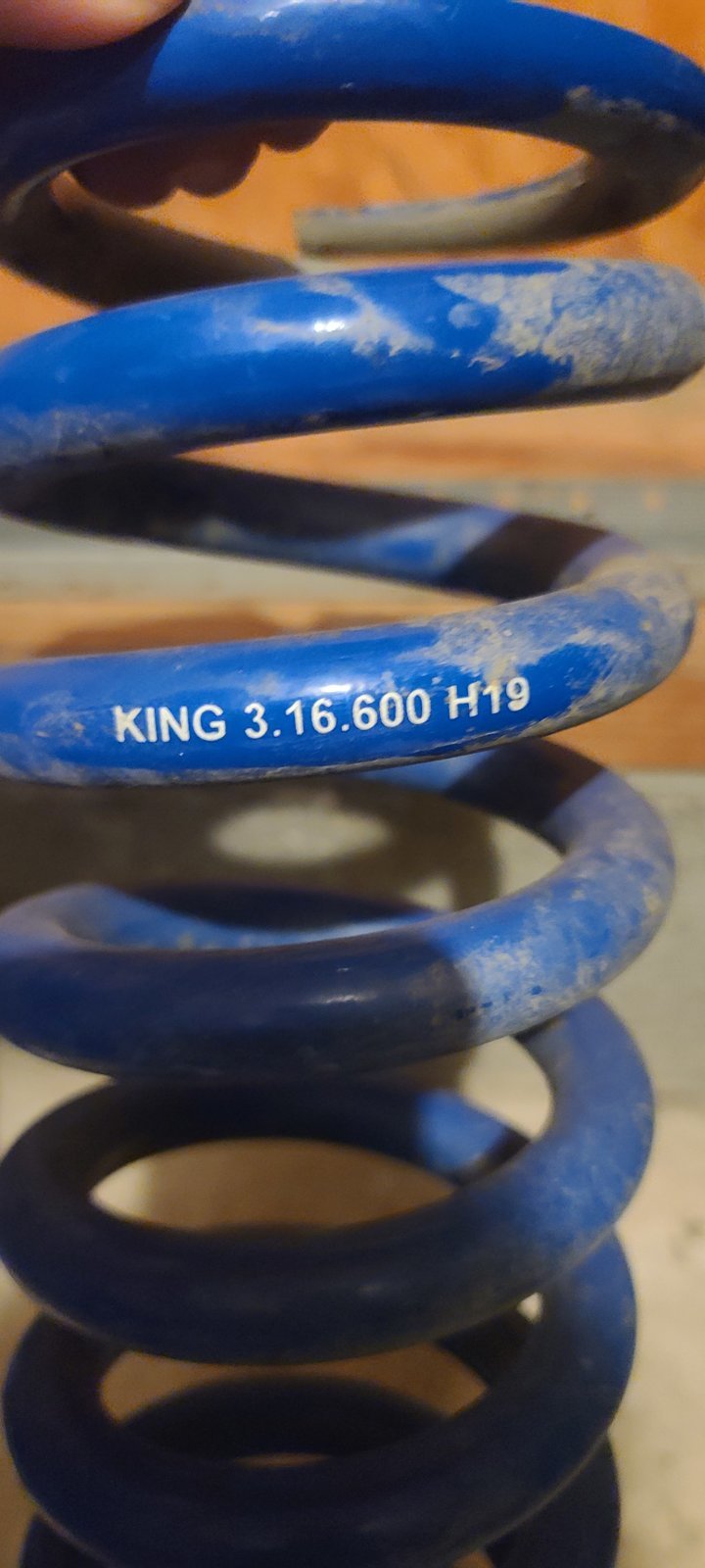

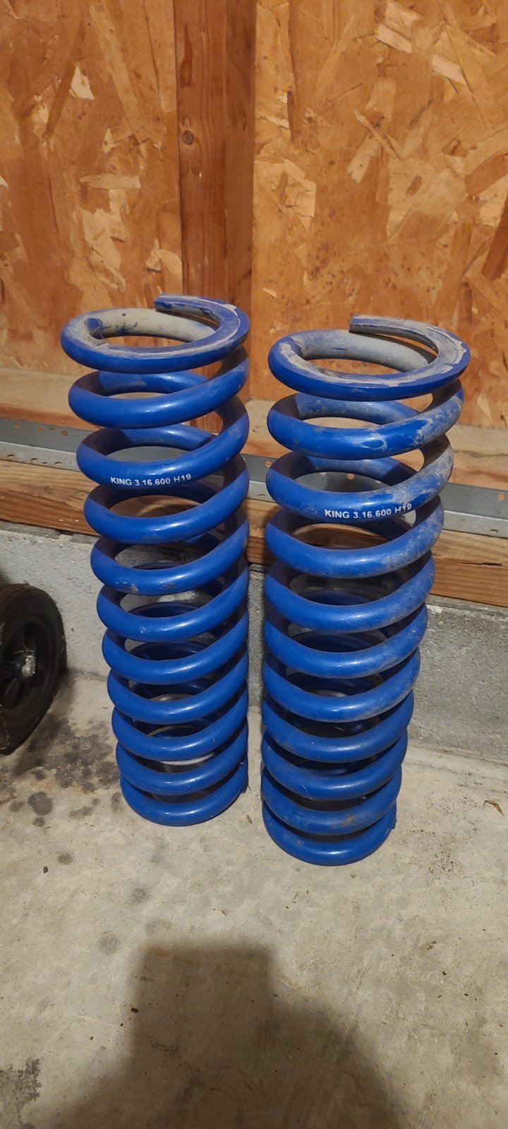

    @YotaFAB I have 16" 600# coils if you want em. Just pay shipping. They're collecting dust.
