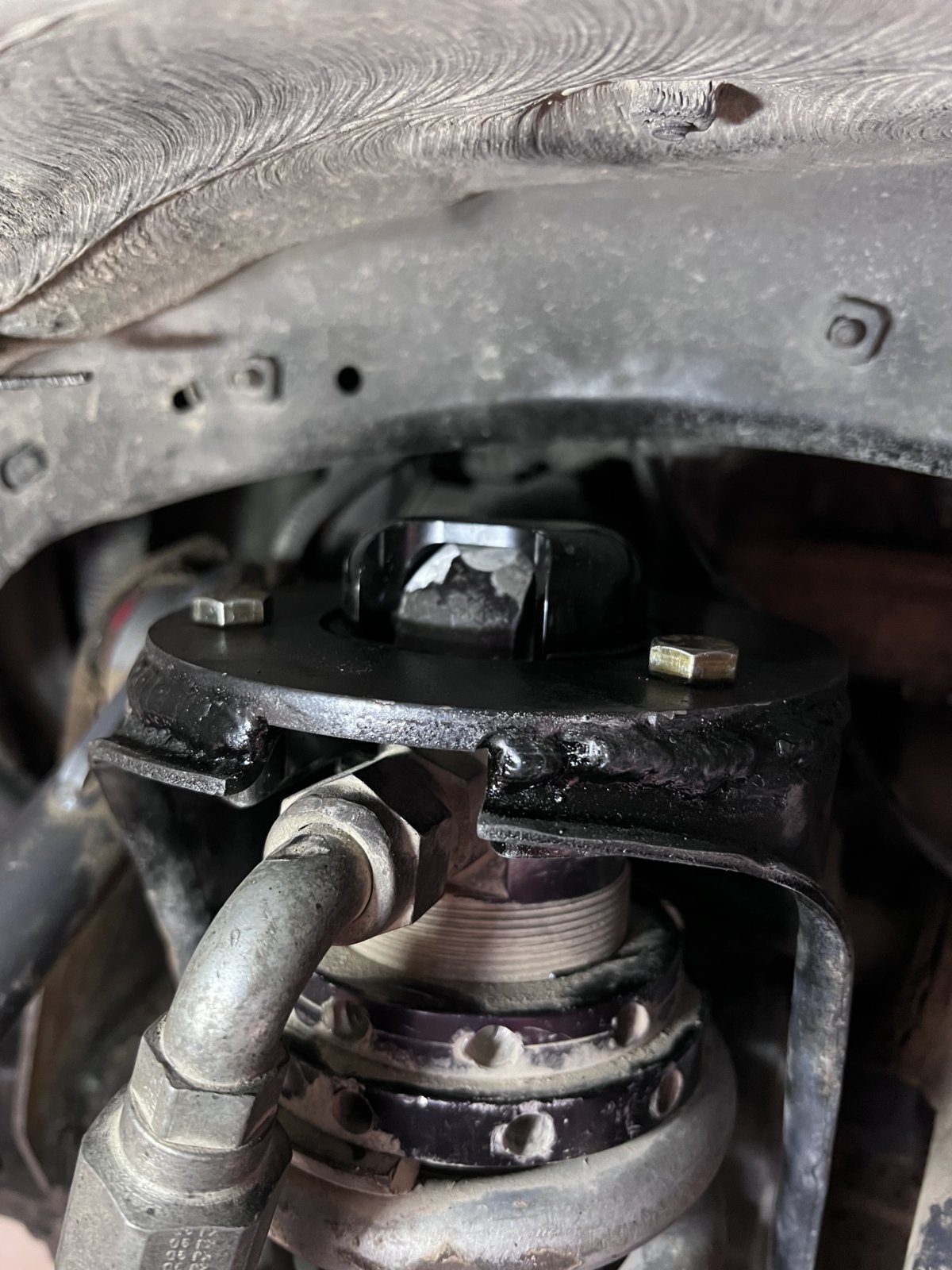

    I just repaired my buddys today his broke at the top hat. Replaced with the “new style” $65 top hat they have with a brige on top. Doesnf look all that much stronger.

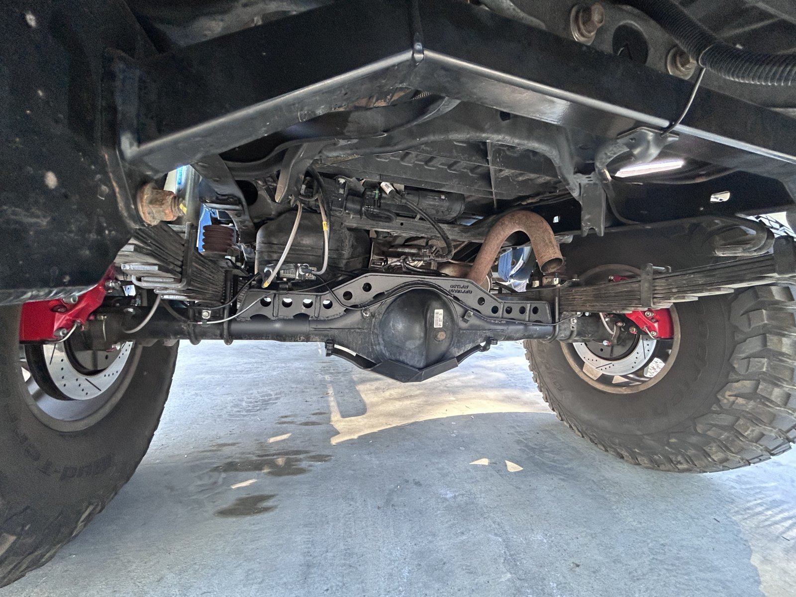

    Going to all that work to 3-link it, disc conversion and truss it why not start with a wider housing, so you did not have to run the spacers?

    Because $6k+

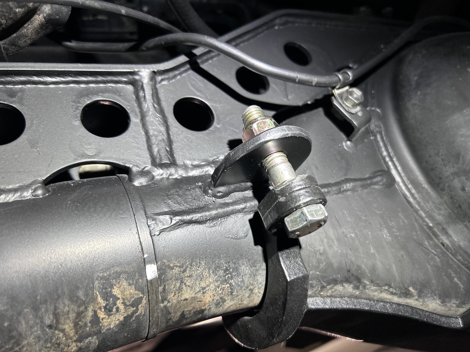

    How'd you get the diff guard clamped? Welded the upper tabs directly to the axle?

    for me the answer is keeping ABS since it’s my daily.
    i did find someone that makes Fab’d housing’s with the oe flanges & bearings & extended oe axles so you can retain abs but yeah your spending $5k to accomplish the same thing as a set of spacers …

    yes they’re welded on both sides, as the ones that came with the BAMF diff would interfere with the truss.

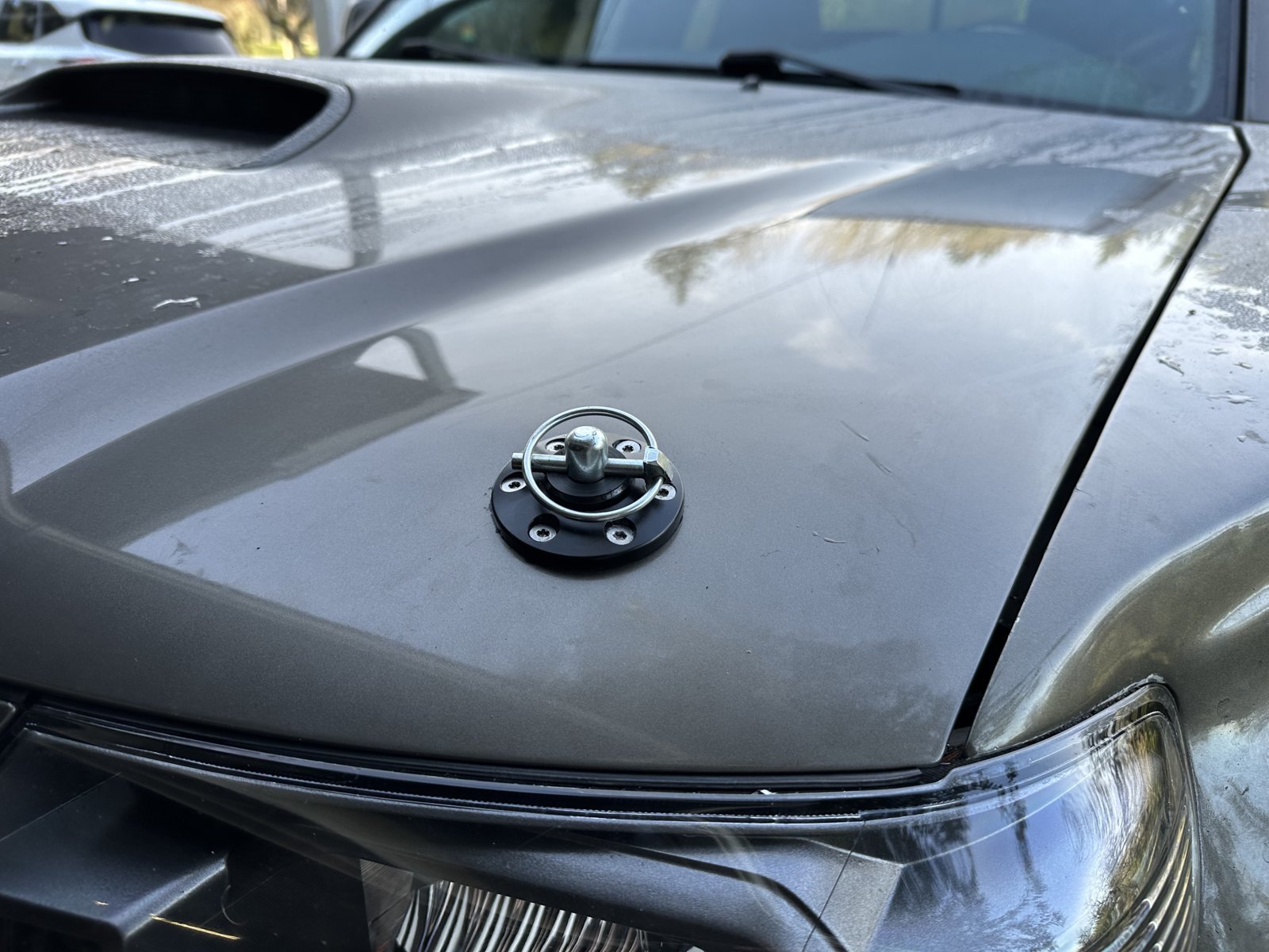

    Installing hood pins to eliminate some flutter. What a fucking pain in the ass.
