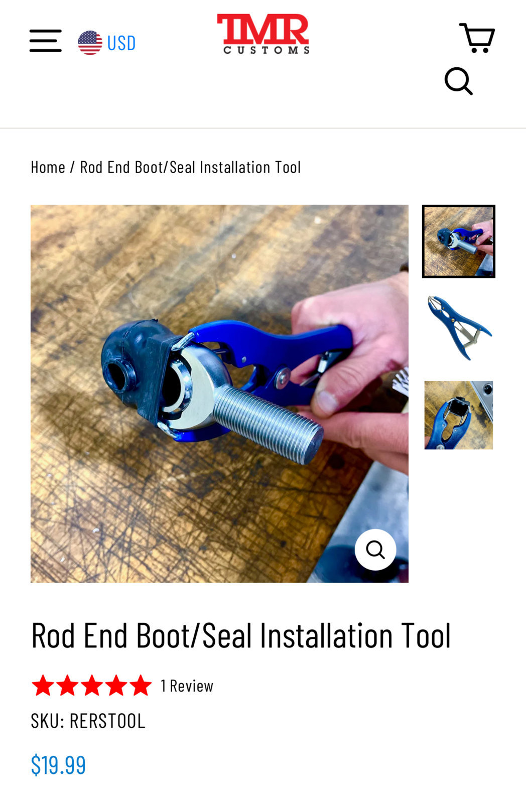

    Anyone ever see something like this?

    Someone commented in here not that long ago that they were running heim boots.

    I got heim boots, live in the Pnw and kinda daily drive mine. I’ve only put them on my panhard so far and they seem to keep all the water out and there’s no corrosion on them yet. I’ll do the rest of my links when they wear out since I don’t wanna tear my junk apart right now haha.

    Has anybody tried to just let them sit in some almost boiling water for a few minutes?

    My 7/8” ones weren’t bad at all, 1.25s like in the pic may need some ky jelly

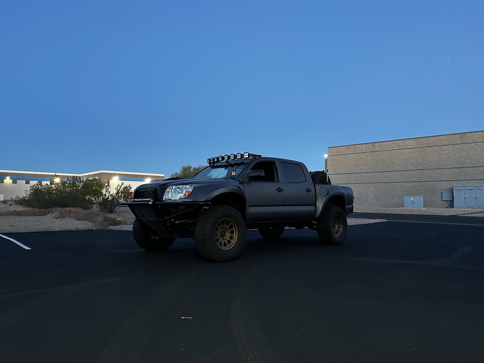

    All done and headed to 454 Motorsports for axle truss, coolant hardlines, and some other small stuff. Shoukd have it back by the 1st or 2nd week of January, we’ll see. They’ve been pretty busy recently it sounds like.

    Me! And they are a total bitch to put on. But very much worth it. 2 seasons on my steering heims and zero play or noise to speak of.

    I used those to add boots when I replaced the heims in my JD steering after killing them in a year, made the install very easy, would recommend.

    I used to use boots on buggies and it would really shorten the life of the joint...
    But I did a lot of mud/water... Because east coast :annoyed:
    Maybe it works better in drier conditions?

    Im in about as wet of conditions as possible. I used one size smaller than I was supposed to and pumped some grease in them. The proper sized ones weren’t very snug.

    Mine couldn't have lasted any shorter lol, so thought I would give them a go. I can't get more than a few months to a year out of a heimed joint anywhere on the truck, uniball UCAs in the front I actually get a few years out of though. I finally swapped all my link joints to Ballistics, I was so tired of throwing money and time down the drain on swapping joints, the steering are the only heims I have left on the truck. This is in Colorado, while not sloppy mud all the time, I do see a fair amount of water.

    Run one size small on the boots. They are a total bugger to get on but seal super tight. “Proper” sized will surely allow water and dirt to enter.
