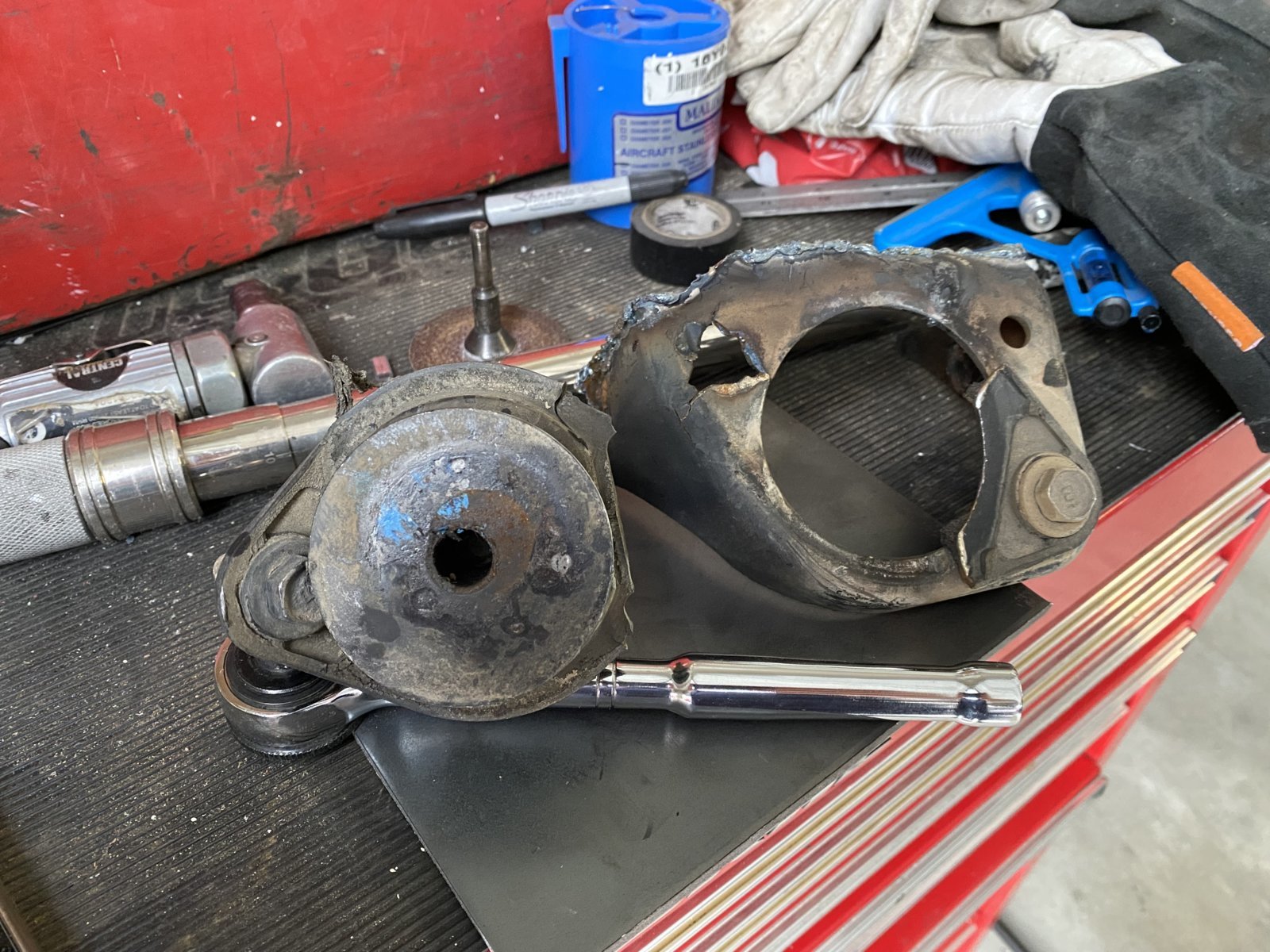

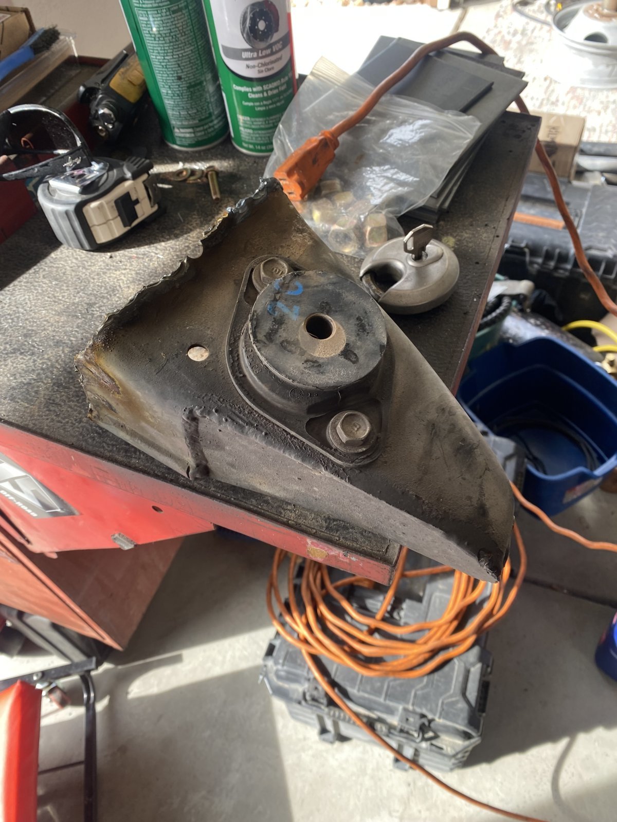

    This happened on my last outing to Ocotillo wells. Rear passenger body mount. Just gonna fab up a new one.

  12. Dec 27, 2023 at 4:45 PM

    #184774

    That body mount is still mint. I bet that sounded violent.

  13. Dec 27, 2023 at 4:50 PM

    is your cab metal torn at the pinch weld / rear door upper back corner ?

  14. Dec 27, 2023 at 5:08 PM

    Yup on both sides and I’m planning on making them worse by solid mounting the cab to the cage and eliminating the rubber body mounts with solid steel pucks.

  15. Dec 27, 2023 at 6:33 PM

    nah that along with your new cage will solve all that wiggle jiggle crap

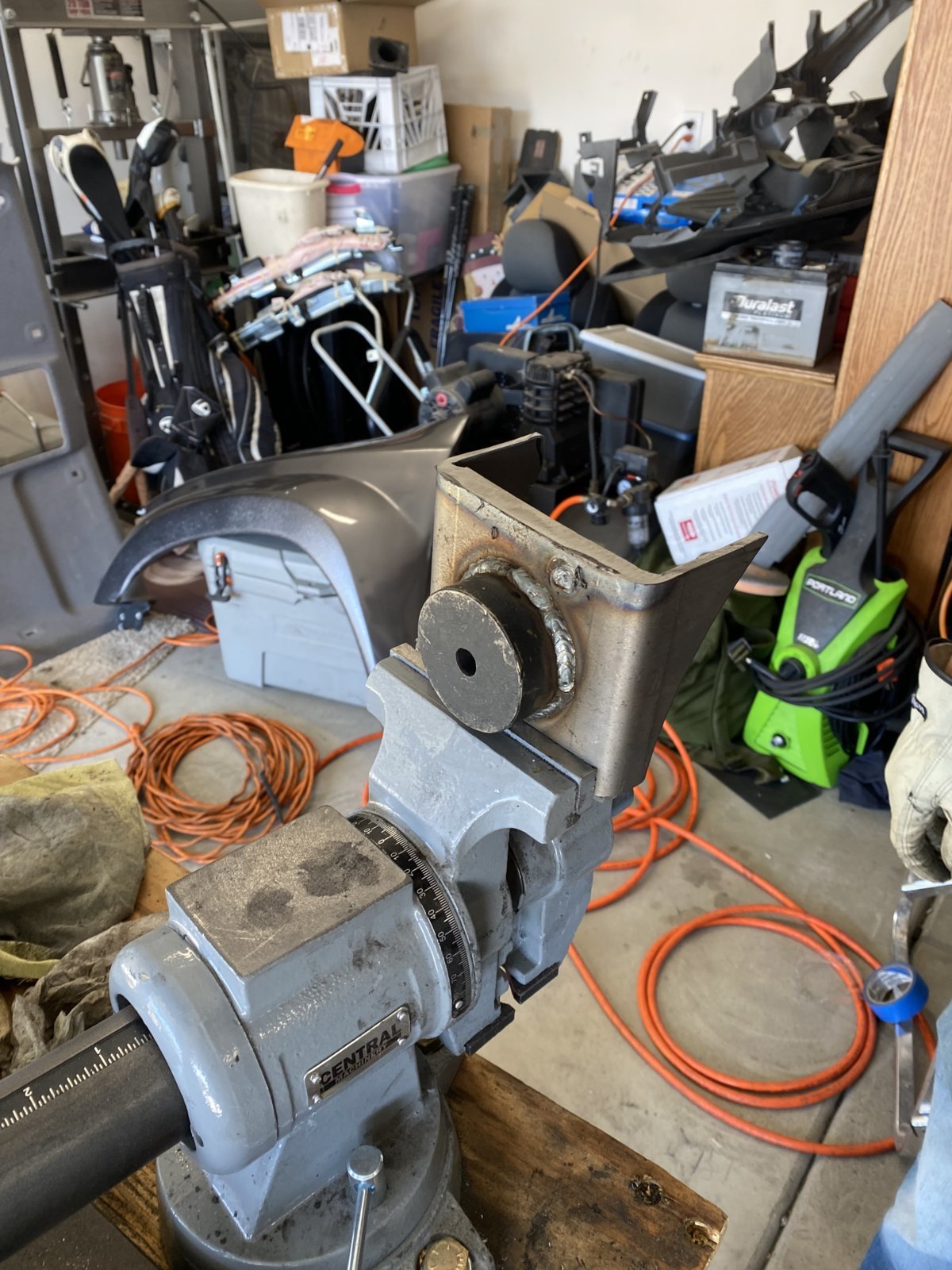

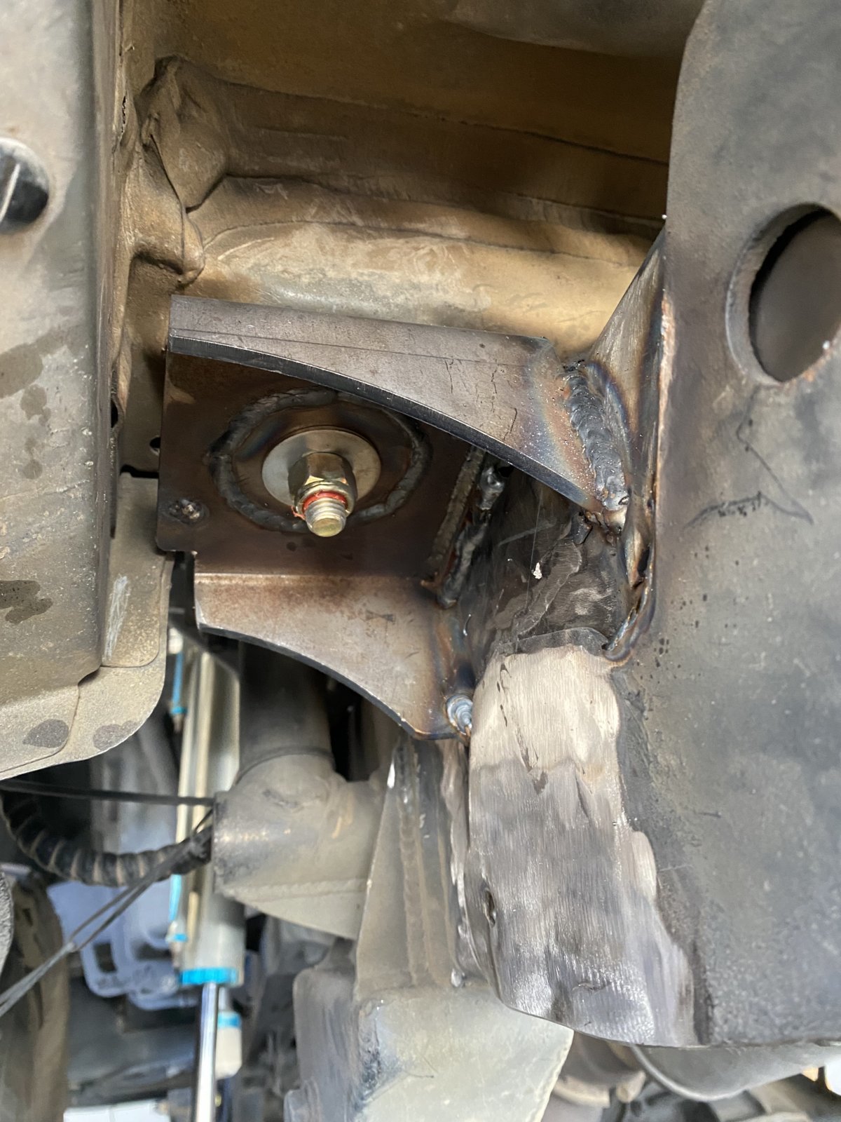

    New mount with a solid puck. Gonna weld it in in a few.

    Good enough!

    dwphoto

    Airdog[QUOTED] likes this.
