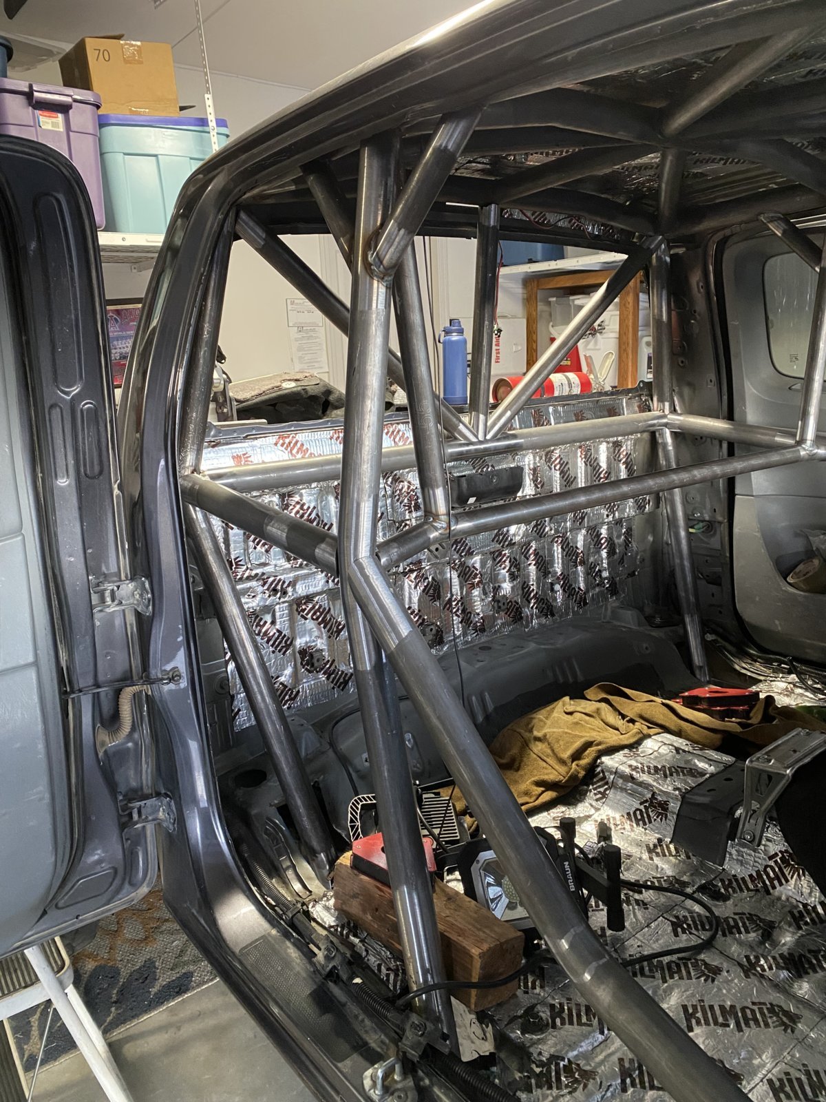

    Making progress. Cage is fully welded up top.

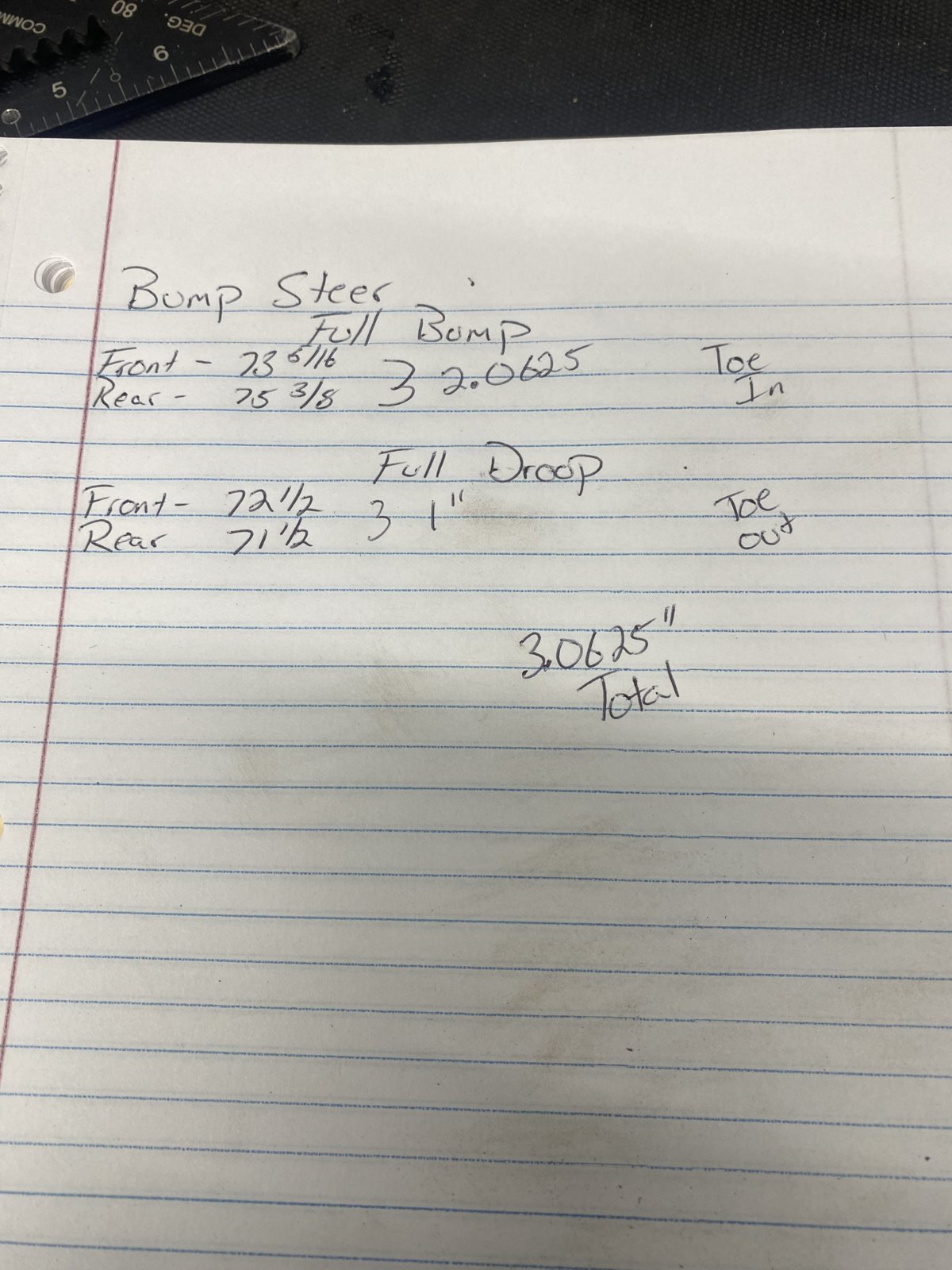

    In other news. Getting some baseline numbers for the new steering setup and all I can say is wow.
    I now know why the truck would steer its self if I came down hard on one side.
    Currently have it down to about 1/2”. Going to see if I can get it even better.
