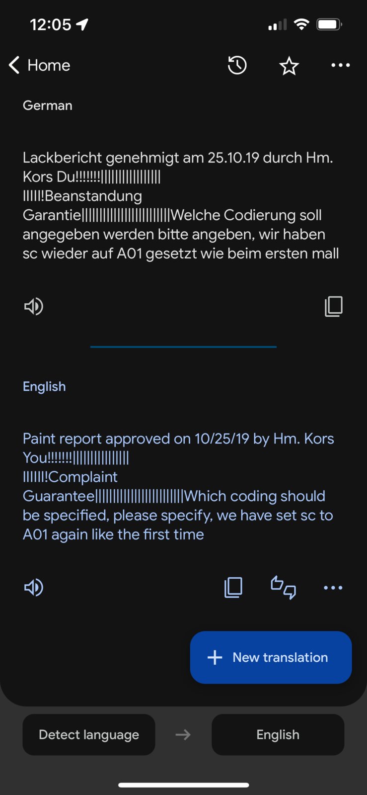

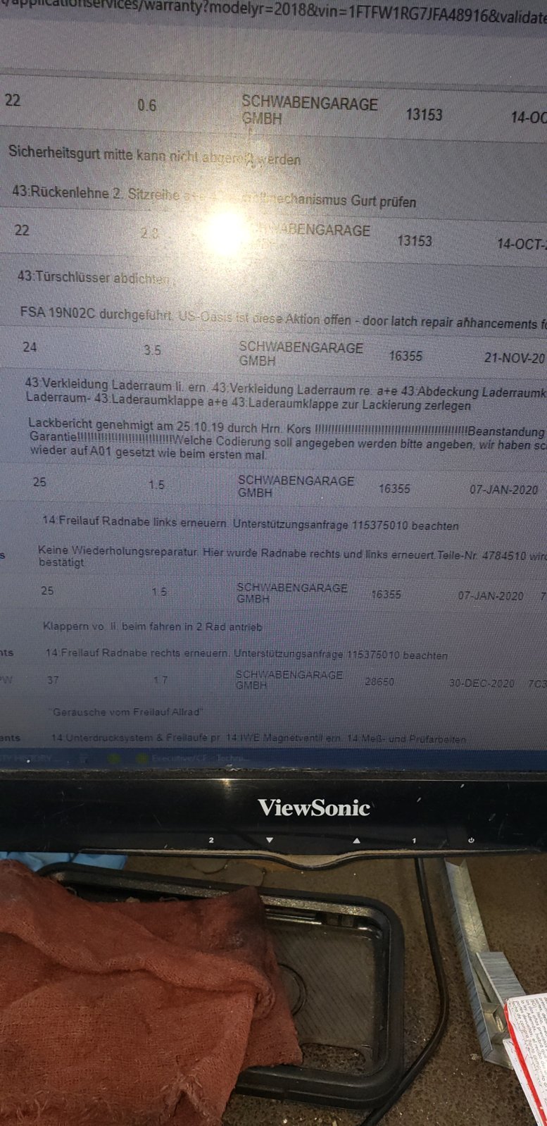

    The Black RaptorR is a buy back with just 1900 on the OD
    The Red Raptor is a buy back from Germany, all warranty history in German..

    I'm very curious as to what happened here, that's a lot of exclamation points.

    Lame, something about paint.

    Good question, ill try and Google translate it later. In the mean time, its getting a fresh long block and maybe turbos too

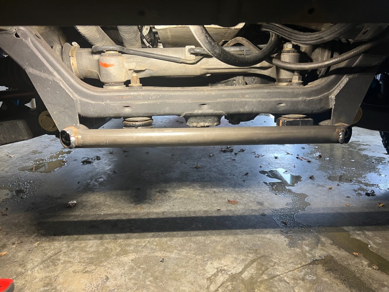

    Finally threw a new lca cross bar in that I bent last koh just in time to probably bend it again at this koh….lmao. Still need to get my forward bars done but getting closer to finishing koh prep.
