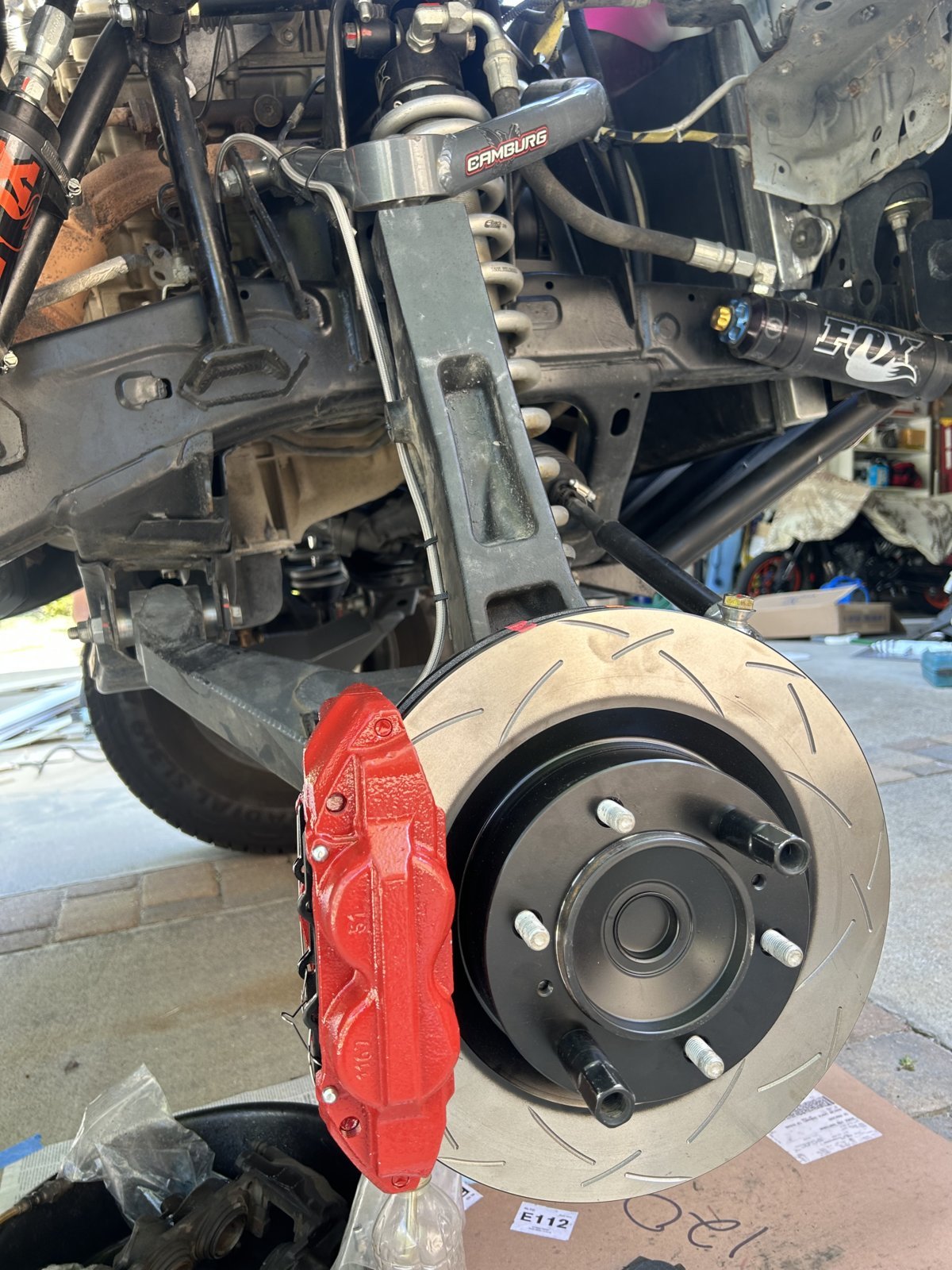

    Anyone have a good pic of their front brake line setup? With the hydros I installed, I’m worried about the lines rubbing on them.

    This is what I did; hydros and bypasses in there but not pictured.
    SS line from HEL, this is in place of both the oem hard lines at the caliper and frame. not just the rubber soft line.

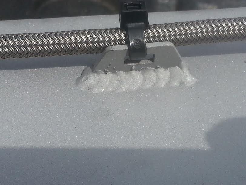

    I added these to my UCA

    I don’t weld (yet) :anonymous: and didn’t want to re coat my UCAs :(.
    I do like that though. You get those tabs from kartec or somewhere ?

    Thanks, so banjo at the caliper and then directly to the 90 at the frame?

    Kartech
