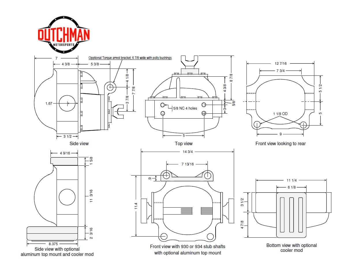

    it's about the same dimensions as the other options. Same width, slightly taller because it has the lower mounts built in. close to the same depth. Quite a lot lighter, its only 20lbs. Curious why you think it's so big

    It's actually almost exactly the same.
    Spidertrax standard width:
    Dutchman:

    Local guy has one in a car around here and it looks absolutely massive. First time I looked at it I wasn’t even sure what I was looking at. With the 3rd member in it, it’s girthy. I don’t see the dimensions on the spidertrax depth so that may be the difference.

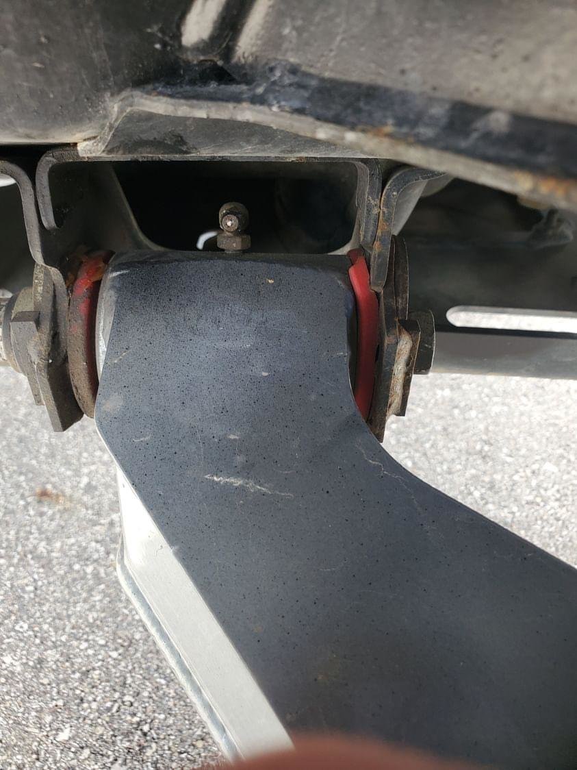

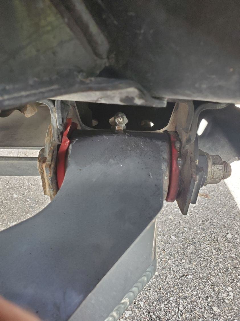

    Anyone experienced this before? Truck chewed up another set of bushings....
    Has taken no big hits, had a shop do the install and they went in without a fuss. Both fwd face of the aft mount shredded, with a large gap on the aft/aft bushing.
    Alignment?

    Poly bushings suck. Have some delrin bushings made up.

    Where are your alignment cams - all out / all in / centered - crossed up alignment cams (rear all out, front all in) will do that regardless of what you use and should be corrected at the alignment instead of brute force of strength of material.

    Rear pivot eats the vast majority of forces. I don’t care what anybody says. Uniball or delrin. No other option. Uniball, is ideal. Poly simply cannot endure these forces, especially with a small diameter bushing. That “axle” or “pin” is constantly pinching the poly between the sleeve. They literally disintegrate. His issue ain’t alignment.

    The further off from parallel to the frame, the higher amount of wear will occur at a faster rate. I’ve seen poly bushings last a long time especially if not in road salt and other corrosive environments and a good alignment but if you have a more durable material things will of course last longer. Uniball wouldn’t be wonderful in a corrosive environment. A buddy is trying out the TMR lifetime rod ends for his steering - could be an interesting thing if it lasts longer. I believe you said you’ve been running a smaller size heim boot and seeing more life result.

    100% this is the setup, and the issue is like exacerbated by my dailying of the truck in a harsh Canadian climate. Will replace and use a less aggressive alignment.

    Can confirm I had the same issues going through Poly LCA bushings at a high rate when I had the alignment crossed up like that.
