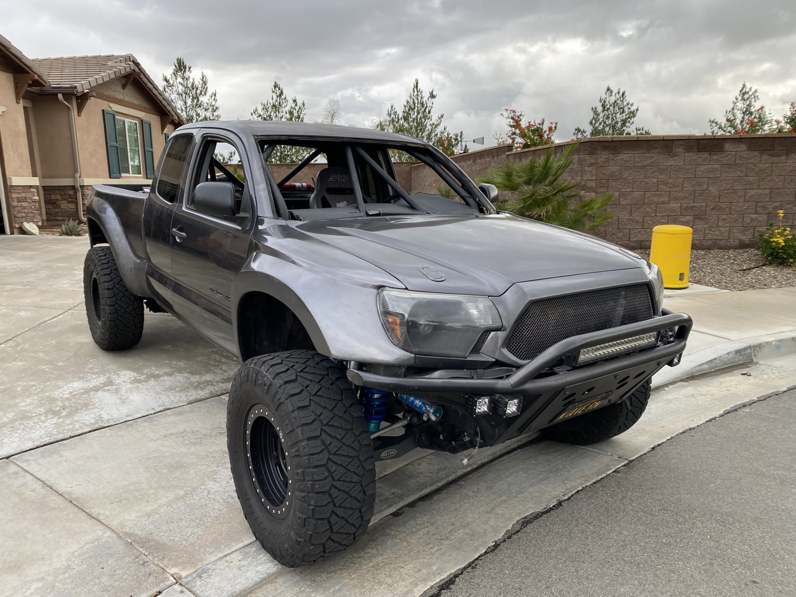

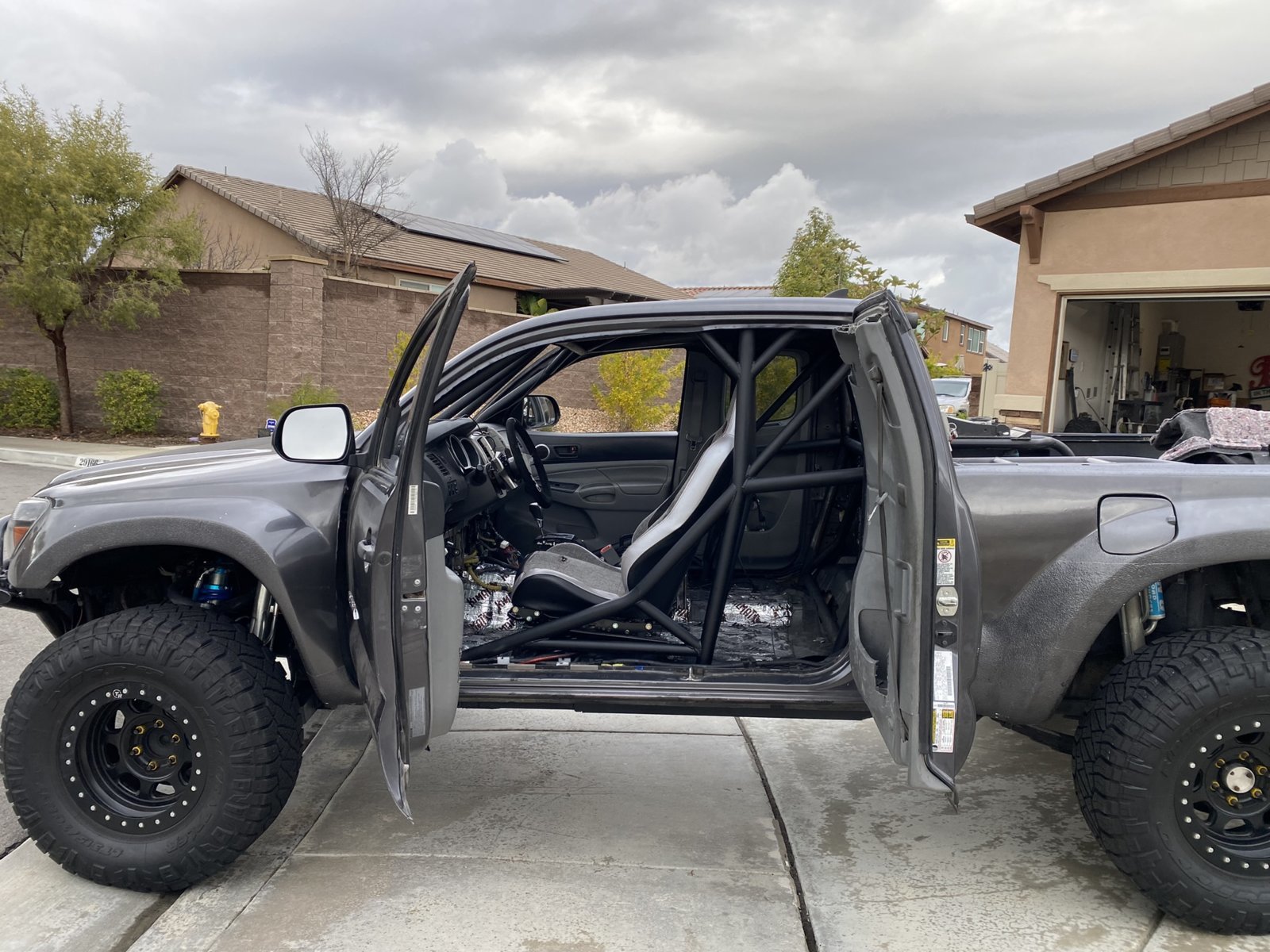

    https://www.tacomaworld.com/threads/airdogs-2012-prerunner-access-cab-slow-build.264263/
    Well the good news it is it started up and no new idiot lights....so I guess we didnt burn anything up! Few more things to do but the hard part is over with.
