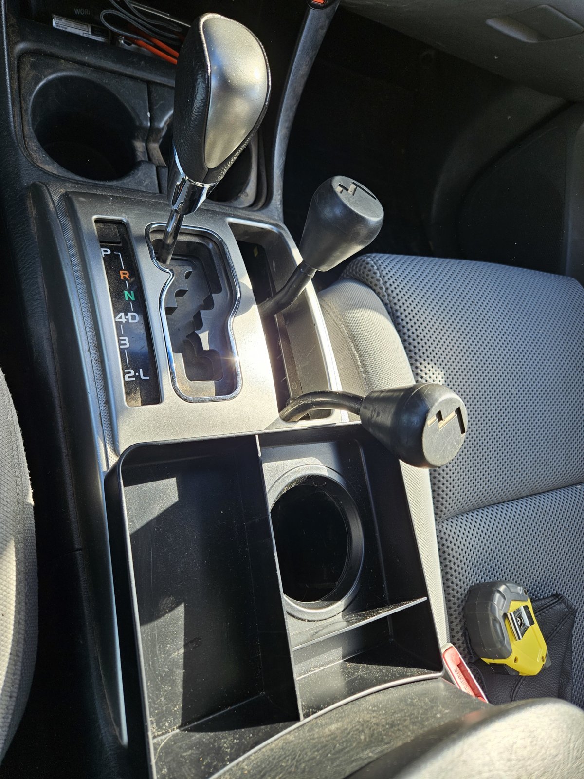

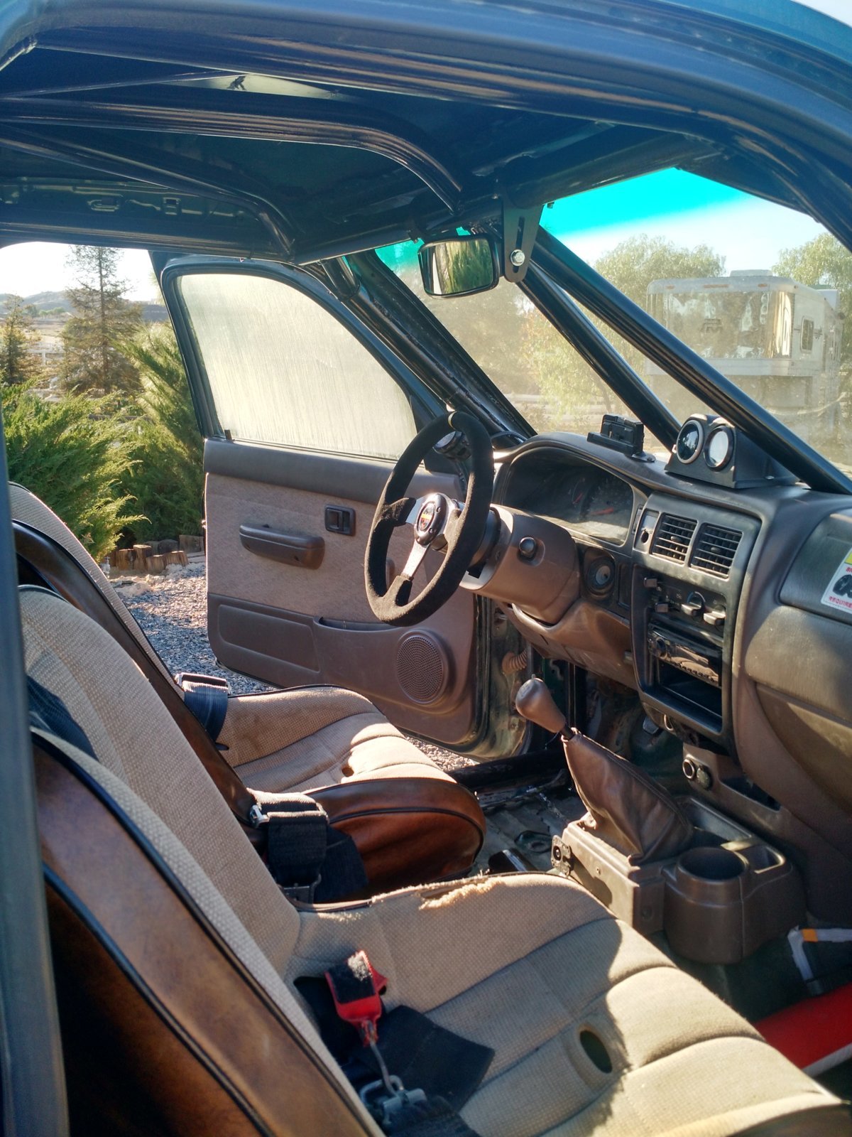

    What is your transfer case setup? Got pics?

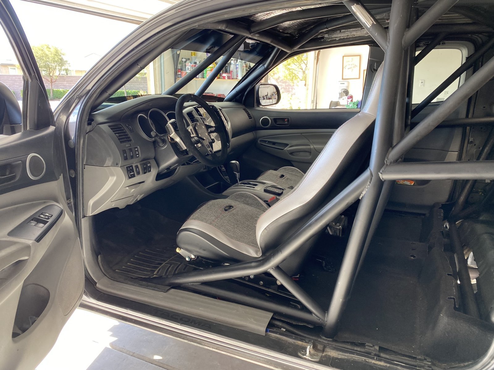

    Yea I have the same ideas. No need to race. Just not to die.
    Any plans on doing some kind of headliner? Or just leave it bare?
    My driver side carpet was cut out over a year ago while chasing a water leak (still havent found it...). I'm thinking of putting in astro turf once I have the cage in.

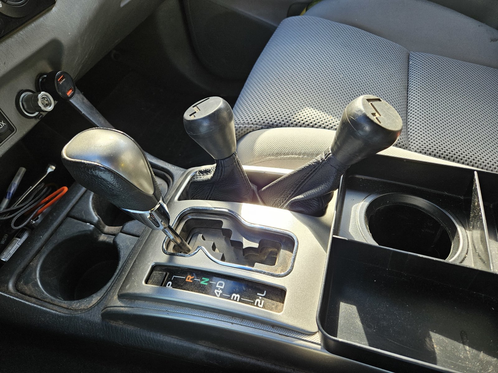

    Just an FJ case converted to twin stick. Nothing special.

    Tell me about the storage bin behind the shifters just in front of the arm rest.

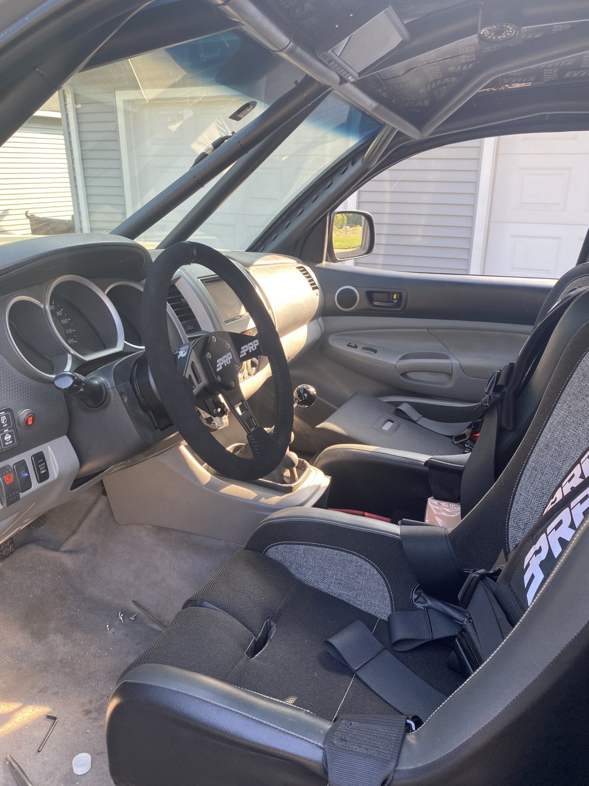

    Have you guys done or seen fill plate along the roof section between the tubing? I miss having a headliner to block out the summer heat. I have kilmat already. Think basikbiker did Aluminum, but plastic might insulate better and be a bit more quiet.

    Morgan Clark did a video about this and RJ Fab has at least one video on it too - plastic would be easier to make fit the curves of a roofline for anyone without metal shaping experience and tools.

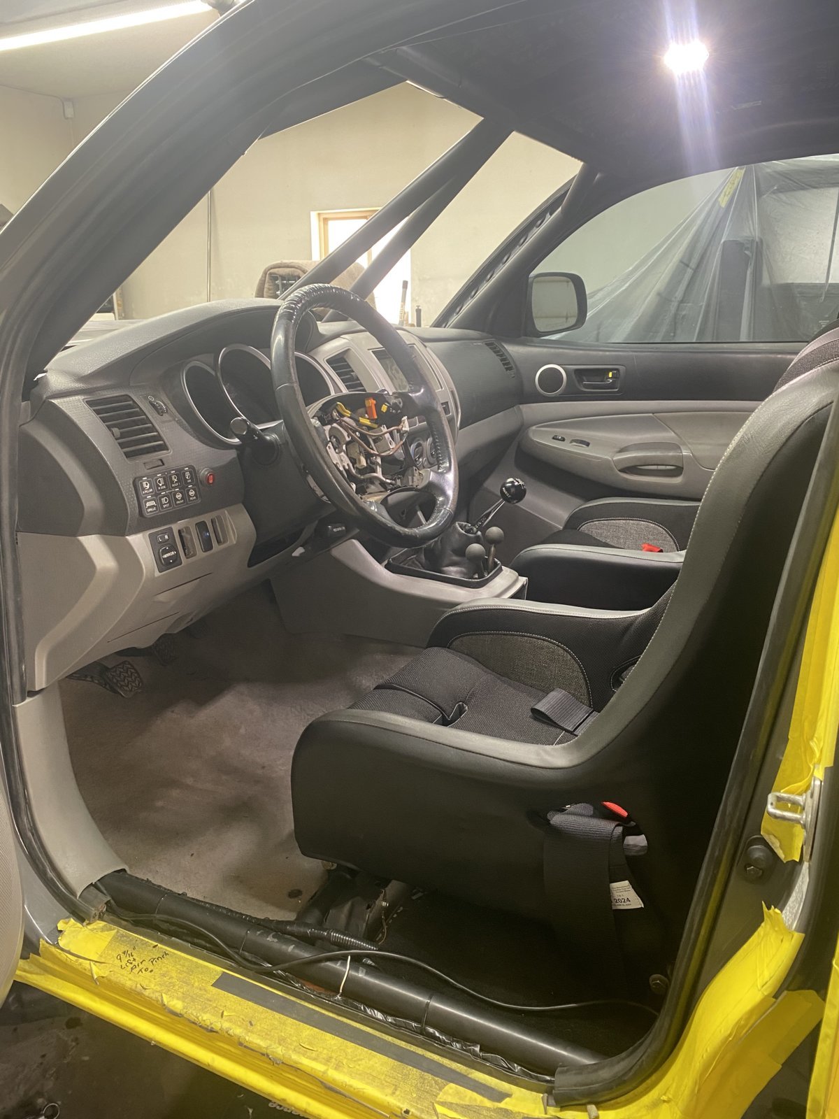

    The easiest DIY would be to weld on trick tabs to use as mounting points ie: 3 tabs in each triangle of your cage and then have individual fill panels between each tube mounted with nice hardware ie: fender washers & counter sunk allens. You could have better insulation / heat control behind each panel
    Contouring or bending plastic would not be fun, aluminum would be much easier.
    Another method is to glue layers of foam directly to the roof and then glue upholstery directly to that. You start with a thicker light open cell foam then finish with thinner closed cell foam which you can actually block sand to smooth out and shape.

    IC. It's a brand of insulated filling. I'll look for it, but I bet I'll need to look for an equivalent.
    The individual panels sound like my best option. I'll do a double check to see if I need to do a bend. My only bends are right at the a pillar and windshield crossbar. It definitely would be a bear to bend plastic nicely. I was just afraid of aluminum in case it rattles like hell at certain engine frequencies. Guess I could kilmat it too if I get some horrible vibes.
    Edit: crap, probably need to make a bend.
    Guess it's aluminum.

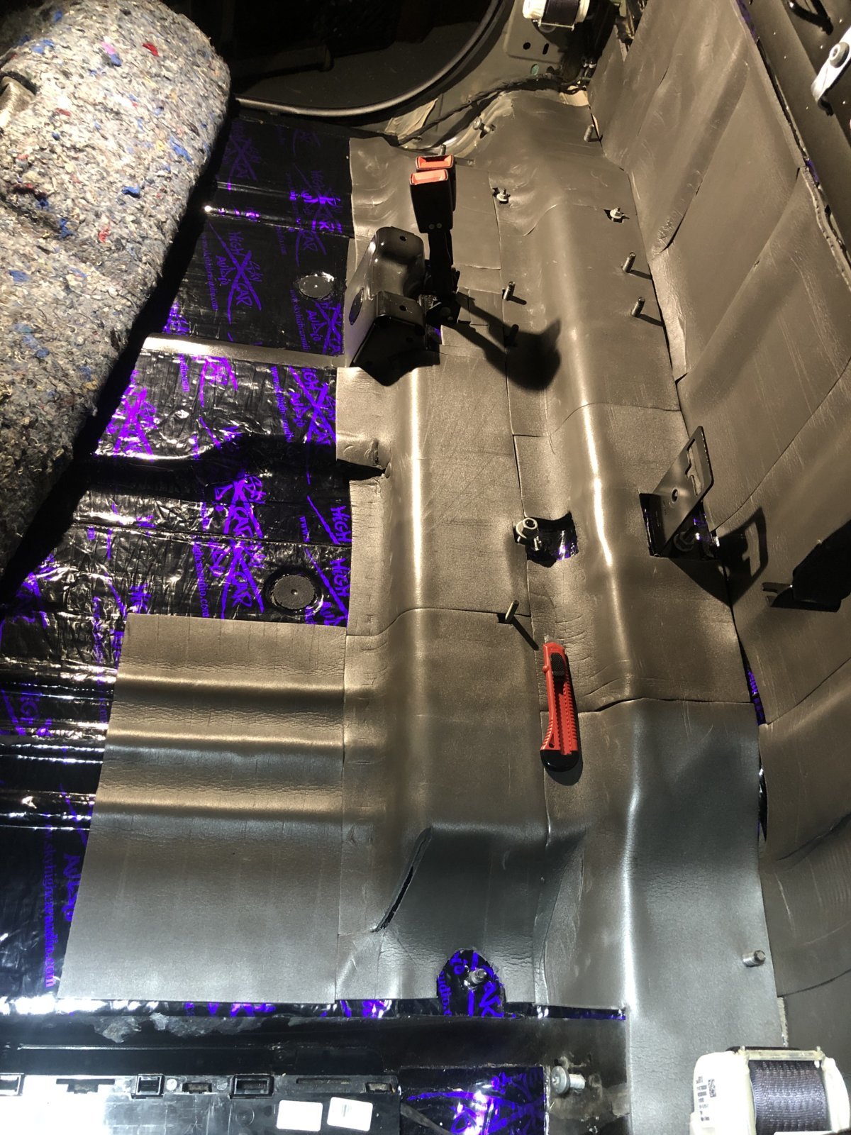

    I did my whole cab with normal butyl/foil backed then put closed cell butyl backed over it. Very similar to what you posted.
