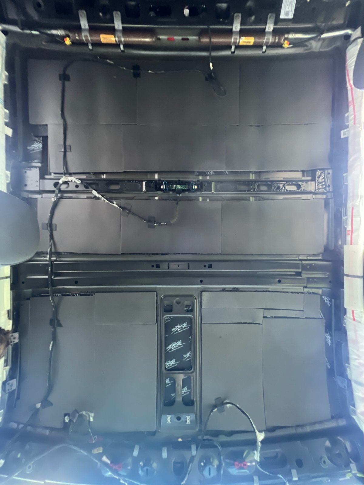

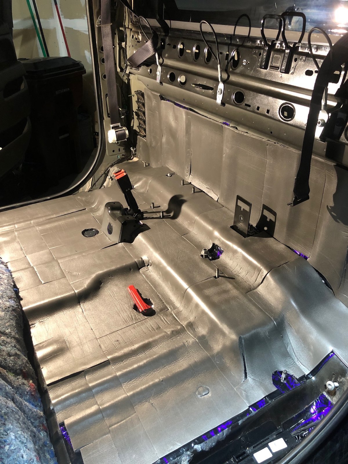

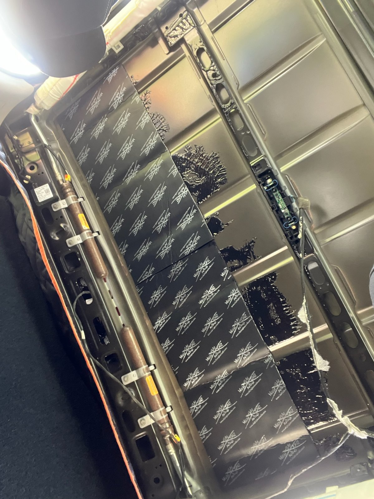

    I’d say similar but not the same
    I have closed cell non stick sheet on the back wall of the truck and doors that I had started with
    Took it all out cause the improvement of sound and thermal wasn’t that good.
    Noico red foam is legit like a squishy styrofoam type material and you can buy it in a thin or thick mil and they recommend you seam tape all of the sheets after placement for “best” condition.
    Where’s the closed cell stuff is usually stiff and ridged by comparison;
    the noico is also extremely light
    So it didn’t actually add any weight unlike the closed cell sheets I had in the doors and back wall.
    I appreciate and applaud all the sound deadener anyone does to their car cause loud cars suck;
    But as a comparison
    My Silverado makes 506 to the wheel and even on the highway at 90
    I can whisper in my truck
    the comparison in sound between my taco and my Silverado when referring to sound deadener
    My Silverado is way quieter because I had not added any noico red to the taco, instead it still had the closed cell sheets and when I tossed those out for cage prep it was 35lbs of material removed whereas enough boxes of noico to lay down two layers wouldn’t even get near 5lbs for the whole cab
    ideally when/if the Silverado is ever caged I left all that material off of the body panels that get cut out so, theoretically I could actually make the Silverado quieter if I hadn’t left all those voids
    even my ceiling is two layers

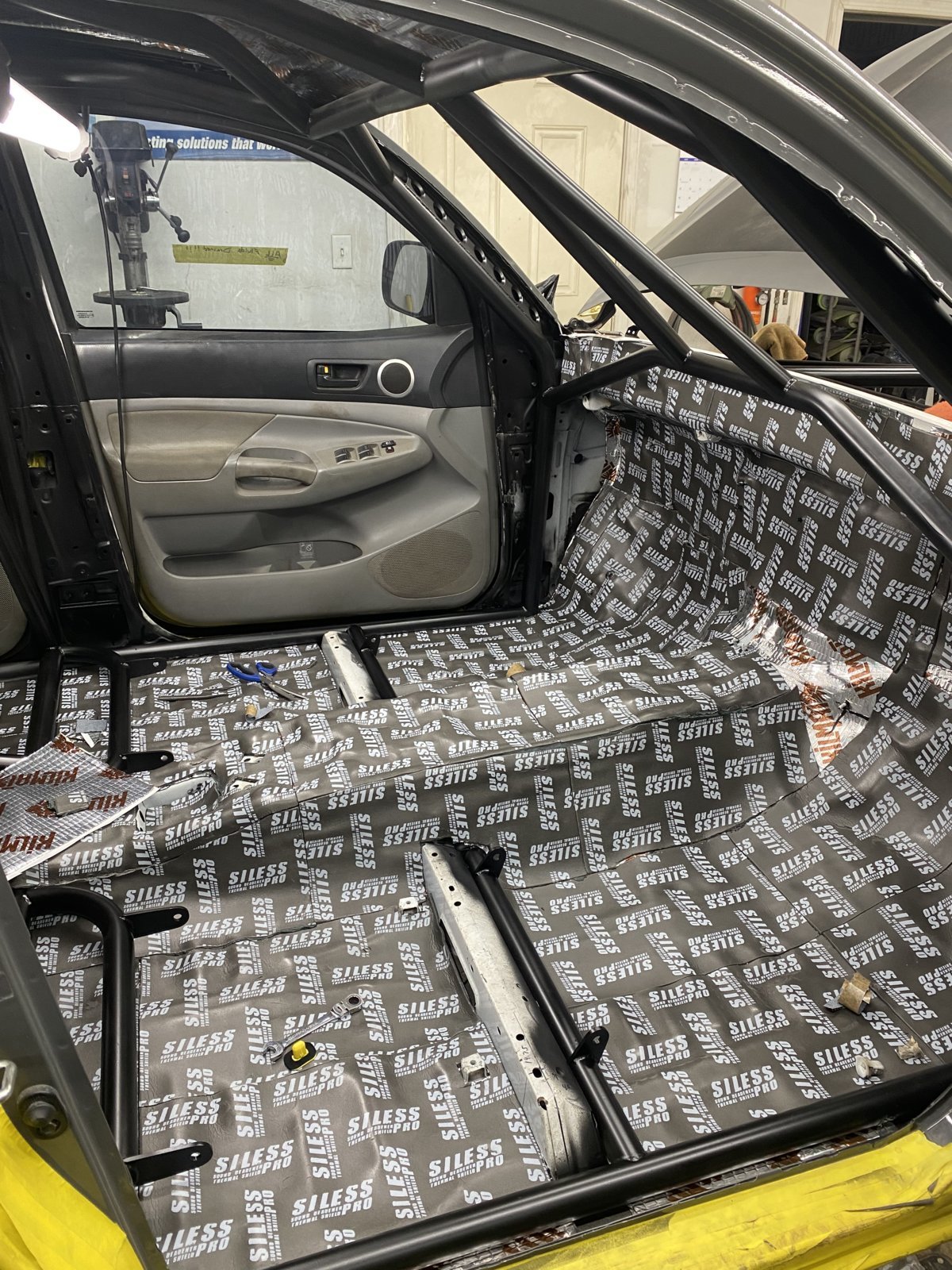

    I have used both noico red and this siless. I say it’s the same, because well. It’s the same. Absolutely nothing rigid about this stuff. It’s a soft foam with a butyl backing.

    So you aren’t referring to the MLV style foam that most dudes buy?
    (I was thinking you were talking about the same material that comes OEM in most cars )
    Edit:noico also has zero asphalt/butyl only a thin layer of glue/tac

    I have a case of Silles and a case of the noico, they are totally the same, the noico just has color in the adhesive

    Oh so that’s not a typo
    That’s a brand name? Lmao
    I did NOT know
    no asphalt tho
    Just that thin ass glue
