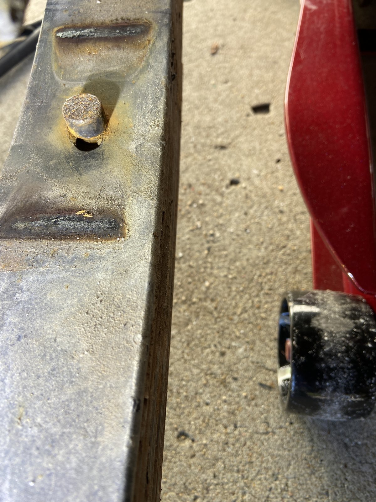

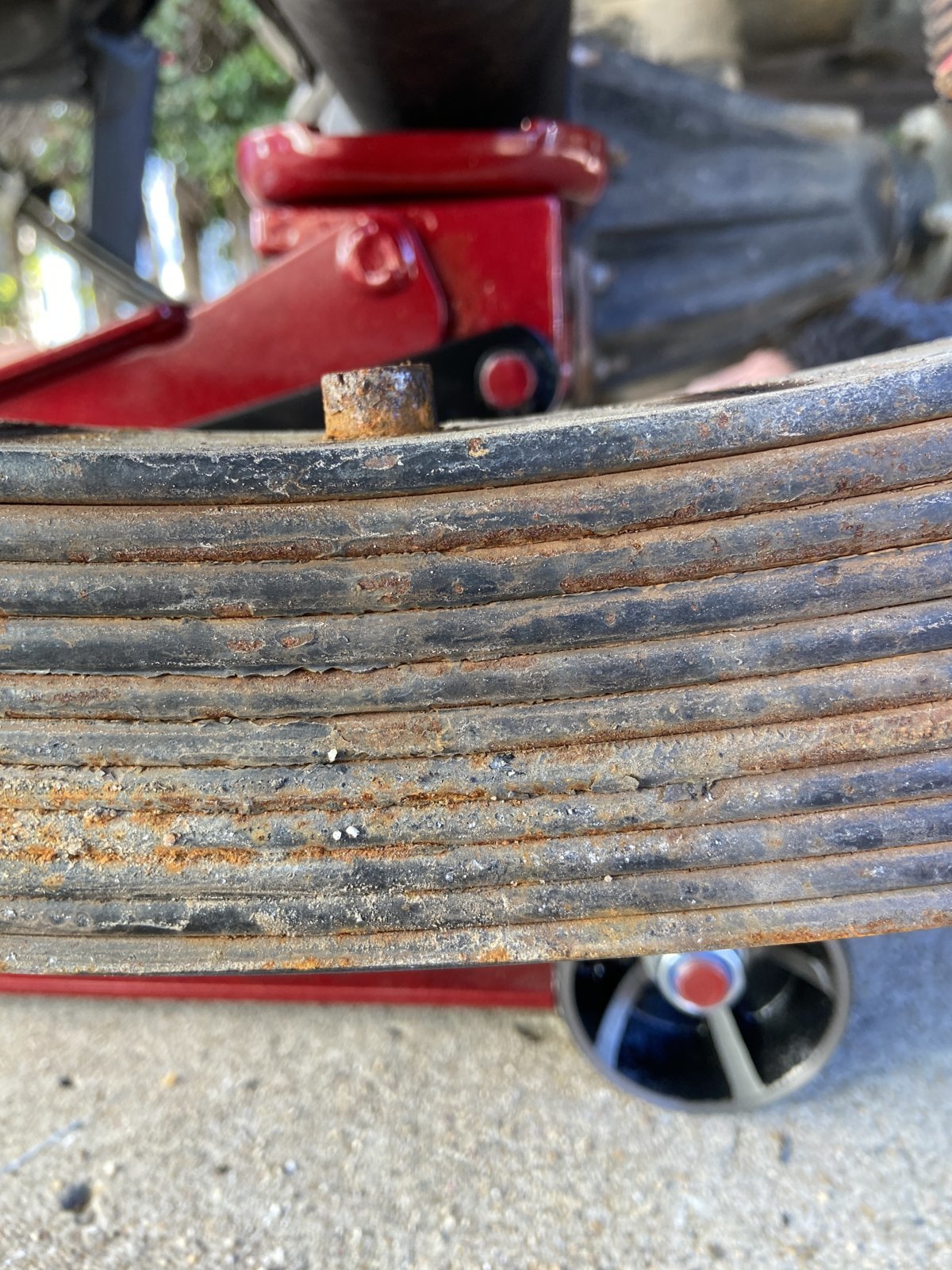

    Leaf pins are ok, Seems that I have a warped brake drum, really bad spot that you cant turn by hand, once the drum is off it is super easy by hand to spin the axle/drive train. I backed off the shoe adjustment where there was no rubbing and took it for a drive. yes I need an alignment, badly, but its not nearly as bad above 50mph, but still have some issues to find , rather fix.

    Are the leafspring bushing sleeves installed? ....Just trying to help check off the list of things to inspect and check off.

    yes I assume so, JD fab did the install in Apr last year. all associated bolts are tight. I guess I need to drop the leafs out to verify.

    That's just one of those things that needs to be done to check items off of the list. Check the integrity of the leaf spring bushings and sleeves. Might as will check the condition of the rear shackles and the upper unibals.. if you remove the leaf springs for inspection.

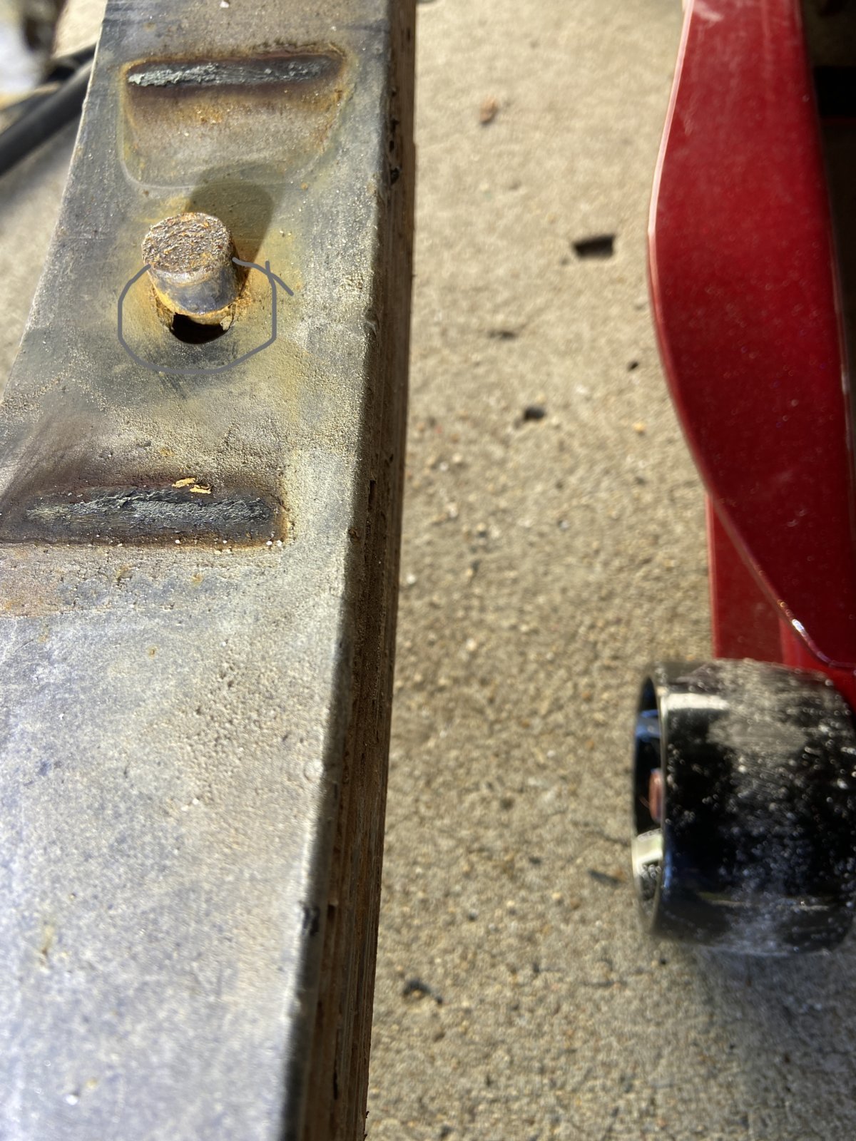

    I might be wrong. But is that not a rust ring from where the centering pin used to sit?

    no, I checked with the purge and the edge marks seem to be in the right spot.

    Seems to be and is are two totally different things…. It sure looks to me as though that pin moved. No other reason that ring should be there.

    So hammer that pin as close to center of that slot and re-assemble?

    I'll check out my leaf packs tonight since they are not installed yet and post a pic or two for reference

    I would 100% be removing and replacing the pin. They are like 3$ a piece.

    any idea what size that pin is?
    Never mind, 7/16s
