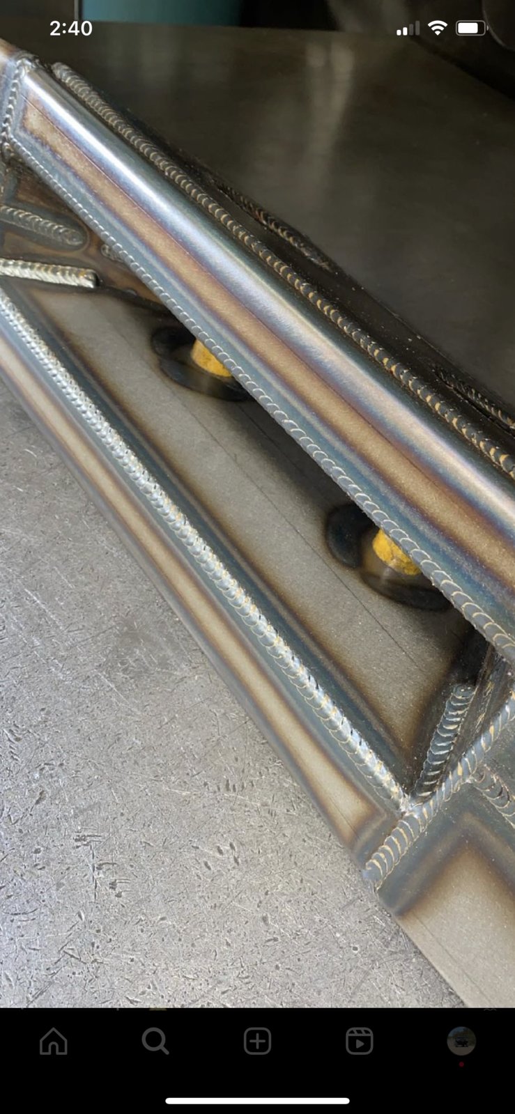

    Absolute weld porn

    Cool and slow. Push pull. The proper way to make dimes with legitimate strength and penetration. Mad props to the guys that can put out mig work like that. It’s just as much of a skill as TIG.

    So I sent my cousin this photo. He's a supervisor for Seaspan, a company that builds warships for the us military etc. he used to be a welder for another company that welded projects for NASA and other US Military projects that he wasn't allowed to know what he was building.
    I asked if these welds from occho would pass inspection (they are really pretty welds). Here's what he said:
    "Aerospace no, seaspan yes, structural maybe, race cars yes"
    I'm not saying you can't make strong and nice looking welds, but I am saying that the best of the best welds won't look like that if the application is purely for strength and aesthetics are not a factor at all.
    But the main point of the video I posted is that just because a weld "looks" nice, doesn't mean it necessarily is strong. I think in offroad especially, it is very common to focus more on what a weld looks like than how well a weld performs, and that's why I've seen and personally had so many different products fail.
    All that said, I don't think the guy in the video is an especially amazing welder, but I don't know much about him.

    The video you posted was tack and go type welding. Exactly like what was done on my steering clevis’s. Tack and go 100% lacks fusion and is not a strong weld. At no point, are the aesthetics of a weld part of passing or failing in real world certs unless it’s full of inclusions or porosity. It’s nearly impossible to say a weld wouldn’t pass via visual. Unless the above is noticed. I too have a few people I know personally in aerospace. And MIG isn’t even a topic of conversation.

    Depends on the job. I know one of the projects my cousin helped build was the rocket carrier that shuttles rockets to the launch pad. They used mig for that, though obviously it doesn't leave the ground. I think the reason that the "dime" look doesn't pass is all the little humps along the edge of the weld can create inconsistencies in the weld and stress risers. And the welds aren't allowed to vary in thickness the way that the dimes do

    When making 14 passes no one's going to appreciate the first 11.
    I guess it depends on what the spec being called out is for a weld in reference to why they wouldn't pass - could be too much of a crown or anything
