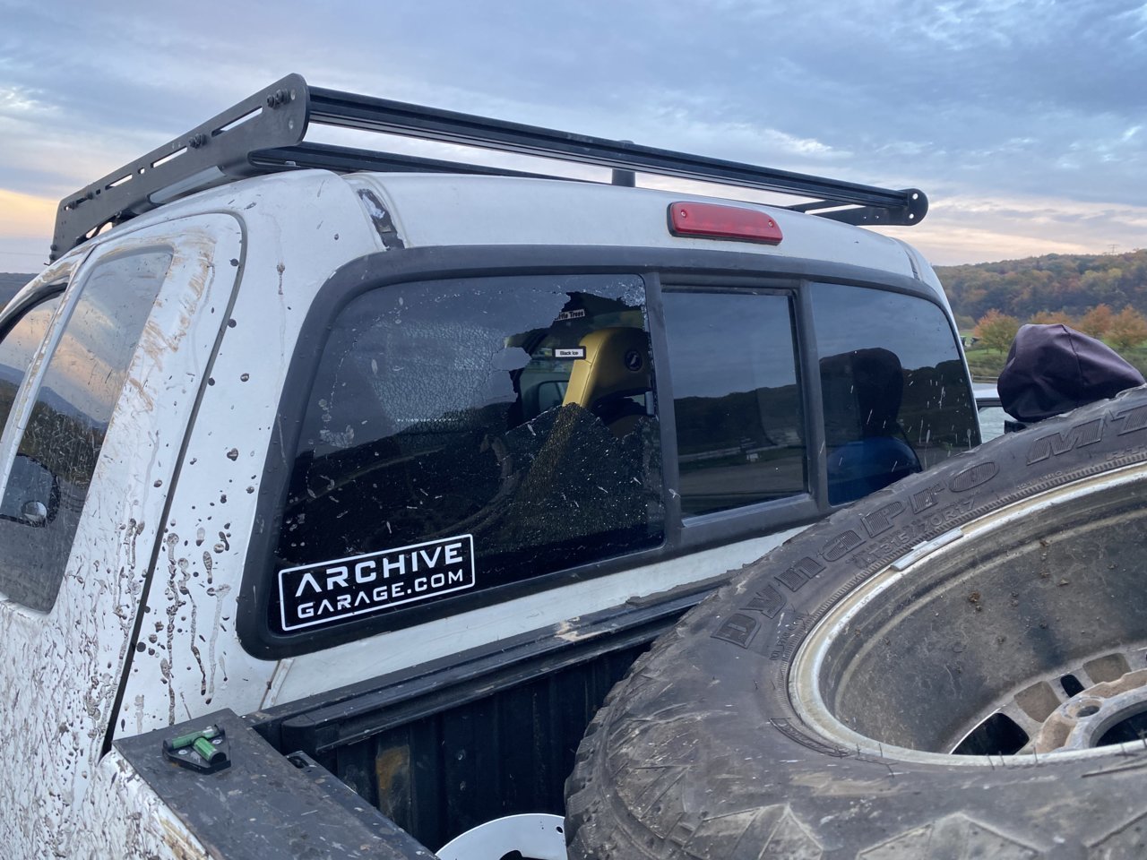

    Where did you get the solid window? Is that a factory thing?

    From safelite, not factory. It was $450 to have them come to my house and install it in my driveway.

    I loved the solid rear window look, cleans it up a bit. I, too, never touched that sliding window.

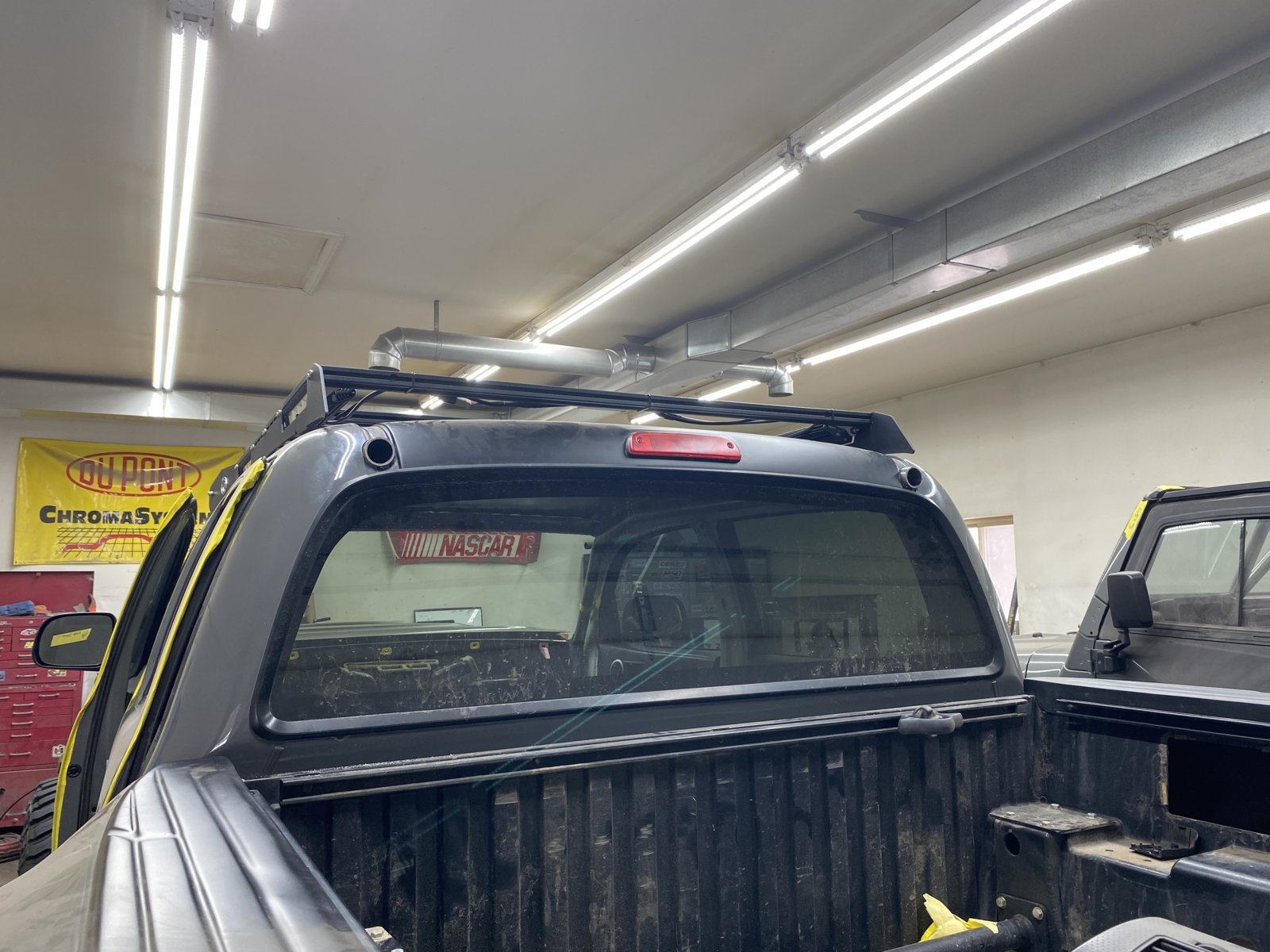

    130$ on eBay and about an hour of time.
    Carpet tape the old window inside and out. Whack it. Cut old adhesive with utility knife. Glue new window and done.
    sliders are useless on anything other than a regular cab.

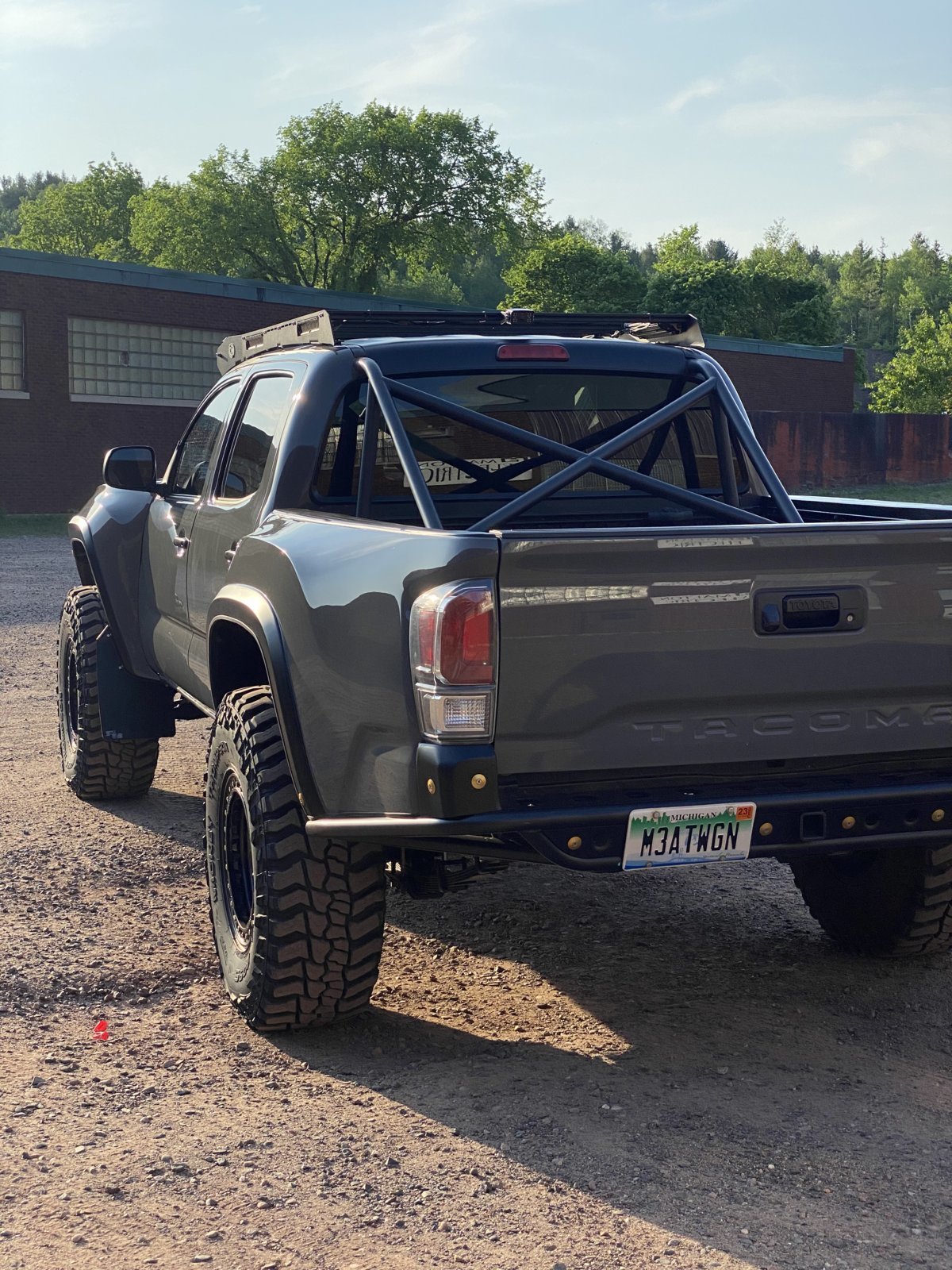

    Honest question, but when you poke the roll cage out the back of the cab is it water tight?

    Absolutely. Done right you only have a hole the exact diameter of the tube. Then you braze it and seam seal.

    Typically the frame to cab flex is greatly reduced once you cage it

    Wasn’t sure I had a picture. Anyways, this is how I went through.

    There is virtually zero flex when you tie it all together. But anywhere you attach cage to sheet metal it has to be silicon bronze or it will crack the hell out of the sheet metal in a short amount of time.
