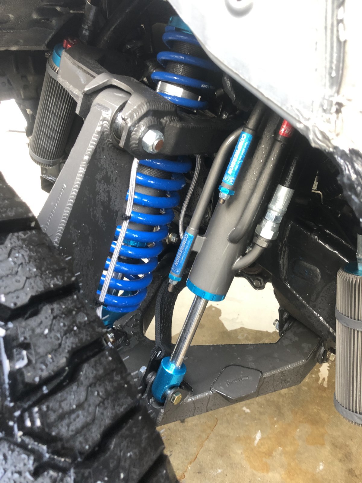

    everything in this photo is Cerakoted 654D48C5-1944-40F7-AA12-5BF08E5C8D0D.jpg
    Also
    Baked vs air cure Cerakote is a big deal
    Bake on is the only way to go and it is 10x stronger than powdercoat
    It also has abrasion/impact/and chemical ratings on the specific paint and binder combination you use via the mixing calculator on Cerakote’s website
    *ps I might be the only Cerakote certified person in here (gunsmith)
    I live in kentucky
    All my shit is subject to road salt and such
    All of it looks the same as the day I coated it
    BUT brake fluid and other costic fluids if left for more than 30 min
    WILL STAIN
    But nothing insane
    From a distance you can’t even see the stain in this photo on the LCA from brake fluid
    fun fact
    The king shocks military line
    Is all Cerakoted

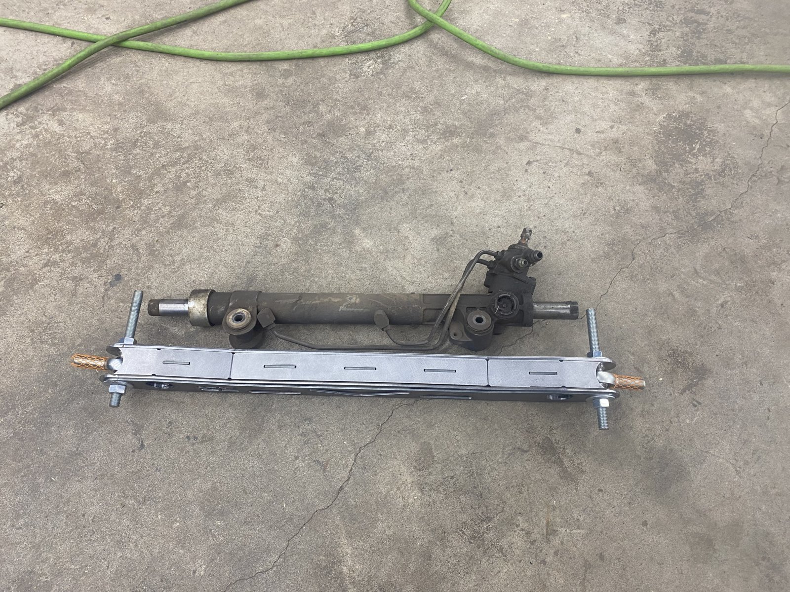

    What is he building in there…:gossip:

    We all better hope he is perfecting a taco swing set :rofl:

    It’s actually a weapon to hit raptor fan boys with.
