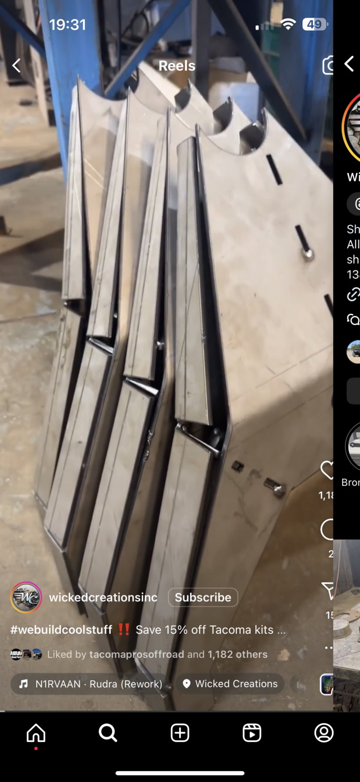

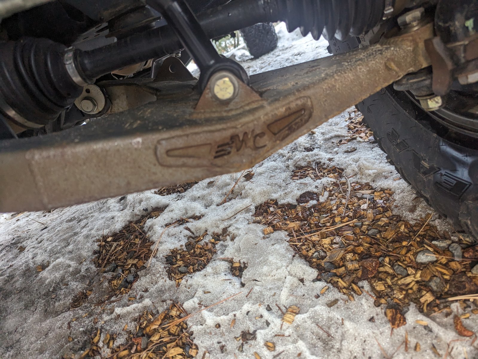

    grind that whole emblem plate off, there will be a ton of rust behind it and it will always happen again. my current links are ready for the dumpster because of that same problem. any shop that manufactures anything with an emblem plate like that is straight up fkn stupid

    I would be cautious to do so. Their plate work right there has an open seem that gets welded up. I’d bet the plate was there for reinforcement. Fill in the emblem and grind it smooth would probably be better.

    ah good catch…but it won’t get rid of the cancer behind it so grinding it off, cleaning it up and adding a new overlay would be the cure huh
    having that seam that way seems really odd i feel like most kits have the bent sides on the bottom piece so that seam meets flush ?
    i underestimated what was going on with my links just thought it was cosmetic and then the overlay plate started to swell and the next thing i knew i had full on scale rust = links to dumpster soon
    i was looking at a rear axle housing recently and it had an open emblem plate on it and i asked if they could eliminate it and they “nope it’s our logo dude” i offered to pay them to run a micro tig around the inside edges to seal it up “ we can’t do that “…sorry then wont buy it
    SoonToBeOn39s likes this.

    That decorative plate won't add much structural strength with all the laser cutting of the logo and windows in it. IF it was a concern you could add a diamond shaped overlay or a long one like TC 1st gen kits. The PC quality is important too. This is a truck from Reno and it gets driven in snow all winter too.

    They're definitely a little strange down at wicked lol. I wish I never bought their kit. Their customer service sucks too
  20. Feb 12, 2024 at 8:03 PM
