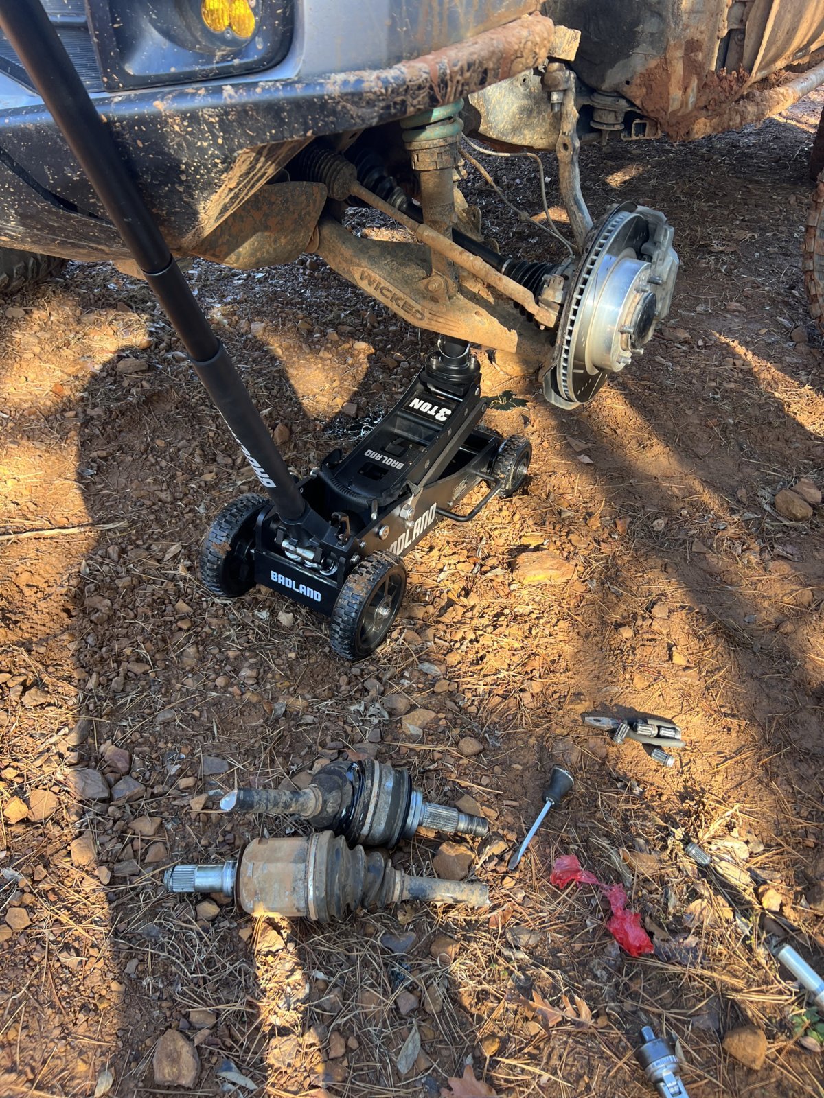

    Seen a guy do this twice with their +5 shafts. He was hard on it but it is crazy the shaft broke before the oem tacoma joints.

    Haha yes this was his first trip with them. Not saying something shouldn’t have broken but that bar should outlast the joints. They used to advertise 4340 or 300m but it looks like that was pulled off the description. Could be heat treat issues as well or just that the bar necks down too much in the middle.
    It was a hard bump with the front unlocked on this ledge

    yeah the oem joints or diff in general with the add tube should be weak points long before the axle shafts themselves…
