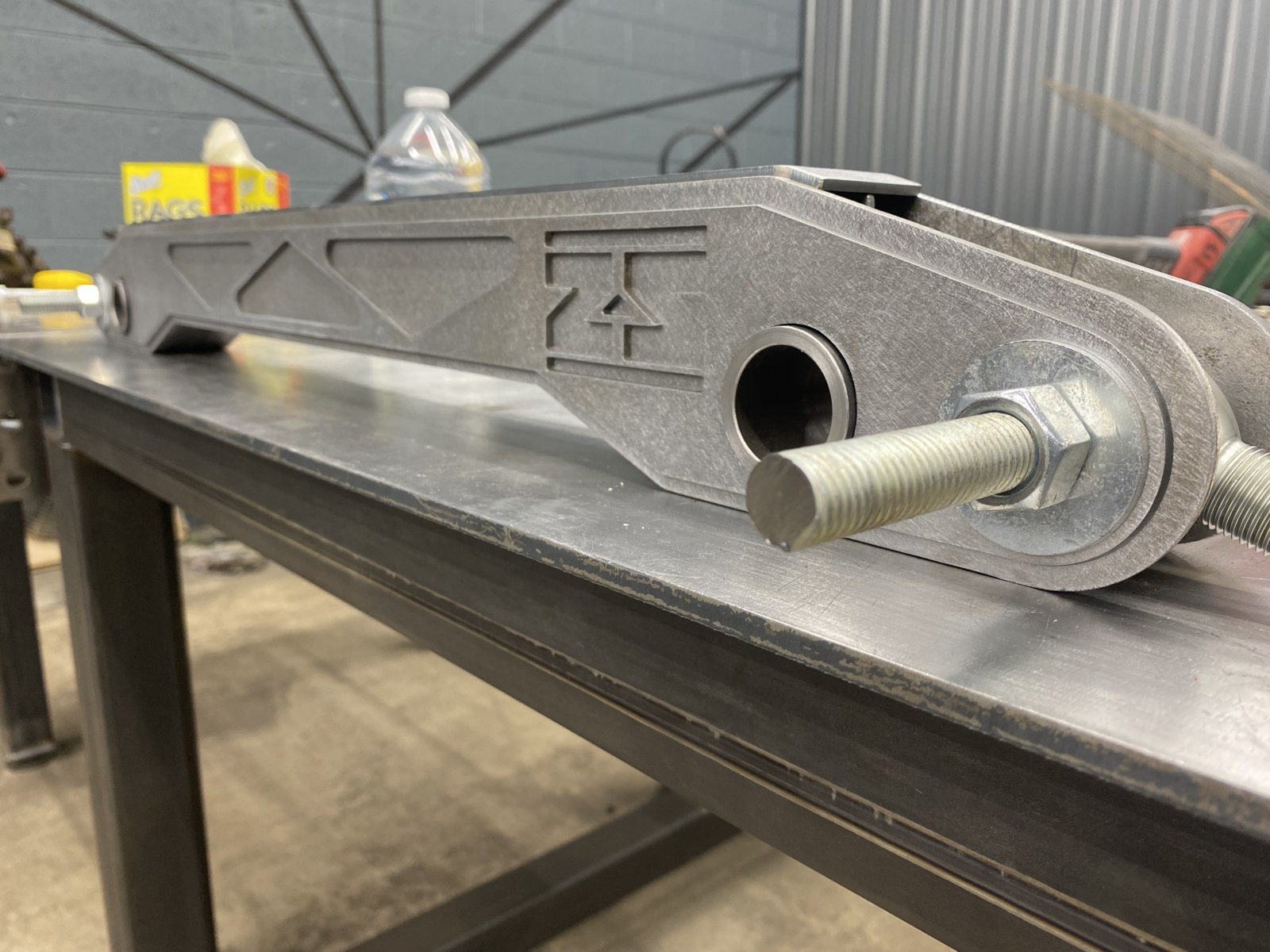

    Had to make a small change for some added clearance. But this is the final prototype, and my lord. Is it sexy. Stay tuned, this thing is going to production after proofing.

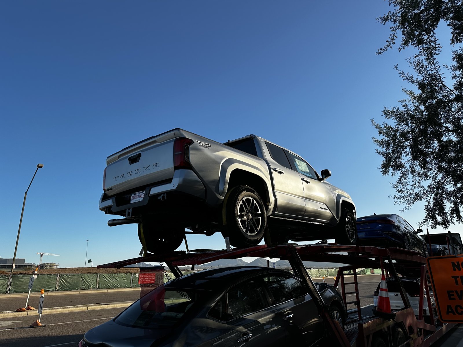

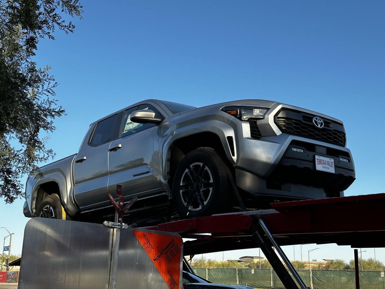

    Saw this guy on a used car truck that showed up at work today…

    Toyota killed the Tacoma with those body lines

    Man if that rear door is an indicator of less rear seat leg room like the similarly shaped 3rd Gen Tundra door, I’d be interested to see the measurements from a 4th Gen compared to a 2nd /3rd Gen. And while the plastics are obviously going to make a difference, I was expecting a little better looking production run based on these pics that came out last year.

    I saw it at KOH and didn't pay much attention to the fugly body lines, so I guess in person they aren't that fugly?? I am curios about back seat leg room too.

    It's amusing how this happens with every new generation of anything. 1st gen owners said it about 2nd gens, 1st and 2nd gen owners said it about 3rd gens, etc.

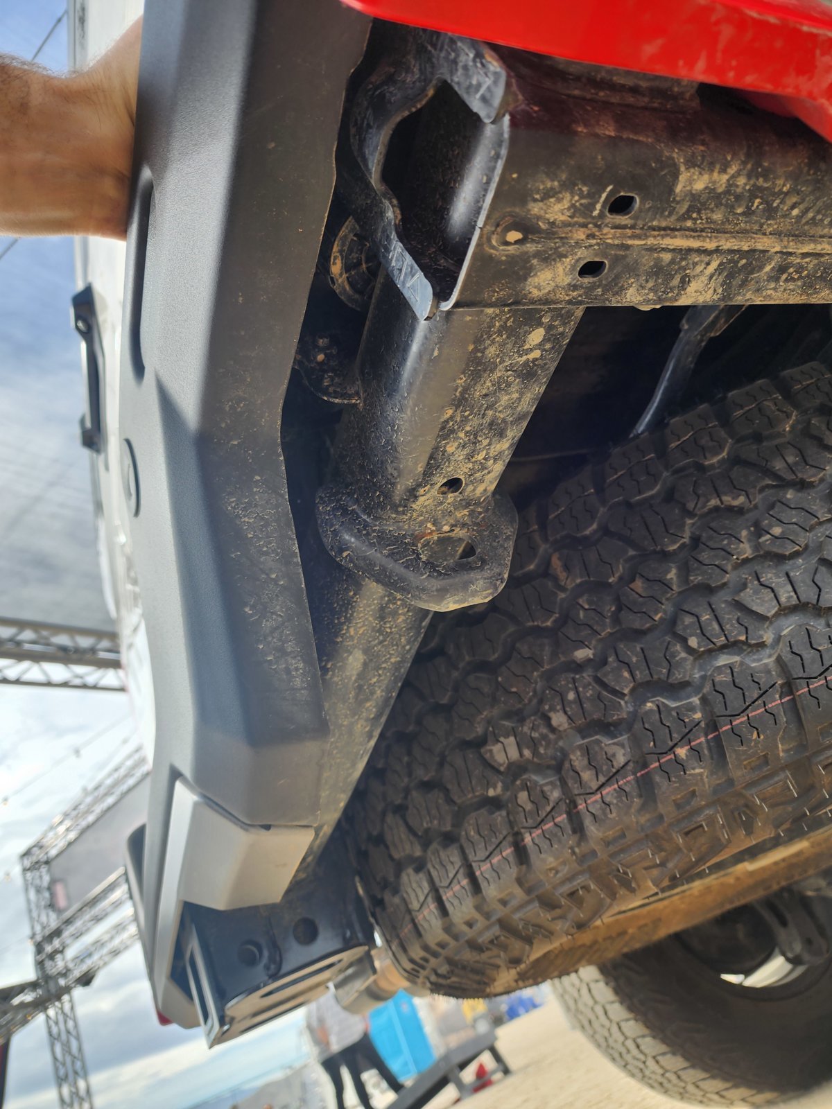

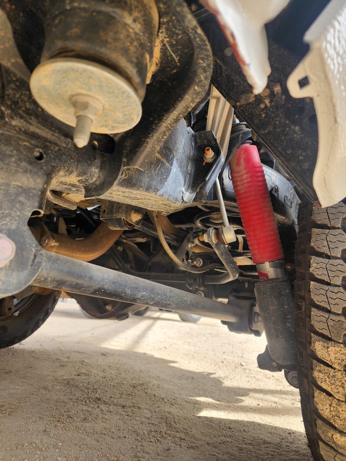

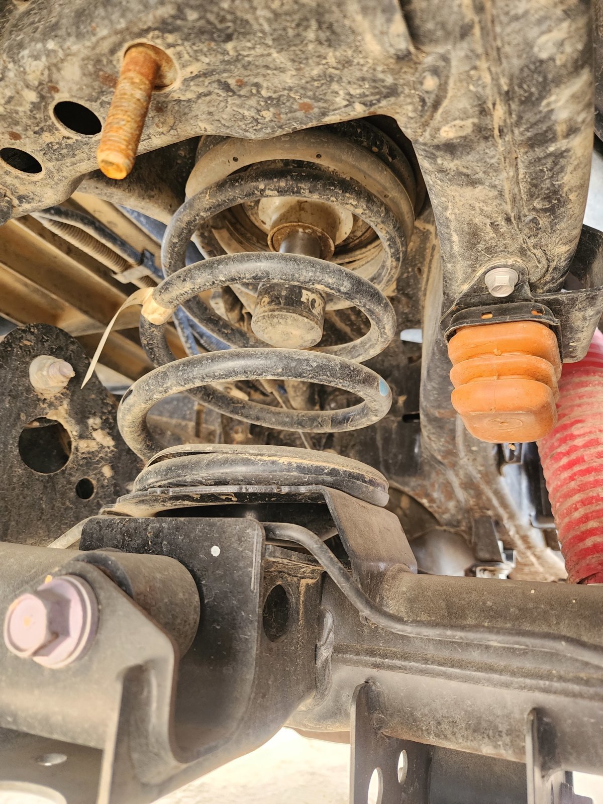

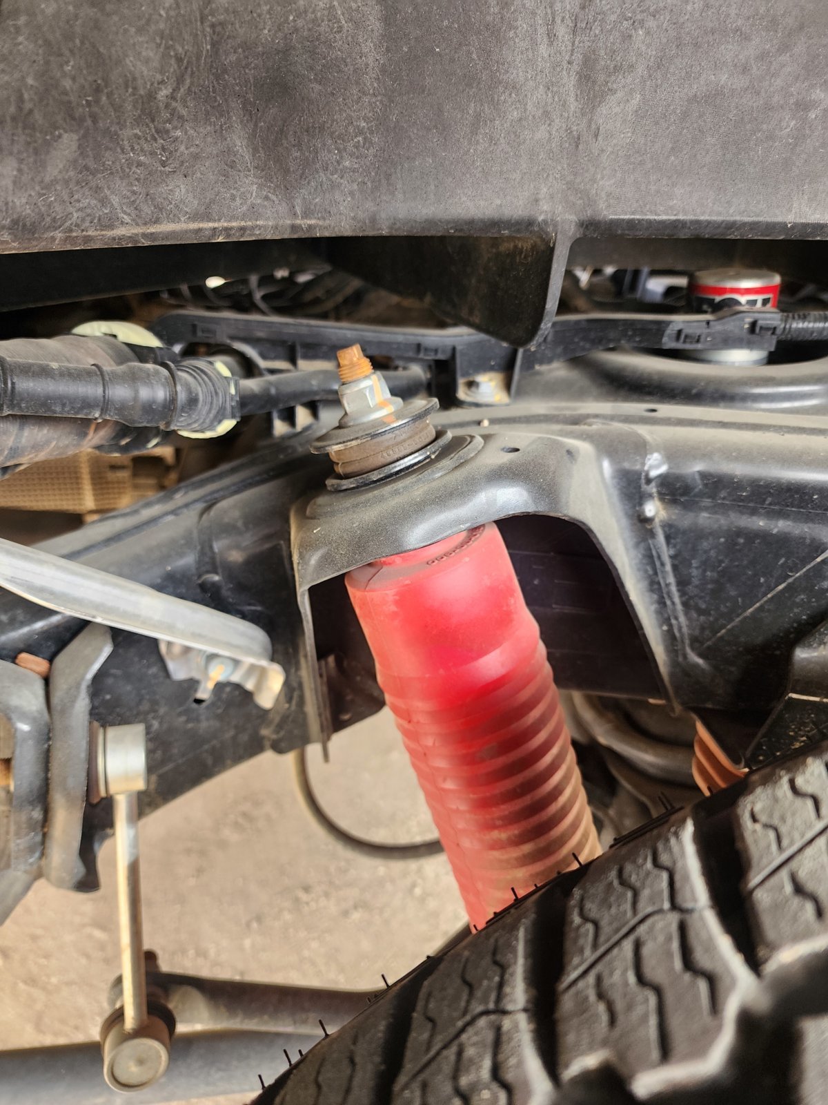

    Rear bumper manufacturers are going to have a challenge, since the rear hitch is welded to the frame now.
    Rear fox hydro bumps on the pro
    Rear Shocks hang low like the tundra, but have tonnes of room above like the tundra. Easy to get a lot more travel in the rear at least.

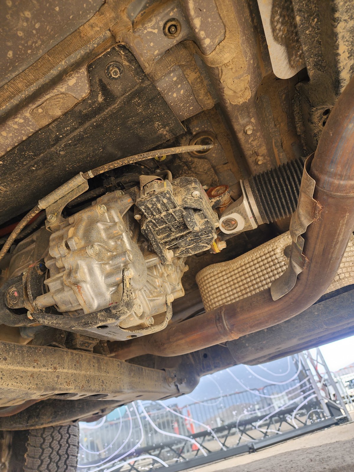

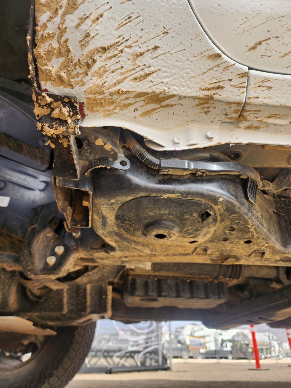

    New cab mount design is similar to the tundra as well. It looks like a 33 will easily fit without a CMC. For a 35, I'm not sure but will be close.
    Finally routed the exhaust in a way that actually makes some sense. Easier with a 4 cylinder though
