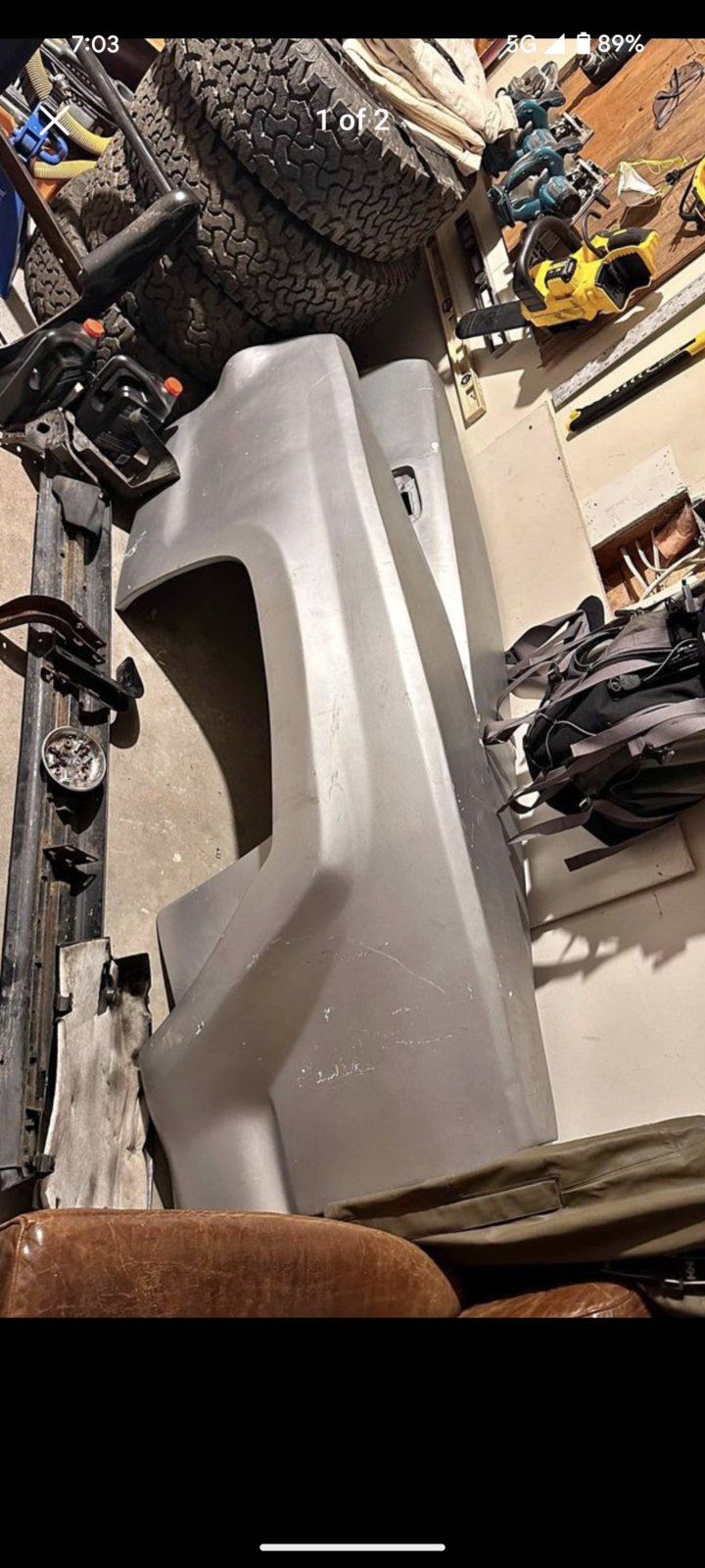

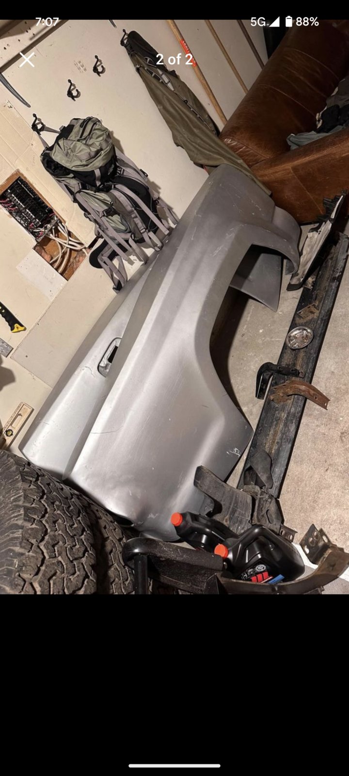

    Does anyone know what kind of bedsides these are? They appear to use a round tail light. Found em on my local classifieds. Don't have any other pictures at the moment.

    I meant more of the random plugs covering like the body mount and such that they appear to have added. And likely a bunch of plugs covering all the boxed frame holes or something like they did for later 2nd gens.
