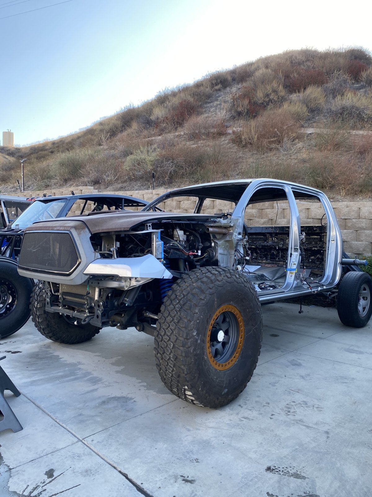

    do I chuck my cab and frame, and start from scratch with the links, shocks and fuel cell, ect ect that I already have and do center mount tube chasis with the LT motor I have
    Cause at this point
    All my parts make a car on their own, and I’d only really be losing the cab/frame and the solo front kit, everything else would move to the new “car”

  15. Feb 16, 2024 at 10:53 AM
    Caboose117
    Caboose117 foul mouthed Marine
    Aug 3, 2014
    #135375
    4,661
    Chad
    Kentucky
    ;IGY6 Rescue Truck
    smashed this, broke that, covered it up with tape and paint
    It’s in cali
