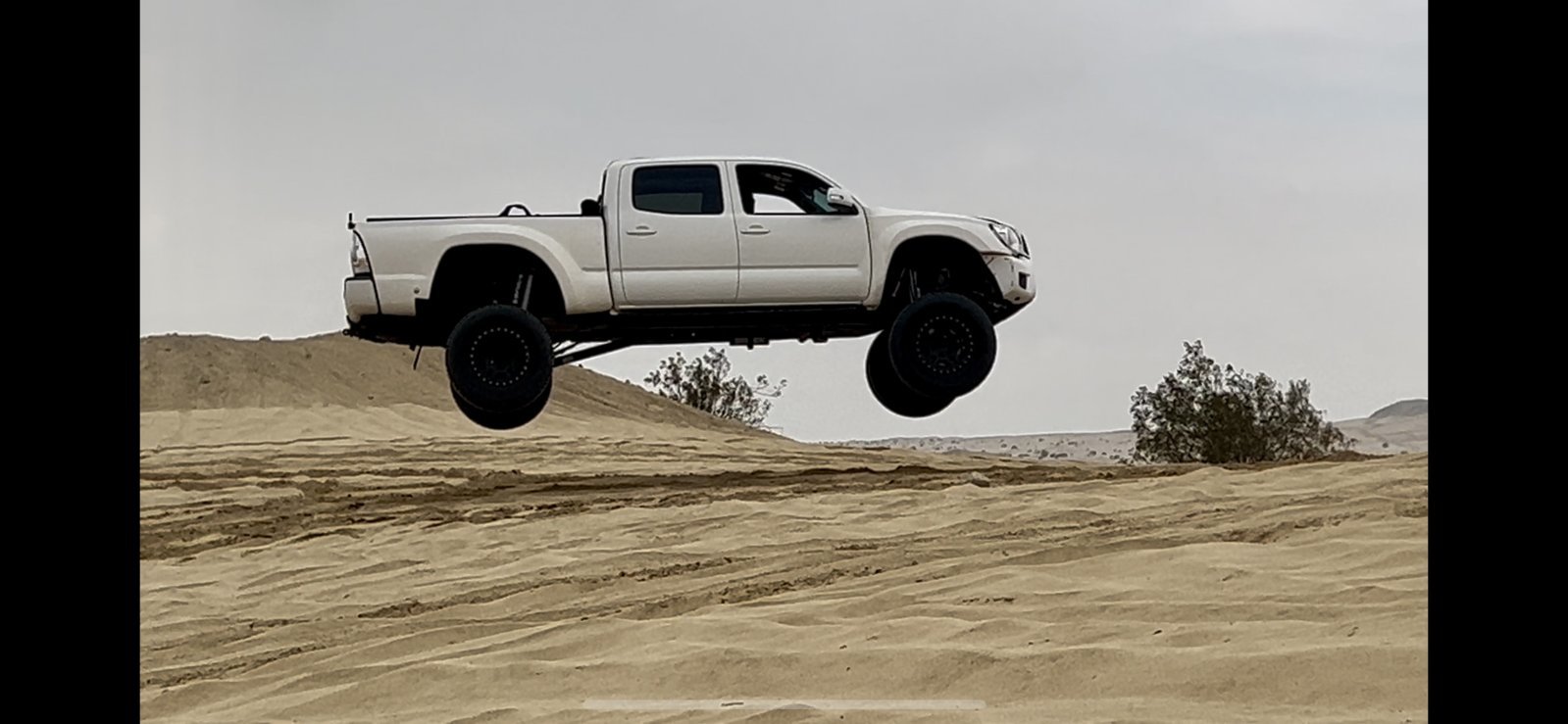

    Thought the same thing as soon as he said Simi and I saw the backdrop
