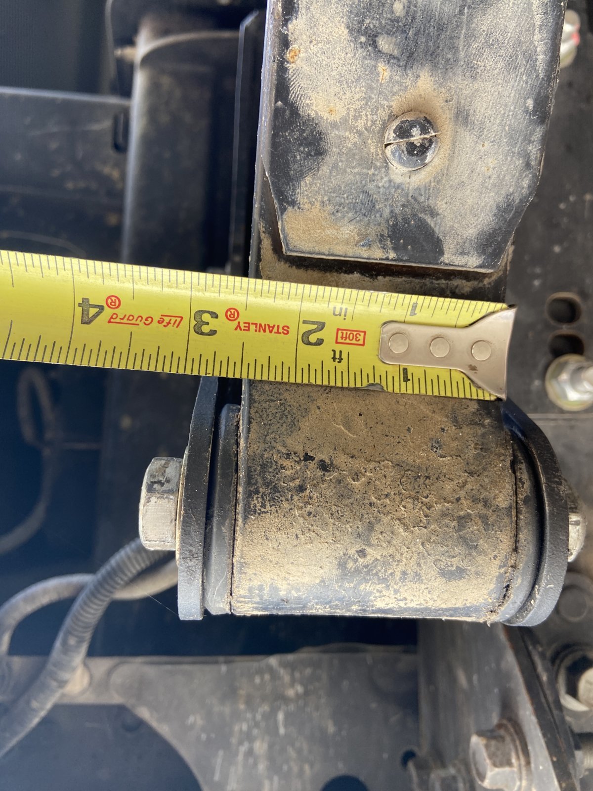

    Does anyone know the width of H70HD's. I saw a pretty good deal on Facebook and I've been in the market for some spring under springs. Last year I was planning on doing a c63 swap and bought the ruffstuff swap kit, but then heard bad things about the c63s. So I was hoping I can use the hangers and hardware on the 70HD's.

    off my JD fab kit h70HDs

    Sweet thank you. It’s the same width so if all the hardware lines up the only thing else I should need is the leaf cradle.

    You'll need 12" shackles, shackle mounts, front leaf mounts, and spring perches (probably came with the ruff stuff kit), and u-bolt plates
