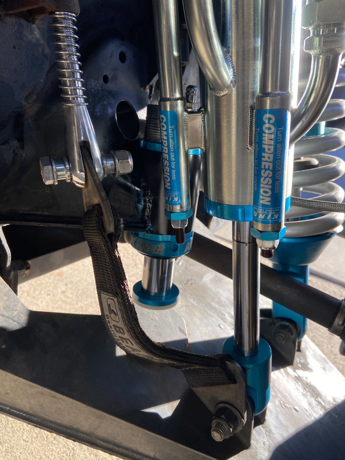

    Thats exactly what I'm doing today, but with Bilstein bumps and pinch style cans (no plan to ever run a bypass so room isn't an issue or else I would have opted for those threaded kings).
    2-1/4" hole saw straight up and through the stock bump bracket a little griding and welding and you're good to go.
    Yes, the can is upsidedown lol
