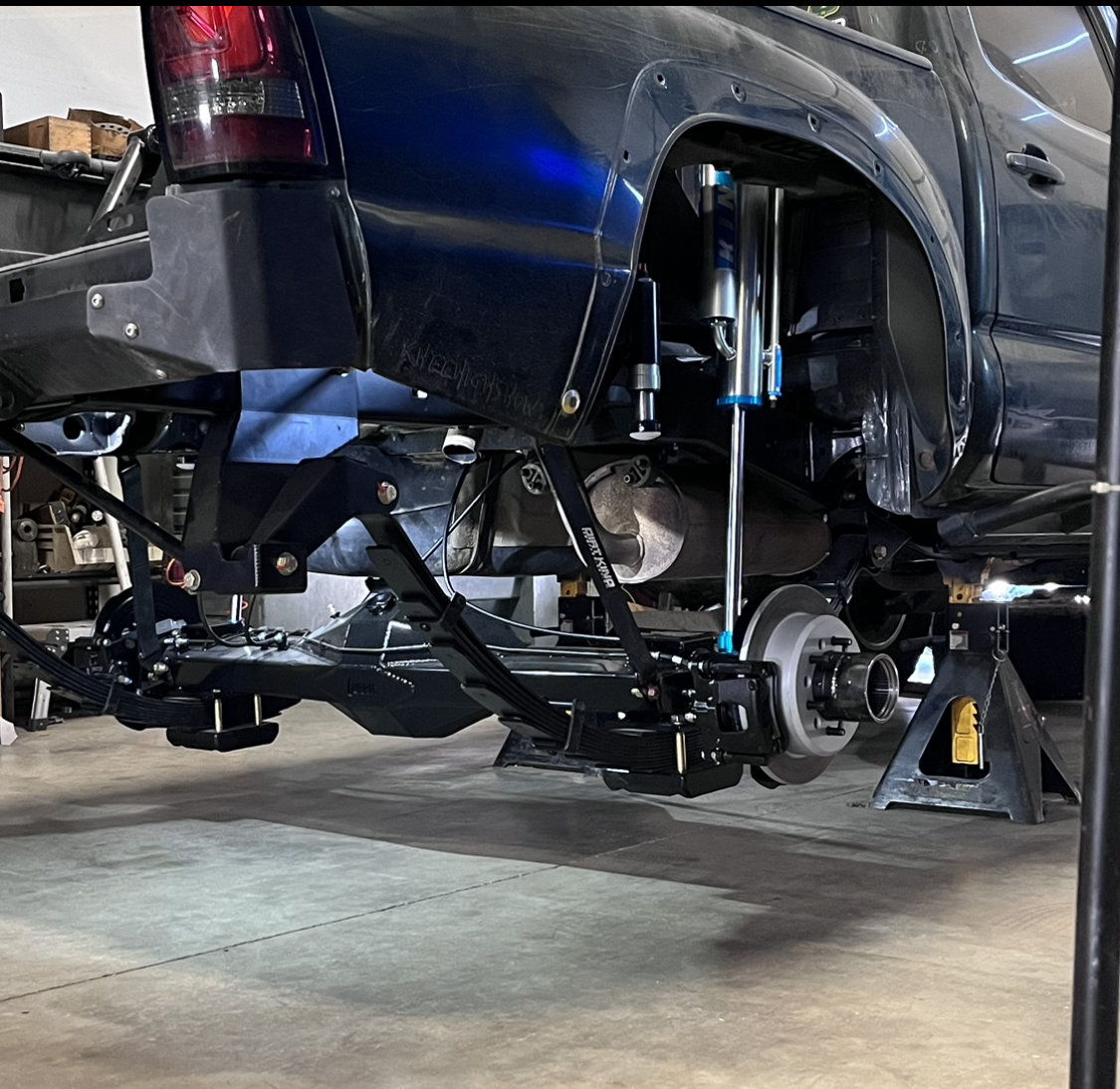

    Just picked up a DMZ kit with u bolt plates for a deal I couldn't pass up on. Time to start piecing together the rear

    I got my whole DMZ kit, shackles, leafs, cage, bolts, frame box kit for 3k. Some dude was really tired of that shit sitting in his garage.
    congrats on the deal man! Love to see it

    How do you like the setup? Any regrets? Im considering pairing the DMZ SUA kit with JD fab shock towers because I like my bed space.

    Love it. No regrets

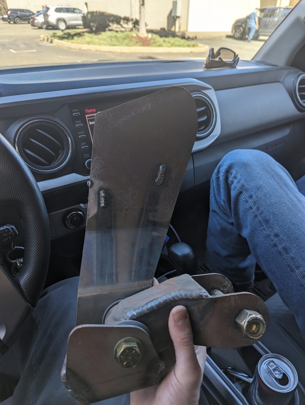

    Can anyone send pictures of your SUA setup with a hydro bump?

    Do you guys leave the stock leaf spring perch as a bump pad?

    stock leaf perch won't work the bump strikes way further outboard than the stock perch, you're going to have to build/buy a pad for the bump to strike. There's not really a "plug and play" setup other than the bolt on kits used with SOA springs, from what I've seen they all use a u bolt flip and use the plate as the strike pad or a strike pad you slide underneath the u bolts.
    If I were you, I would buy a bolt on bump kit that uses threaded bumps, weld on your "universal "Bump Pads – Now Shipping Free! – Desolate Motorsports strike pad to the axle then adjust the bumps at the frame rather than vice versa.
    I'm using a bolt on kit that uses a pinch style can for fox/Bilstein bumps those have no adjustment once the cans are mounted/and the bump is seated in the can, so I got a universal strike pad and modified it to accommodate my own shock setup. As long as you take your time, mount-cycle-adjust as needed you'll be good to go.

    My experience it doesn’t line up with where the bump wants to line up.

    This

    Thank you for the info! Exactly what I was looking for. I've been eyeing the TC bolt on kit for a while

    Curious what those same setups look like at full compression since all the photos were at full droop.
