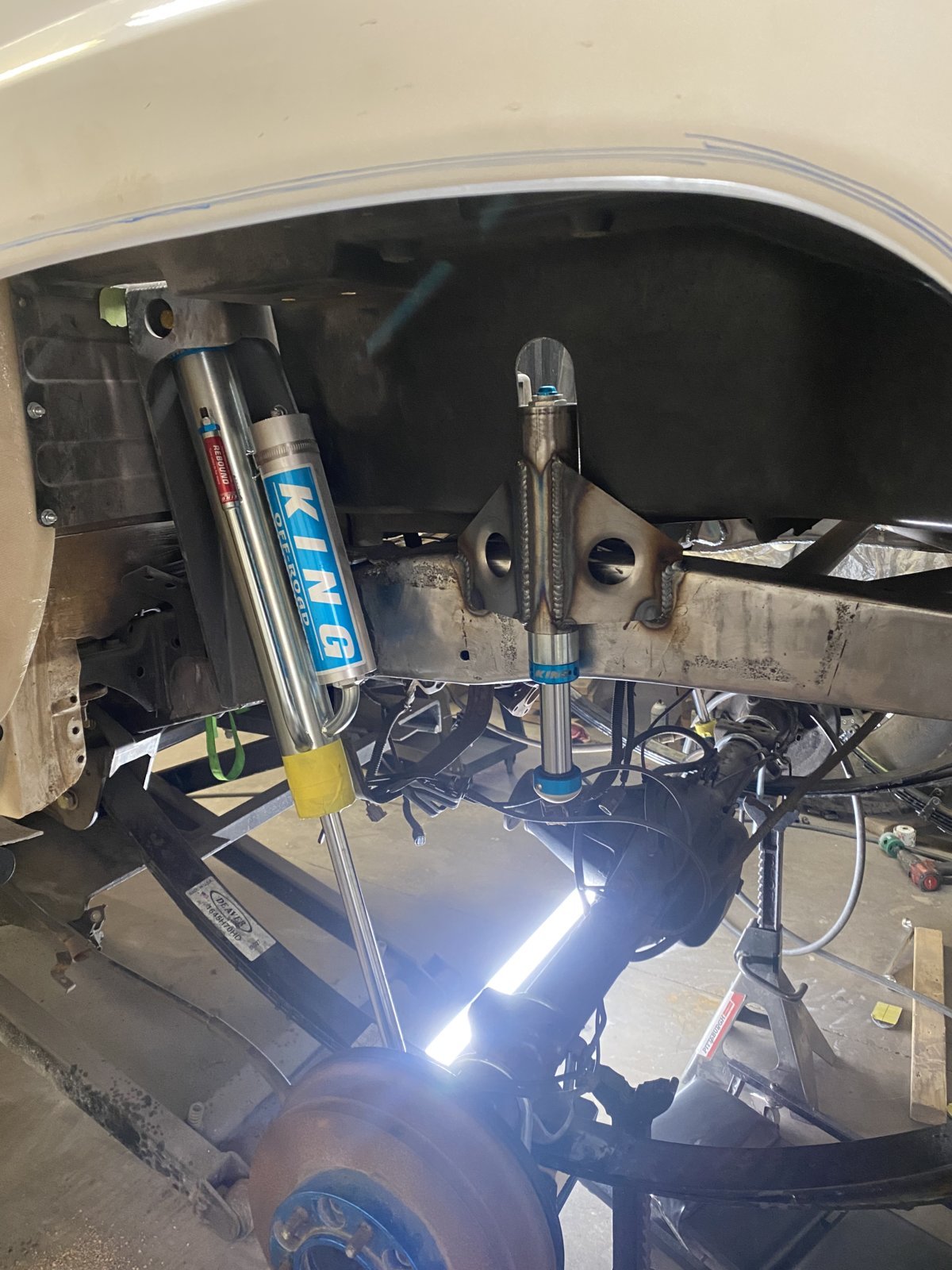

    Since you're going to need to have someone do fabwork to install the DMZ kit, might as well save the money and just have them build some mounts for the cans for a lot less. Here are what I used for strike pads:

    What stroke bumpstops do you all run? Sorry for asking all these questions all the time, I'm wanting to learn, along with doing shit right the first time

    All you need are 2x2 bumps

    3 inch stroke with +/-100psi. 3" stroke at a lower pressure feels better than a 2" stroke at "standard" or higher pressures.
    If you lower the pressure of the 2 inch bump to lessen the harshness you end up blowing through the bumps travel and still end up bottoming out hard, to me the 3inch stroke paired with the dmz sua is cherry,

    Get 4”. You can always shorten them if you want.

    Fitting a 4" bumpstop under the bed without cutting means he'll have to mount them further out or lower:

    Or just do this. I’d rather have to shorten a bump than lengthen it…..

    Can just add more oil on a 2x2 with lower psi to make the initial hit softer and not blow through travel, just stiffens up a little faster.
