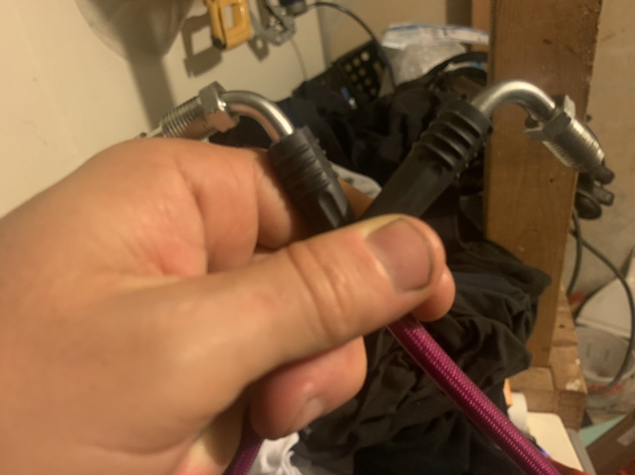

    Just flare your own if you’re doing a large number of them unless you can find coated steel with 10mm tube nuts already on them.
    Why not just get a braided line that goes from the frame block down to the caliper? Take a measurement and if it’s close to what I had on my truck for mock up only from G&J aircraft, I’ve got some I could ship out I decided not to use as I’m doing everything in stainless / -3AN and won’t need them.

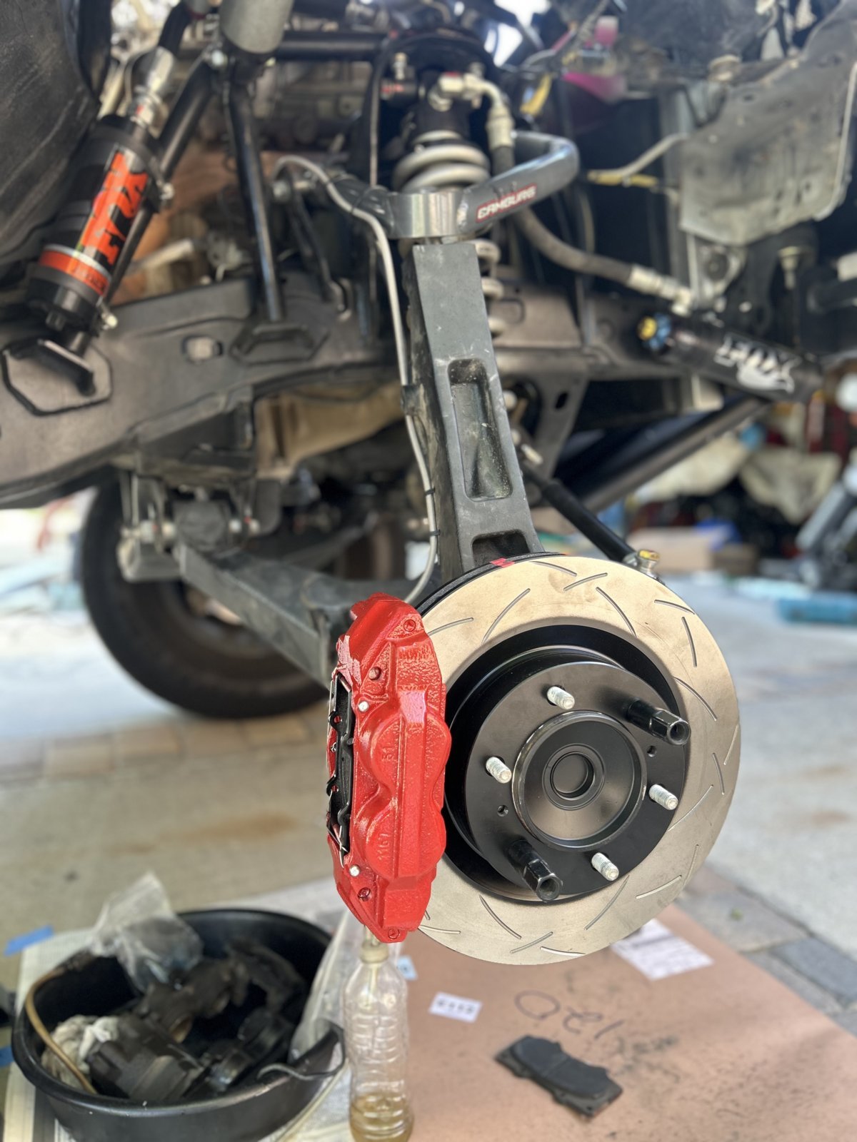

    This is what I did. Had HEL make some sweet ones.
