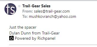

    Hey quick noob question here. Trailgear told me only the misalignment spacer turns when steering but in my case the whole uniball turns. I have it all torqued to spec.

    they either described it wrong or the person you talked to doesn’t know what they are talking about. Yes the actual ball in the uniball is the only thing that should be moving.

    The wear surface is on the outside of the unit, not the inner diameter that the bolt and misalignments fit into, so wrong. That would be like an inner sleeve on a poly style bushing (but even those will sometimes rotate a little on the outside)

    You mean only the outer race moves right?
