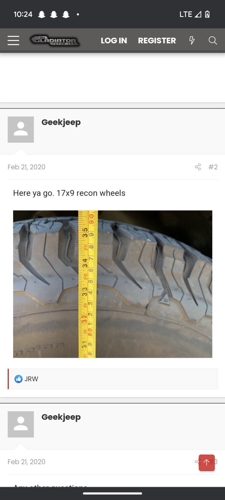

    I finally got bigger tires 2020 Long Travel Tacoma 1997 MAGNUM
    Answer I was looking for!
    I was looking at ko2 37s since they size super small (more like a 35). Maybe easier to fit??

    The ko2 37 is closer to a 37. The ko2 35 is like 34.9. It’s not far off. certainly not 2” off.
    my BTF kit pushes my wheel forward a little bit, and have a CMR. No firewall tubbing at all, but I have JD fab inner fenders, and no rubbing lock to lock at full bump. When 454 was going the install, we looked at clearancing for 37’s, and it involved tubbing like 3-4” into the firewall to make sure it cleared at full lock to lock at full bump. It’s a lot of work. If all you do Is go fast off road, and don’t really do any rock crawling I don’t see the point of going up to 37’s. Then again, I don’t really know what I’m talking about, I’m probably just ignorant per usual. There’s probably a good reason to do 37’s, I just don’t know that it’s worth all the pain and brain damage to not only make them fit, but also wear on wheel bearings, steering, and other mechanical components.

    This is where I got the "true" size of a 37 ko2.
    Yeah I can see how 37s has a huge impact on everything.
    I'm assuming you got 35s? How do those clear at full bump with the jd kit?

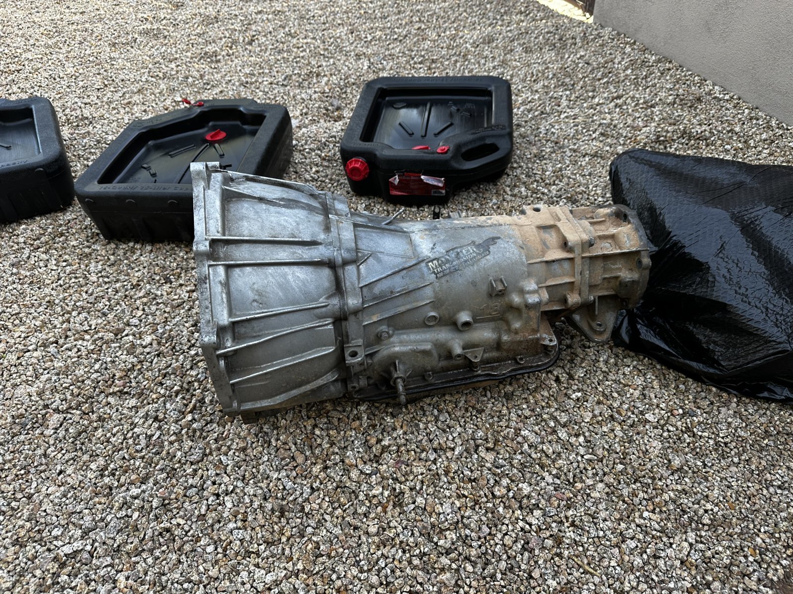

    W.
    also L. But W.

    Make sure you get a new cooler if your fluid was effed too.

    Honestly the fluid was still red and good. Amazon exchange time I guess
