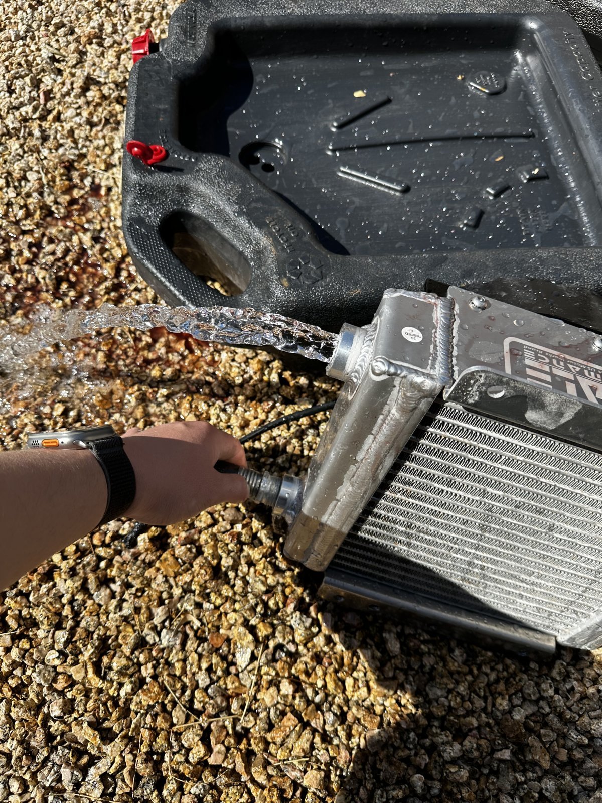

    I filled the cooler with 99% isopropyl after this. I’m letting it sit right now. I flushed with the hose in a few different orientations and from both ports in every orientation. I’ll drain the isopropyl and call this good. The ATF that came out of the trans looked fine, it didn’t look any more disconcerting than normal used ATF.

    Just filled and drained the cooler twice with ATF to clear any alcohol residue or any residual water. Runs super clear(red), just like it’s coming out of the bottle. This thing has gotta be spotless on the inside.

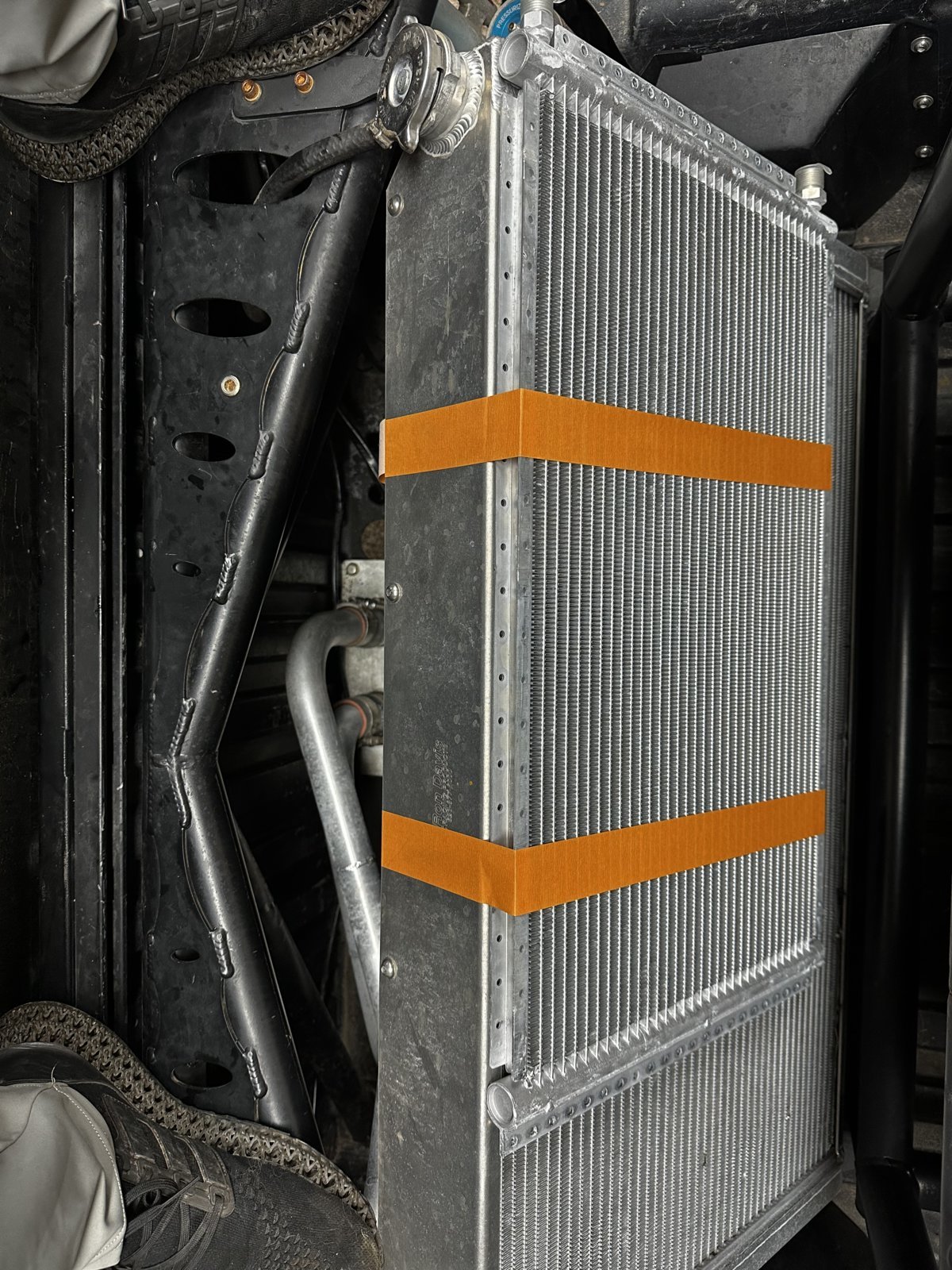

    @XPOTRPR said he might help me on a little project to mount up my condenser!

    Replied to your DM on IG. We need to get together and see what we can come up with! Need to see it in person and brainstorm.
