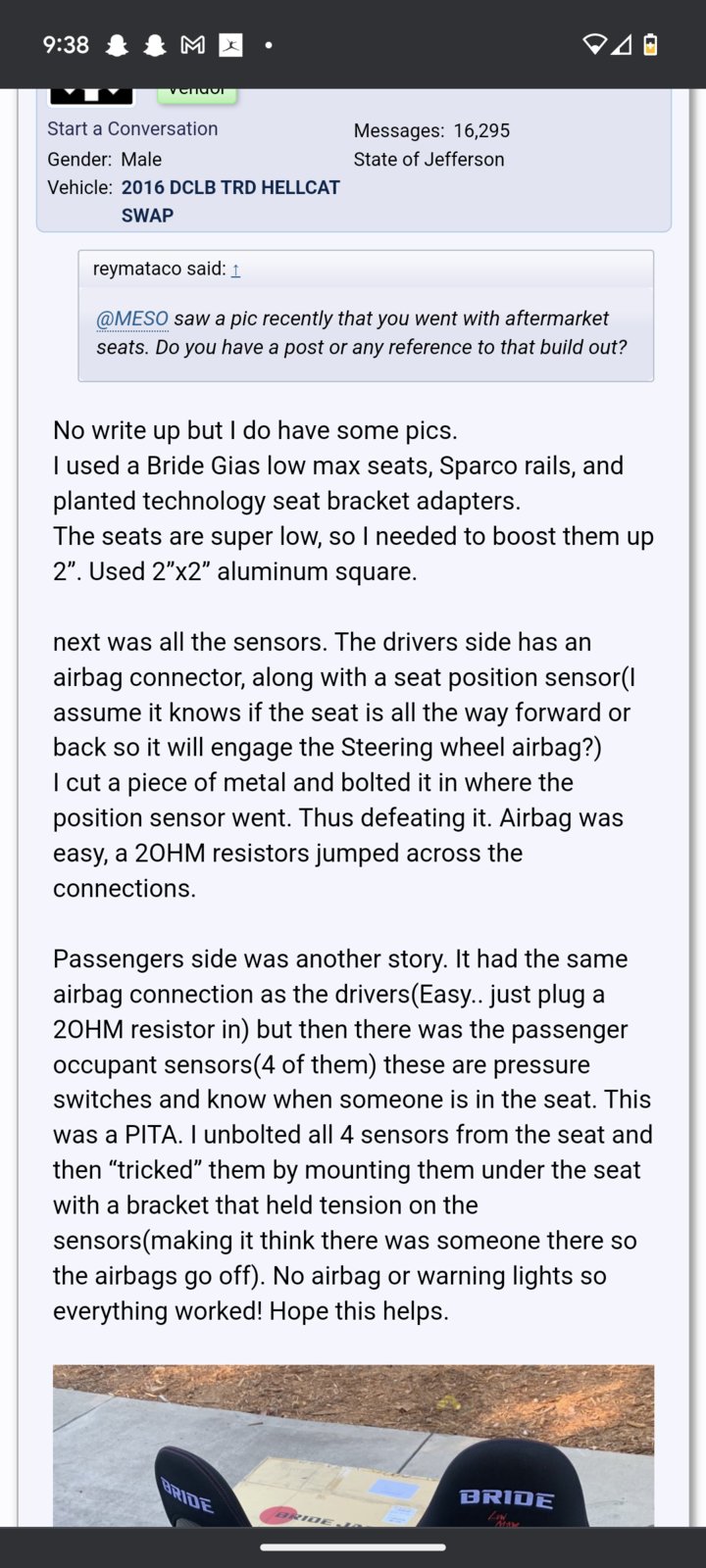

    I have a 2018 with a LT kit, I mainly do slow speed crawling so I don't have a cage. I don't like my stock seats. Sense the stock seats have air bags, what do I need to consider if I want to change the seats? e.g. safety, disabling air bags on the seat to prevent codes, etc.

    2 ohm resistor for the airbag harness that goes into the seat. I believe there's a thread somewhere in here that Meso made when he put prp seats in his truck

    More to it than that if you don’t want dash lights and want the rest of the air bags to function at all. There will be a solution available in the next month or so.

    This is what I based off of.

    There really isn’t more to it though. Proper resistor and the system doesn’t know any better. Should have no lights and full functionality of dash and side curtain bags.

    Summary for non caged crew so that airbags work like OEM.
    - Driver/passenger airbag resistors
    - Passenger seat weight sensors clamped
    - Driver side seat position sensor (little black sensor under seat) set up similar to stock

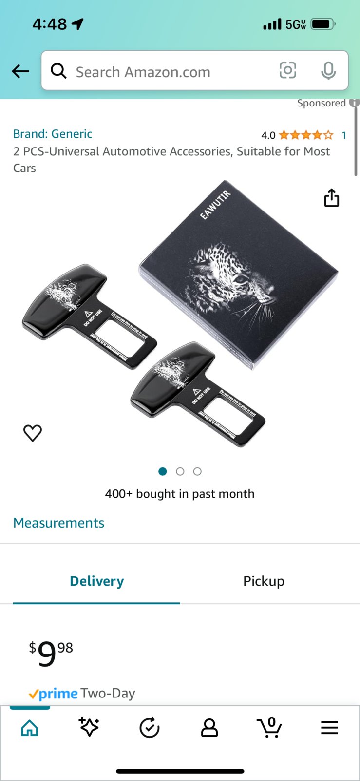

    I got one of those seat belt chime things off of Amazon to plug into the seat belt, worked great.
