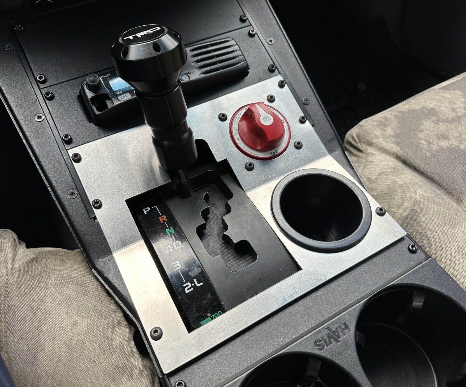

    I asked about remote battery shutoffs a while ago. Finally wired in a blue sea ml-rbs. Just using the original battery shutoff as my “momentary” switch. And I wired it up so the unit cuts the ground rather than the pos. Confirmed with blue sea ahead of time that the unit would allow that.
    Other units pull 12v+ off the battery input so you can’t wire it that way.
    not_nick, Camazon, YotaFAB and 4 others like this.

    I want to see your center console
