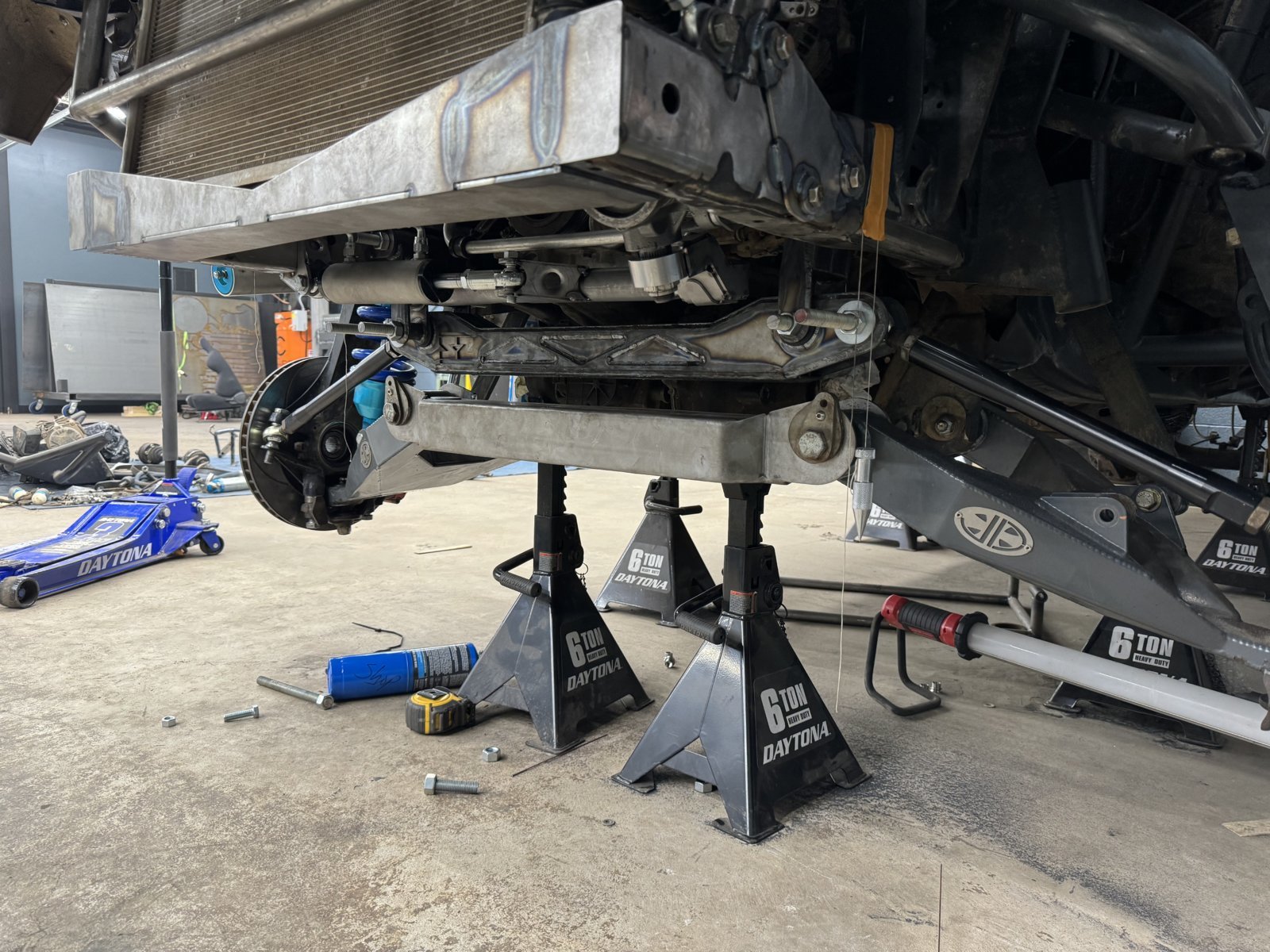

    Well guys. The swingset is a wrap. Lots of welding and whatnot left, but the challenge is over!
    Everything cycles beautifully with absolutely zero bump steer.
    Thinking my next move is ordering some 12” shocks and starting to move forward with the J-arm.

    how is that new front lca pivot tied into the frame ?
    Airdog likes this.
  18. Mar 27, 2024 at 2:37 PM
    906taco
    906taco Well-Known Member
    Jun 22, 2021
    #369289
    3,908
    Cory
    08 Taco
    It’s tied to the JD pivot tube as of now. More going on though. It ain’t staying like that lol.
