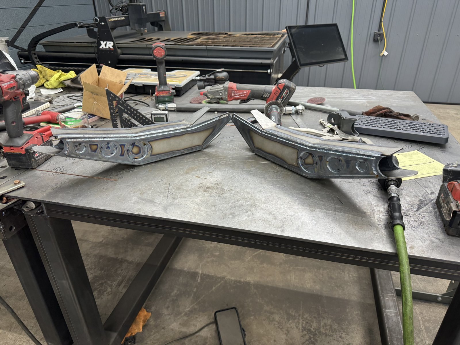

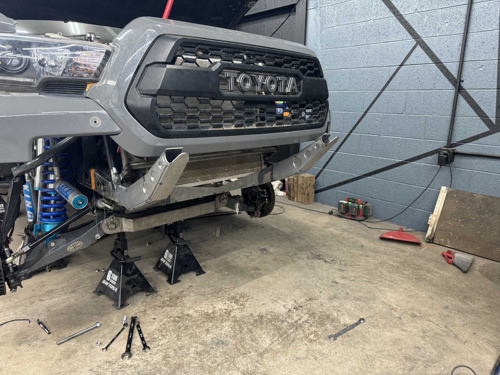

    Working on wrapping these guys up. 3rd gen options weld on and bolt on will be available soon. 1/8 and 3/16 construction for 1.75” tube. More than willing to tack a set together at a super legit price for a “you can finish it yourself” deal. 2nd gen is in progress.

    Perfect base for a DIY tube bumper! Weld on versions were designed for guys that are going to remove the factory cross bar at the front, and are fish plated on top of the frame if you have an engine cage and no core support mounts. However they can be easily modified to fit your needs. Or just go bolt on.
