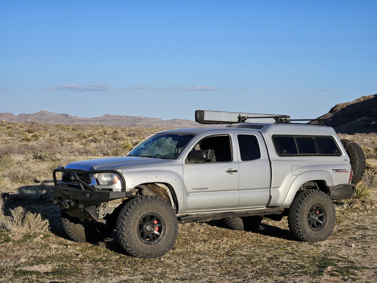

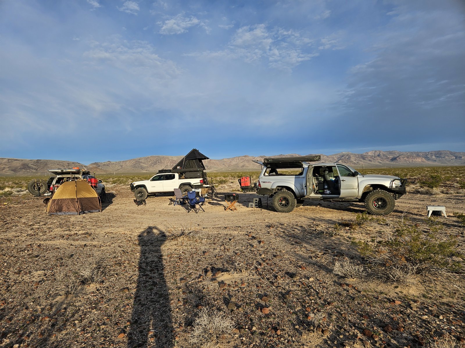

    I'm very happy with my braking.
    Running stoptech on all wheels.
    Think the trd's electronic brake booster is important.
    I'm kinda heavy with my setup when I go out for a week or so and it has no problems handling it.

    Same. They made such a massive difference with all the weight added to the truck. I havent had a single issue with them either and they never heat up or fade plus they shaved 11lbs off each corner.
