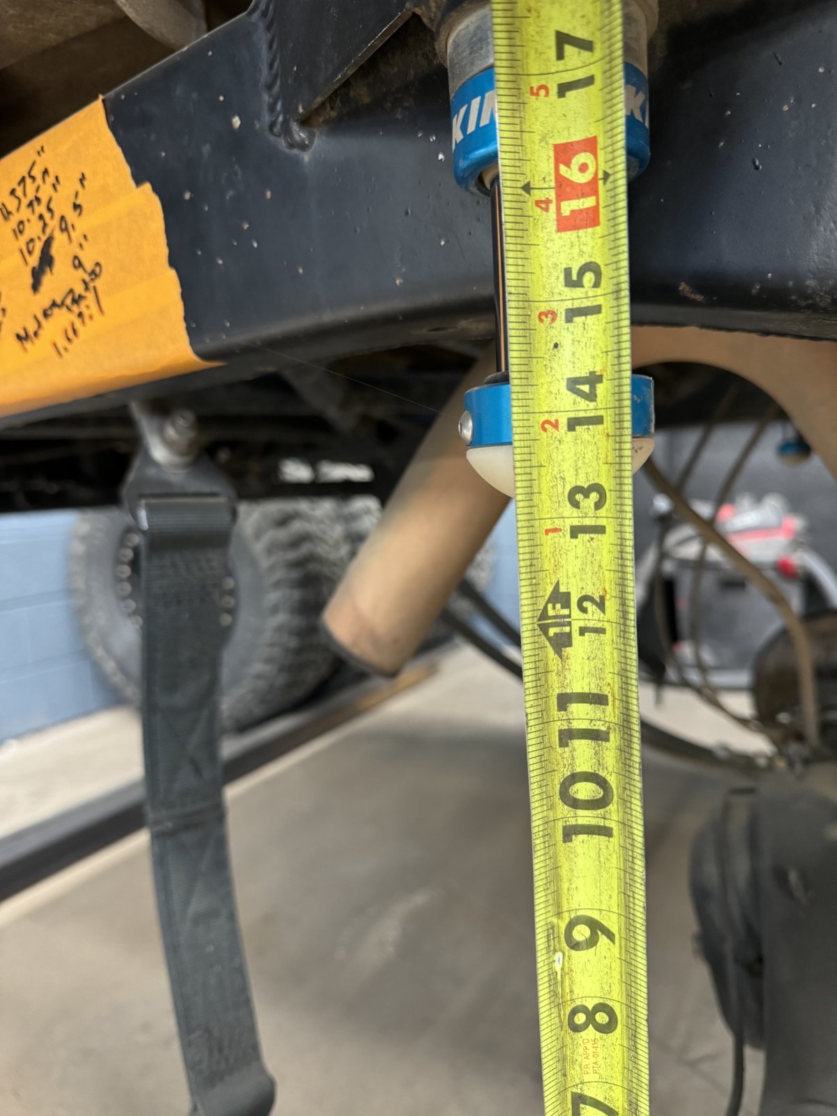

    top of axle tube to bottom of bump pad. 13 and almost a half. Plus 2” of bump. 15 and almost a half. And my straps aren’t connected.
    So either I somehow effed up a bolt on kit. A change was made during production or my truck is somehow one of a kind.

    Yup. No matter which way I slice it with this kit. 19 is not happening. Everyone seems to get all of these advertised numbers though. How, I really don’t know.
