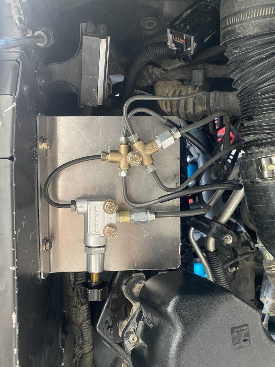

    Do you have a picture of what you did with the abs?

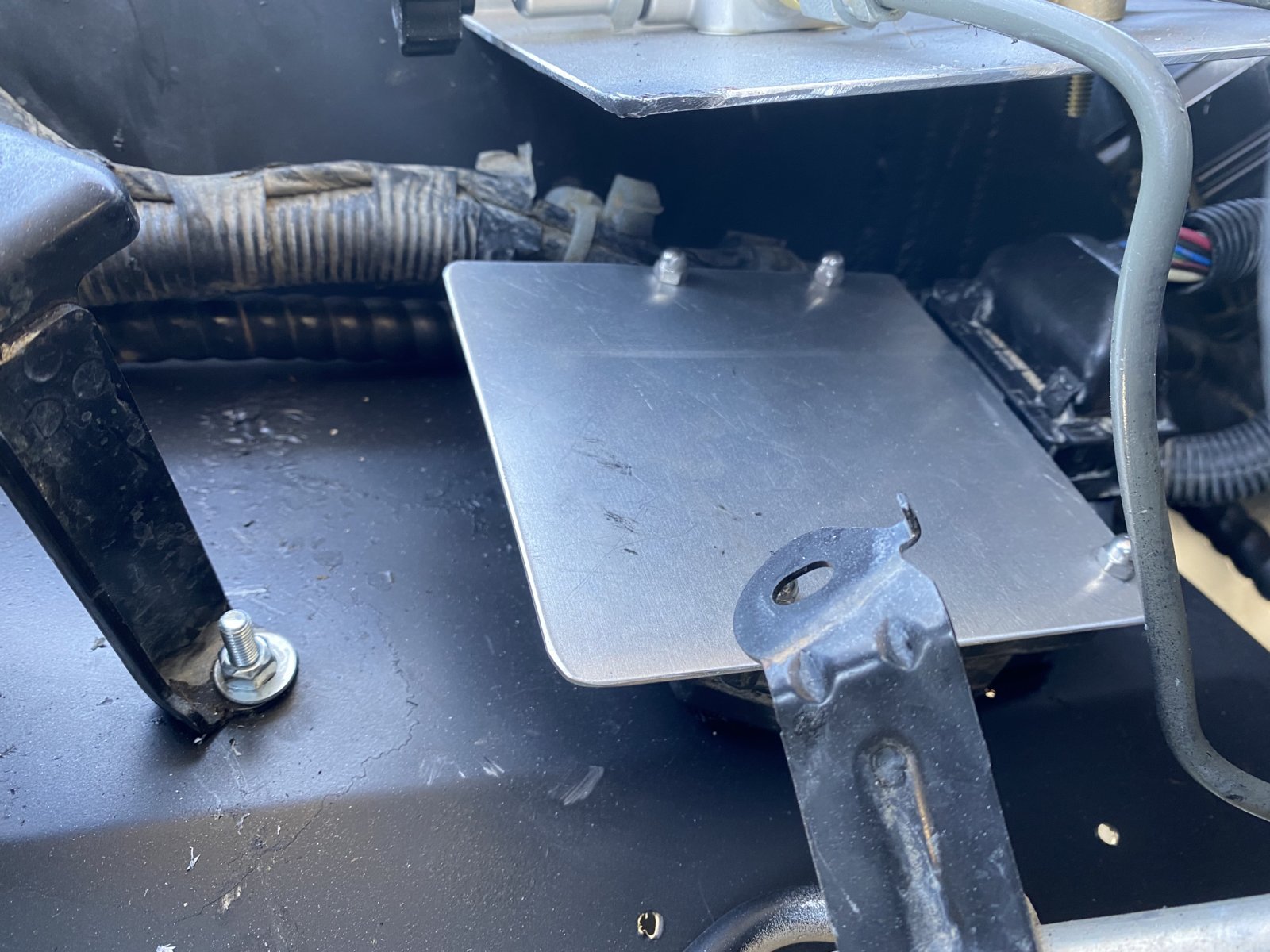

    That is a picture of what I did to the ABS ;)
    What are you looking for exactly??
    Here is a pic of the ABS computer. You can take the ABS module and split it in half, the computer part has a nice oring gasket, so I made an aluminum plate to bolt the computer to and then literally just velcro'd the whole thing to my fender well. You can see the ABS plug on the right side. If this is not what your looking for...give me some more detail.

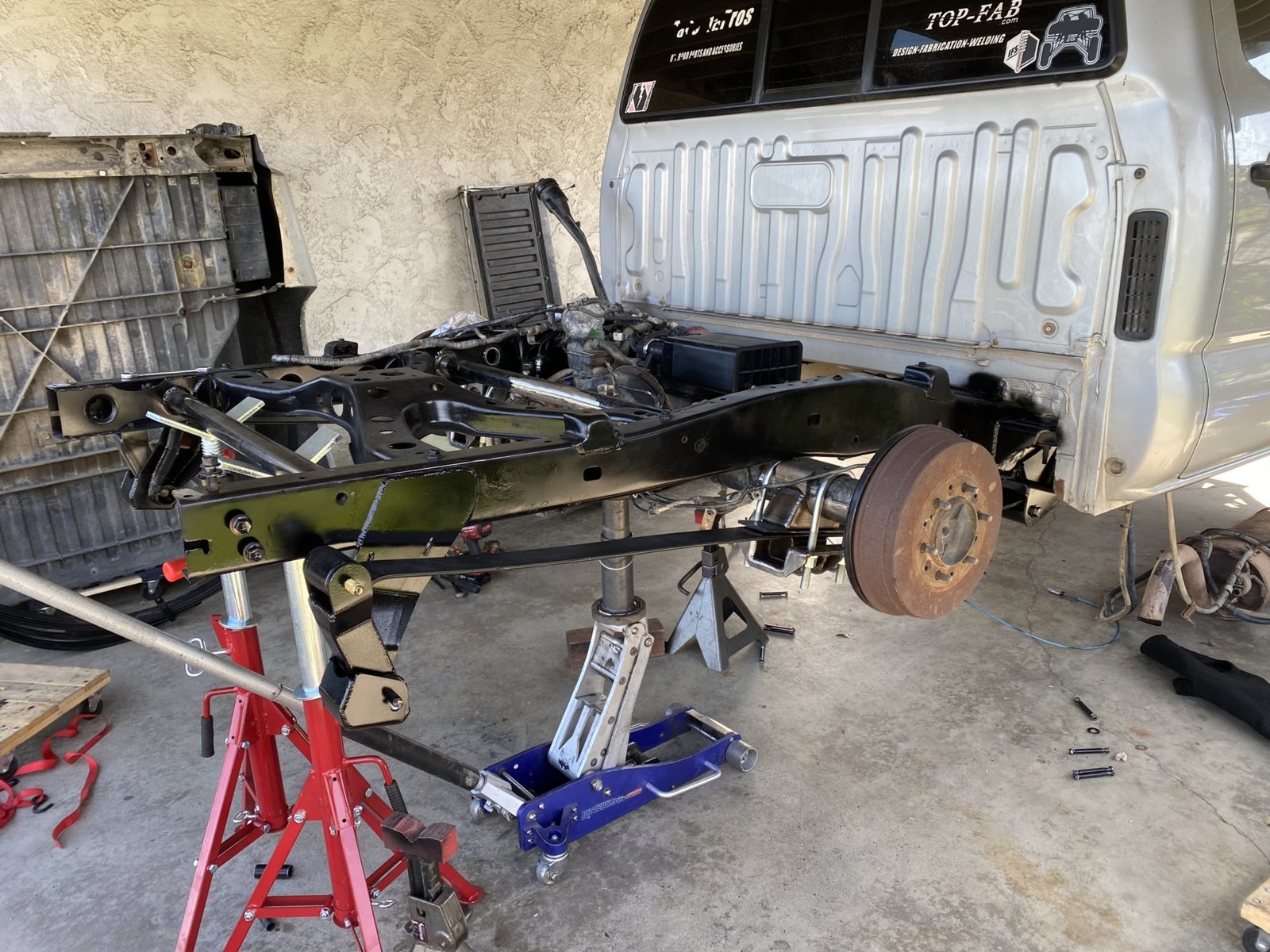

    Some useless travel on my buddies truck today

    Okay thats what i was looking for. Thanks man
    yea I should have asked if you had a picture of what's left of the abs to make it work still lol

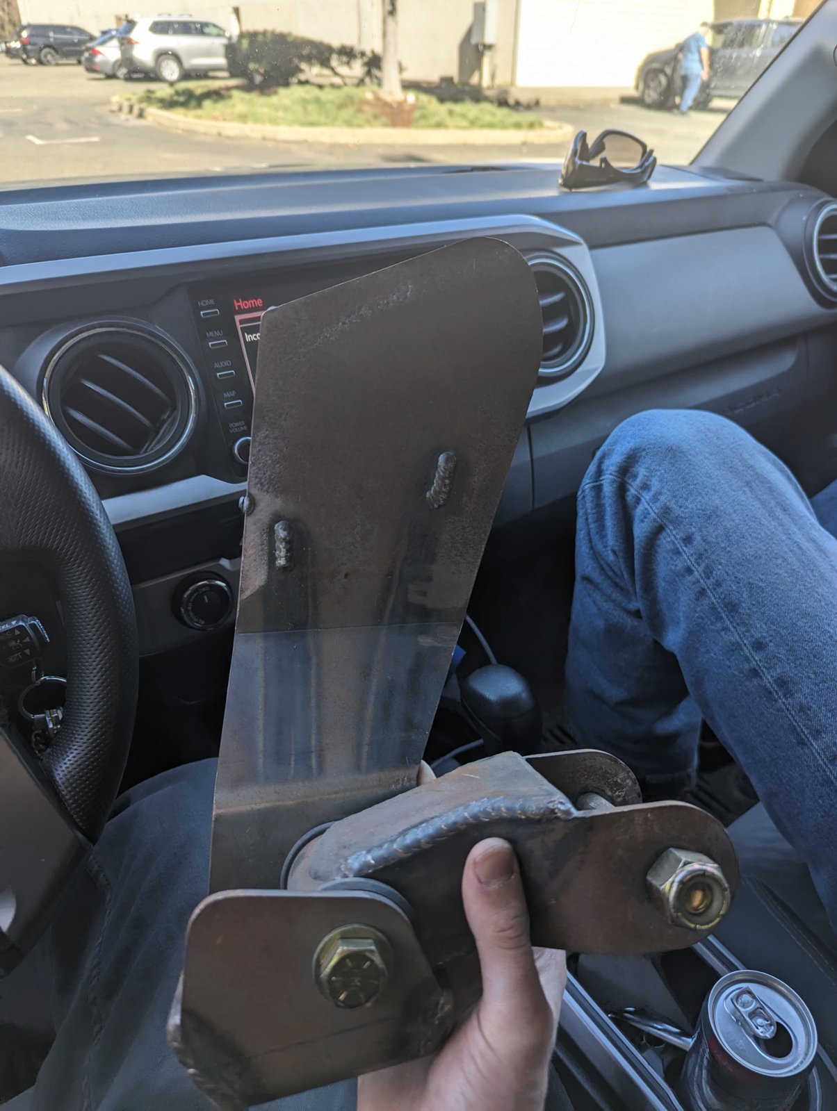

    Never said it was useless travel bud. I’m sure you guys will be properly strapping it! Actually been considering ordering the DMZ kit soon!

    Those shackles are like 2x the size compared to my DMZ kit. Huh weird

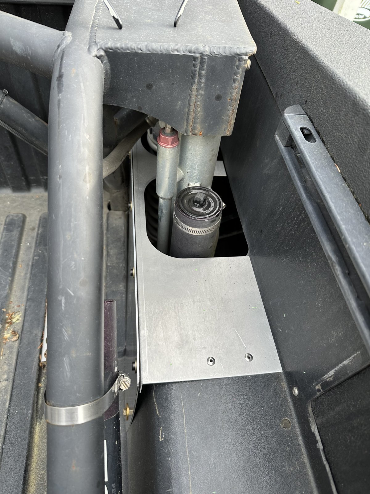

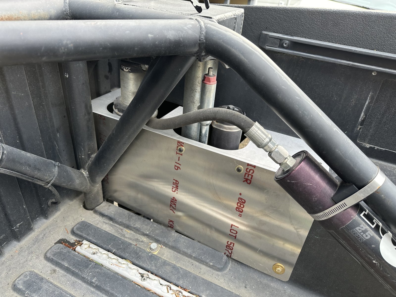

    What are you guys covering up your bed cuts with? Or just leave wide open?
    my bed is wide open at the shocks, but I had some aluminum cut/bent to semi cover the area. Debating adding some rubber in areas to keep grime/mud sling down. noticed a rock chip in the rear window hence the other reason I’m trying to add coverage. Not as clean as some of the welded sheet metal work I’ve seen but o well

    Did you happen to post a picture lately of your kit? I saw a pic not to long ago and thought the shackles looked very short for a DMZ kit

    Yeah that's the DMZ kit I picked up

    Uh oh....ya..that aint right. Guess you could email Tim at DMZ and see if he ever made them that small. Hopefully you didnt get screwed.
