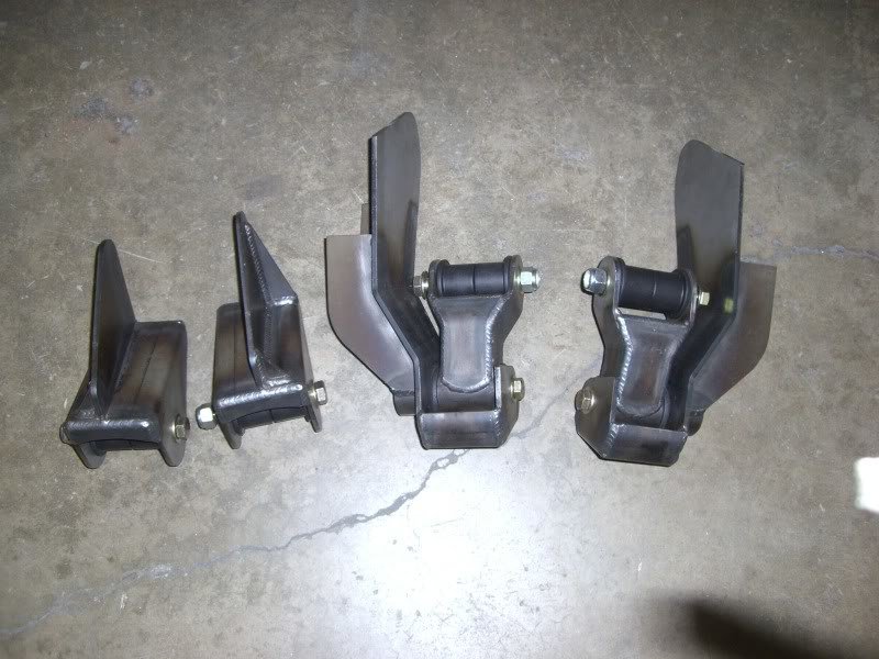

    Possibly Tim changed his kit since Travis bought that stuff. DMZ has been around for many years and I know Travis had been stocking up parts long before he even had the truck that eventually got the DD links.
    Don't look right though.

    Looks like an old version of the kit
    https://www.tacomaworld.com/threads/white-knight-fixedtrd-build.126828/page-3#post-3585186

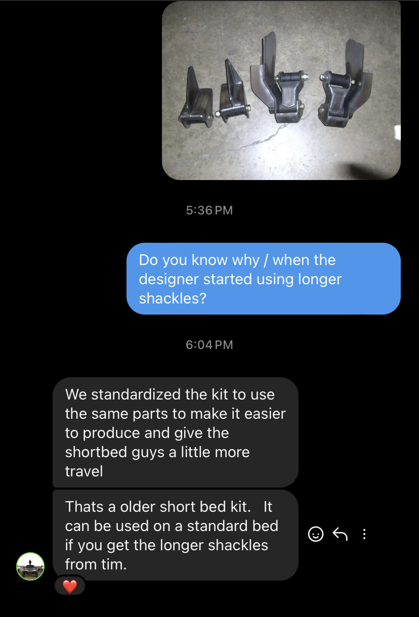

    Anyone have a link to this?

    See if you could make the longer shackles work with the hangers - I’m sure Tim will tell you if they’re compatible and why he changed them.

    I found out - from Tim’s main fabricator (before Tim downsized his operation, and I meant to say ‘design’)

    That's interesting. I appreciate it man, saved me some worry if I bought something wrong haha

    But on second thought, why is there a difference between standard and short bed kits? Don't they share the same chassis? (ACLB vs DCSB)

    Pretty sure Tim will tell you, but might have something to do with driveshaft or frame differences. Not super familiar with 2nd Gen kits as I only built the front end of mine and then sold the kit once I realized I wanted a 4x4 and a bigger cab and bought my 1st Gen. The link I posted of the short shackle kit was was exactly what I wanted to do with shocks not sticking through the bed.

    Tim called me back this morning. He said that those are the short bed shackles that he hasn't made in forever.
    Also he said there's about a 2 - 2.5" wheel travel difference between the two shackles
    He's going to make me the correct length shackles for $200 and send them out to me later this week.
