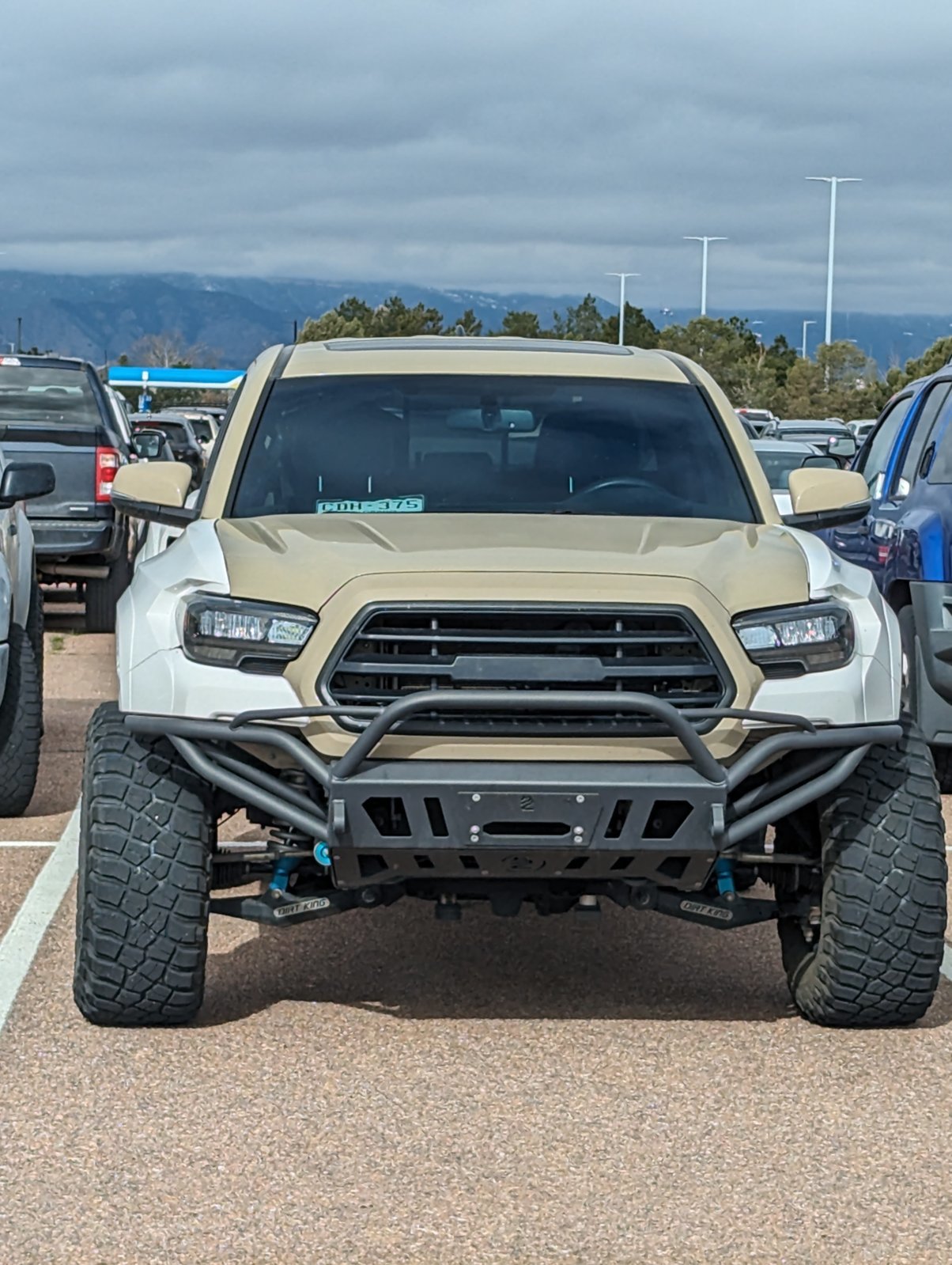

    Is this a +3.5? It looks massively wide but maybe it's just the offset wheels.

    Yeah, I was running a similar setup but with the Icon RXTs instead of the Deavers. It was perfectly capable I just didn't find it very fun in the whoops and felt like I really had to watch my speed... but I have a heavy foot!
    I think it's disingenuous to claim that you're the only person looking at this stuff but I'm willing to concede that you're probably one of the few people trying to pull every quarter inch out of what you have on. I'm strapped at just under 17 and I'm okay with it but I'm sure that's part of why I'm having less issues, too.
    I also think we both know that race trucks aren't seeing the same rocks that crawlers are. The boat anchors really aren't an issue until you're trying to do things with steep rocky inclines like Soup Bowl (below, not me, a truck at the Marlin roundup a few years ago). But like you, that's probably a minority of trucks too.

    Yes that is our 3.5" kit, it looks like it has a pretty negative offset on the wheels or a front wheel spacer
