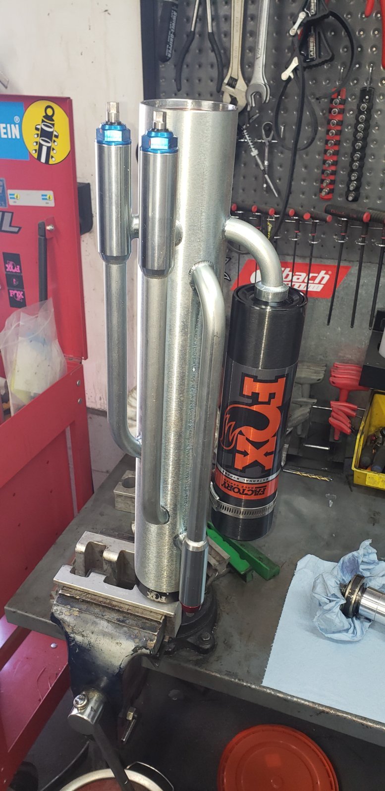

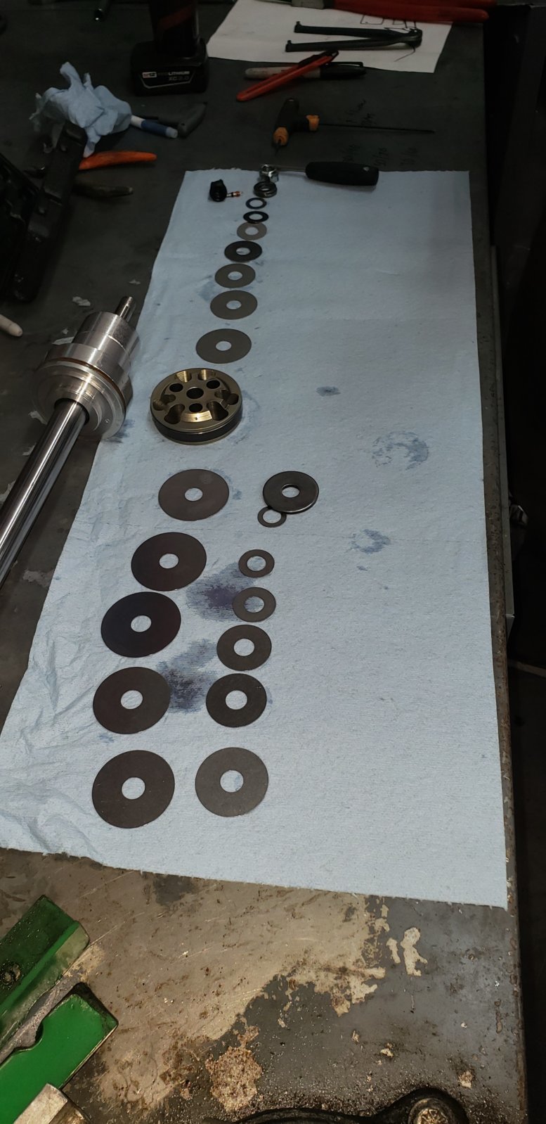

    Have you opened up the shocks/bypass (I don't know what you're running) to see what valving is in there?
    Mine were opened up prior to install and was pleased to see the healthy stack of Face Shims. Which is why I chose the 3.0 option for the rear. I also ordered a pair 3.0's for the front for that exact same reason.

    Yup. I do lots of shock tuning for customers even.
    I went as far as adding bleed holes in the piston to no avail. The rear was flat dialed, until it hit the wall. I was running 35psi in my bumps last year and never once used more than maybe 1/4”.
