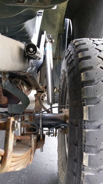

    My buddies truck has SUA with extended/modified BAMF shock towers and 12" shocks. It works good. We have 14" shocks to put on when we do a bedcage and cut the BAMF off. Do it once, cry once.

    you'll be good with the 14" and SUA, you need to re do your lower mounts, you or the installer NEED to cycle and strap/bump it correctly though and like 906taco and I said your shock mounts will be lower but it wont be that bad. Take a look at how low 4runner shocks are mounted off the axle.

    This diagram won't work for Sua because the axle bumps out much higher than soa. Just in case anybody got the wrong idea

    As the pic says "approximate depending on your setup" hes going to have to cycle, bump, and strap (cant stress that enough yotafab) for his truck if he goes with DMZ and the 14'' @YotaFAB its easy you just need a competent installer.

    Well guys. It finally came to me this morning as to what my “wall” could be with the JD SUA.
    At full bump I have roughly 1/2” of shaft showing. And I never used more than 1/4-1/2” of my bump stop that has 2” of travel.
    so let’s do some math in the severity of axle wrap I was seeing.
    It all makes total sense now. From clapping out driveshafts and carriers to why things cycled perfectly with the pack broken down.

    I interested, but don't know if I follow... are you thinking that axle wrap at full bump is causing your shocks to bottom before the bump is bottoming? They cycle fine on the stands but in reality, you got other stuff at play?

    100% what is happening. I’m going to get some actual numbers later today. Curious just how many degrees it boils down to. I was bottoming shocks damn near 2” before full bump because of the wrap. Will report back with numbers.

    I never considered it either. Only because I cycled everything and knew it all checked as good. But after considering certain things it kind of fell into place. Sure as shit. Set screw imprints in my lower rod end.

    are your shackles long enough to allow inflection? an SOA setup would have to go negative to get all the way there

    what pwt and axle are you running lol. thats a TON of wrap!

    4.0 and a 6 speed with the factory rear. Absolutely an insane amount of wrap.
