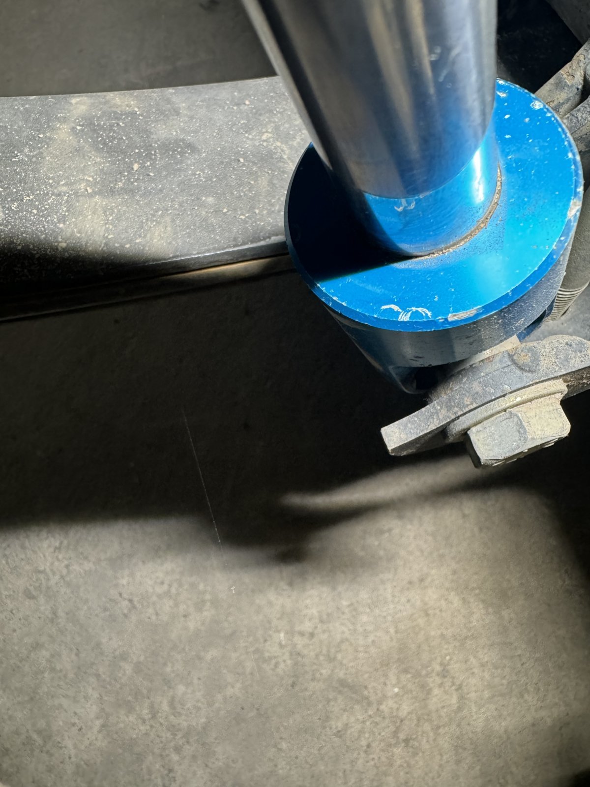

    Bushings are good, bolts seized and had to cut them

    Anyone has a king lower rod end available with pressed bearing in it, dont care if its bad just need to mock up some mounts

    have you cycled the rear end with just the main leaf, no nitrogen in the bumps, or shocks. Your bump might be mounted to high, if everything checks out with the shock/bump mounts id say you've probably got something binding somewhere for sure.

    I was going to say, with 14's and SOA, that lower shock mount is pretty low, comparable to stock. I've installed half a dozen AG relocations with 14's and SOA. If the axle is able to move multiple inches higher due to SUA, that lower perch would be super low, if it's even possible to rotate it that low without interference in other places.
    edit: Could just keep a 12" in there and redo the lower mounts I guess. It wouldn't run into that interference issues and you'd gain the benefit of increased uptravel. If that doesn't work out for you, you're hardly worse off since you only had to redo lower mounts.

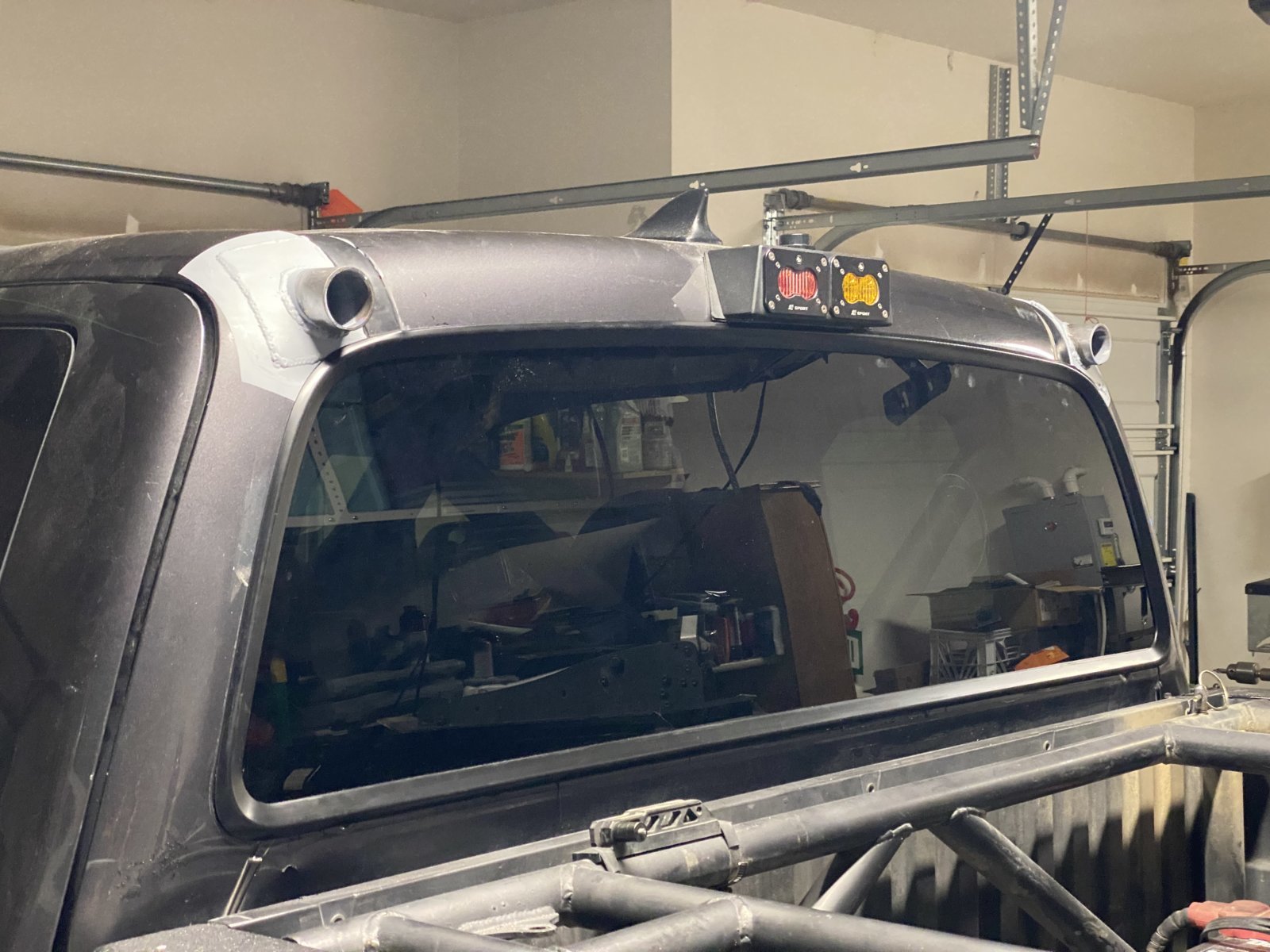

    what chase light is that? is there drilling required for that?
  10. Apr 12, 2024 at 12:50 PM
    Airdog
    Airdog did your Mom
    Dec 26, 2012
    #93790
    4,889
    Tom
    SoCal
    https://www.tacomaworld.com/threads/airdogs-2012-prerunner-access-cab-slow-build.264263/
