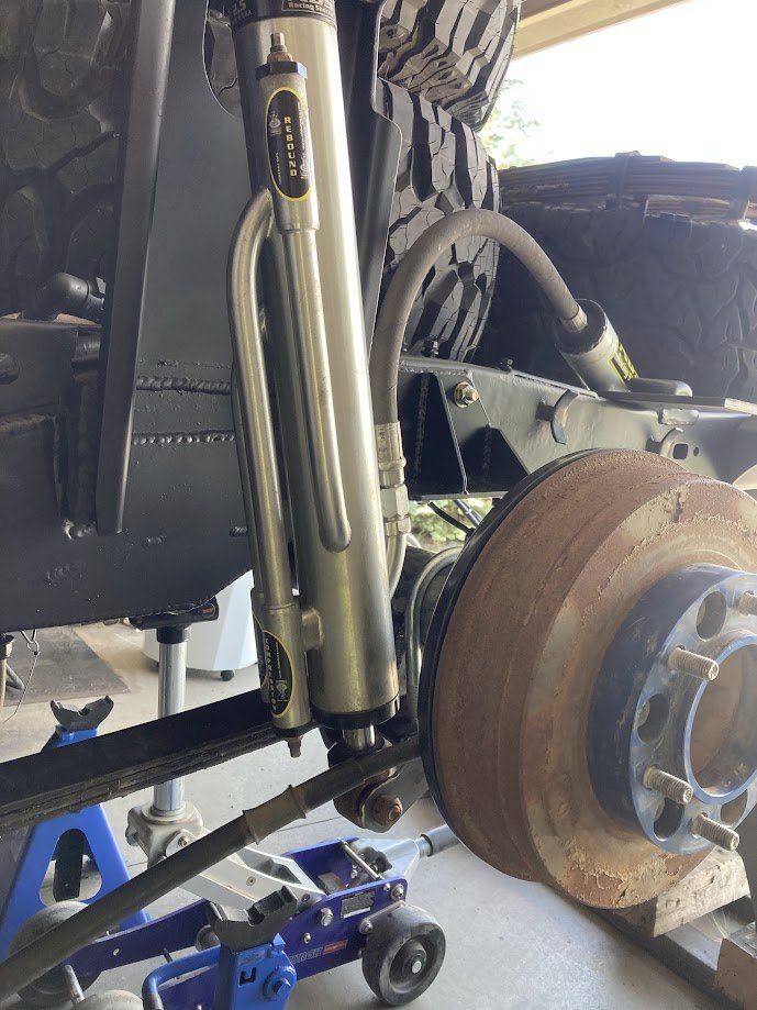

    @906taco If I pull the spare and more to get super light. I feel the rear raise. But after the springs have settled and the rear has gone down. I dont feel it. Plus yea, through the UMP and such. The 3.5 is a dog

    I’m curious if you look at your lower rod end if it shows any indication of bottoming. How much shaft were you showing at full bump?

    @snowsk8air2 Might have photos of where its bumped. I know we made a spacer but, I am also re using the 12" shocks and Archive towers. So my shock angle is different than what comes with the frame braces.

    Digging through the archive of pics.
    I dont have a pic of the bumps. we had to make a 1" Delrin spacer for the urethane bumps it comes with.

    Looks like you have a bump pad on the shock shaft anyways. So likely isn’t going to show anything.

    His shocks have the 1/2” rubber bump spacer on them. Full bump is when that touches the shock body giving it that 1/2” of safety net.
    But like he said we used the archive upper shock mount so geometry is gonna be a little different than the full jd kit
