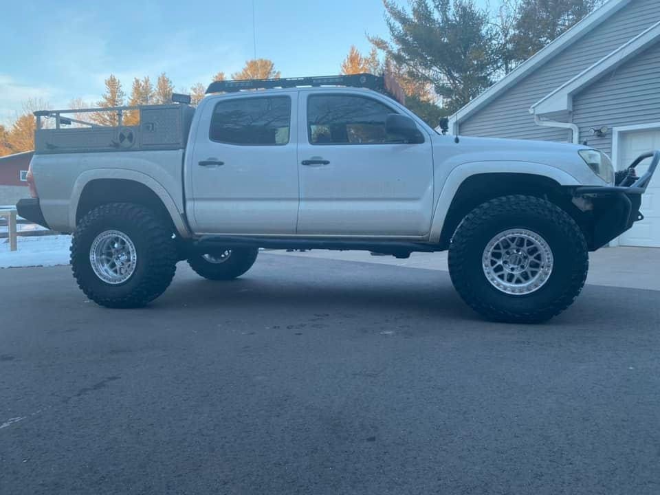

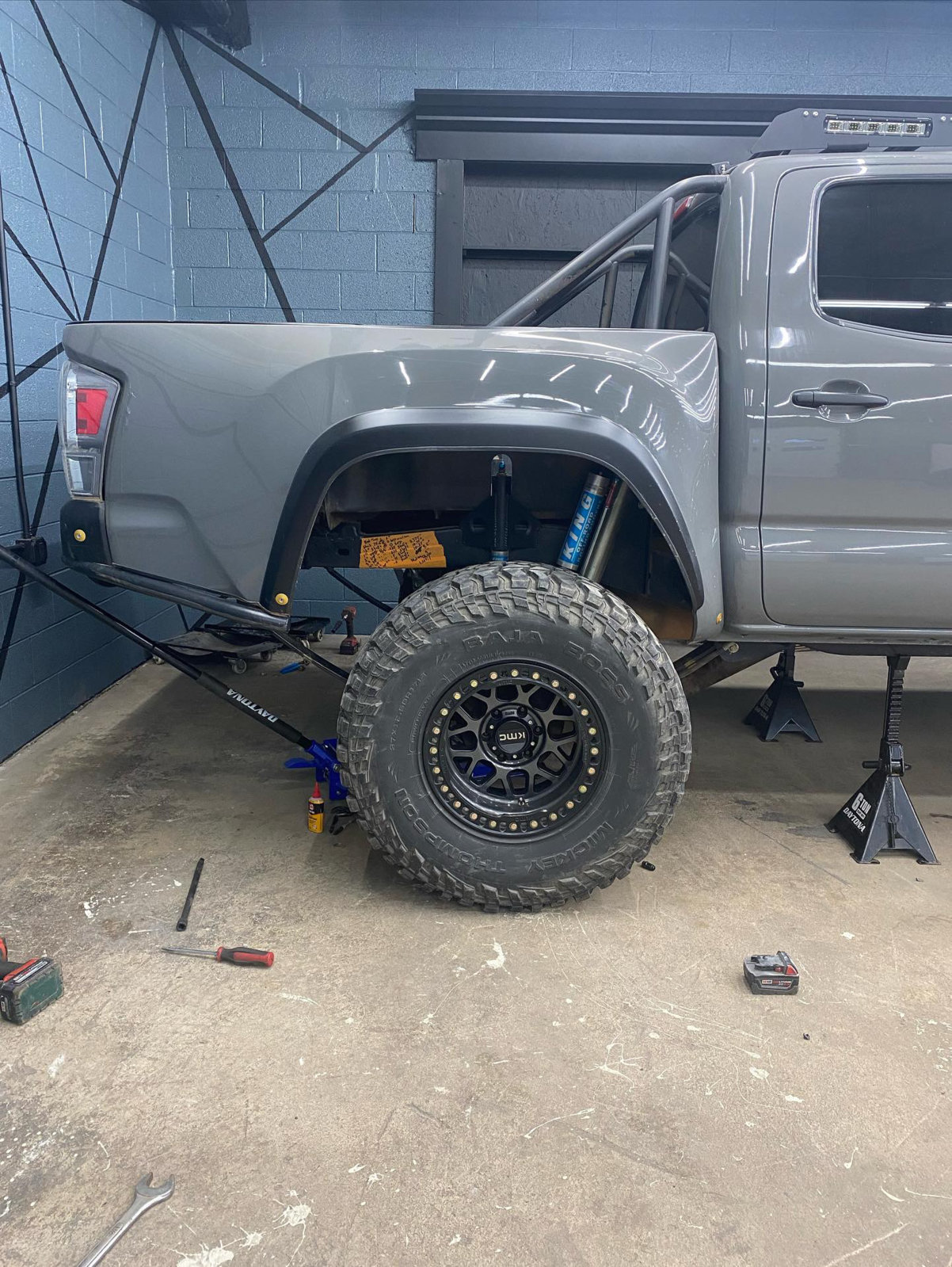

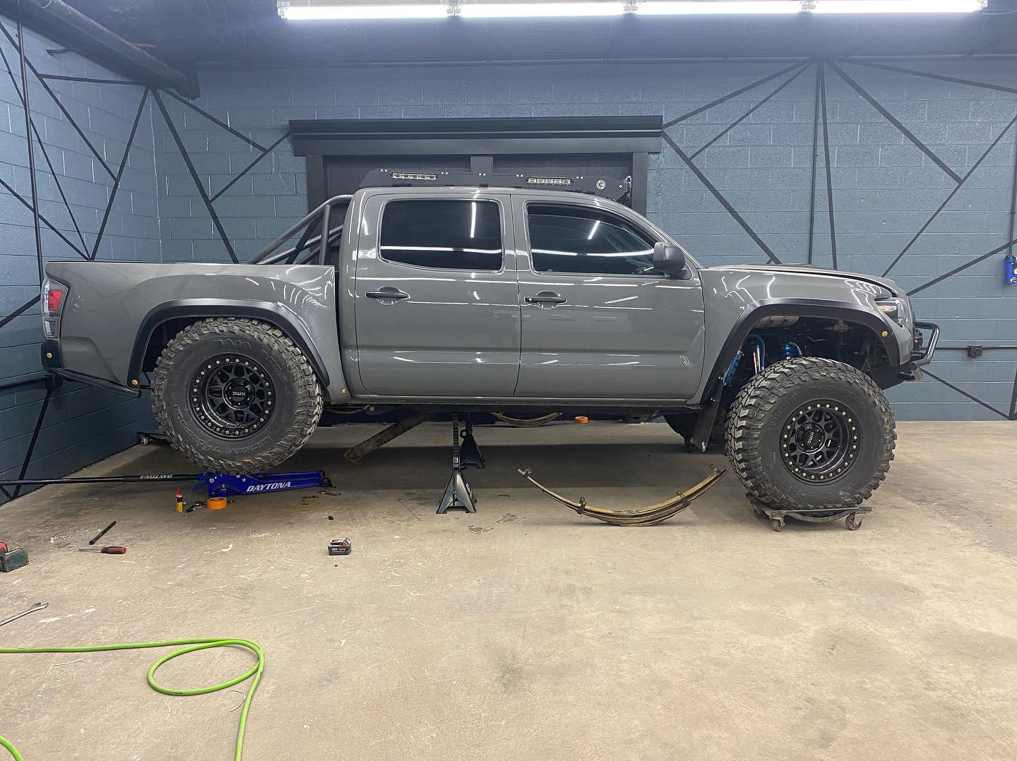

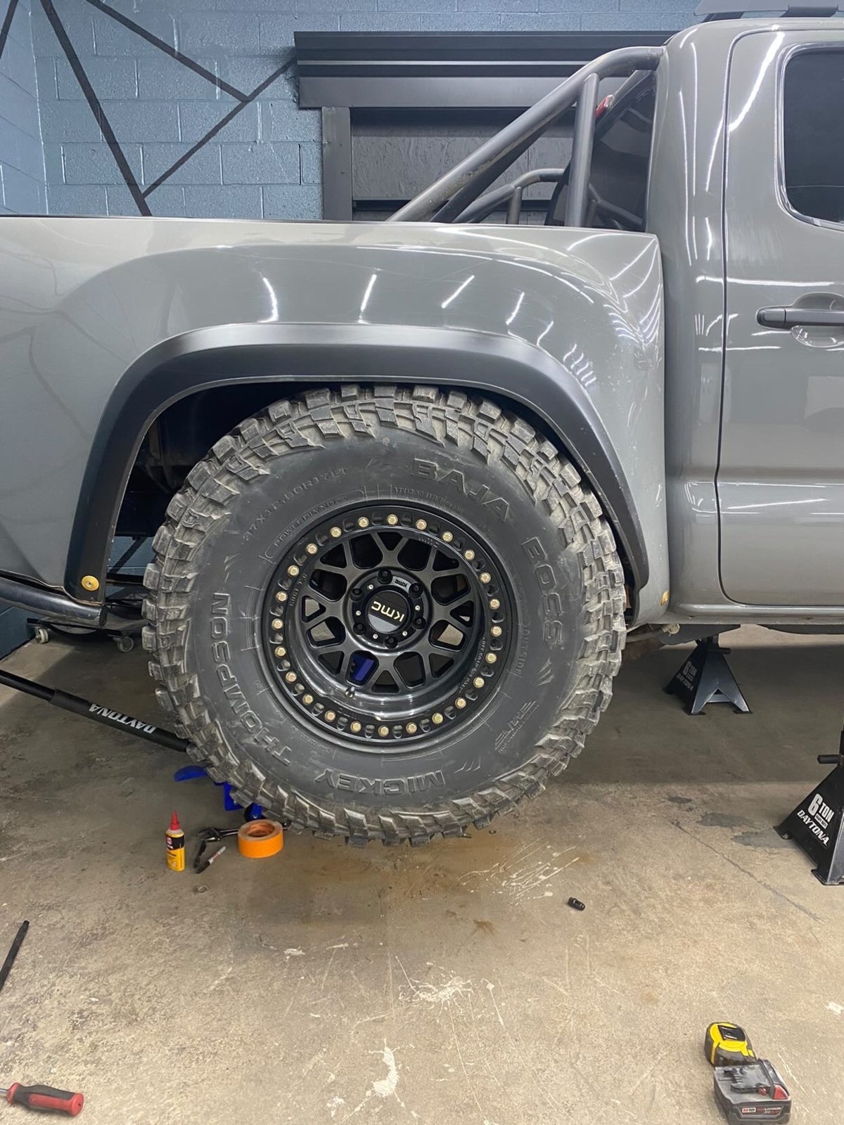

    Here are some side shots. Plus a shot of the truck when it was white on the same wheel and tire package with SOA.

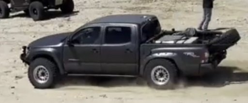

    hmmm, at full droop I get very little day light between my leafs, like I get the same day light between leafs with the friction pads, once at full droop I do get a tad more but that's like at even enough to measure.
    My wheel seems to be centered in the wheel well too.
    Screen capture from my last movie, its rough but it seems to be centered, stock bedsides with flares trimmed of course.
