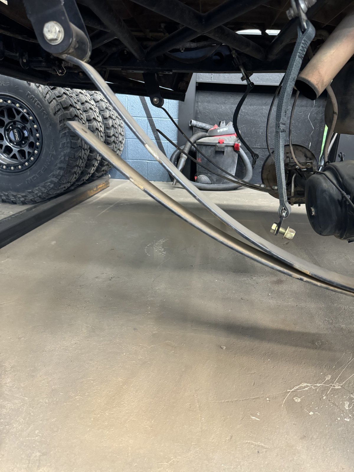

  17. Apr 13, 2024 at 10:28 AM
    906taco
    906taco Well-Known Member
    Jun 22, 2021
    #369289
    3,893
    Cory
    08 Taco
    My separation at full droop with straps disconnected. The clamps aren’t on as the packs are broken down so it shows the actual severity. If I hook up my straps it’s gone. But also eats 2” of down travel.
    Caboose117 likes this.
  18. Apr 13, 2024 at 10:33 AM
    SoCaltaco65
    SoCaltaco65 Well-Known Member
    May 10, 2011
    #56389
    7,651
    2011 DCSB 4x4 Offroad TRD
    I may be talking out of the side of my neck, but if the pack is fully assembled with the Deaver holder/clamps on it wont be like that.
    those clamps from deaver are there to keep the leafs aligned and to limit the separation ??

  20. Apr 13, 2024 at 10:37 AM
    906taco
    Jun 22, 2021
    #369289
    3,893
    Cory
    08 Taco
    Separation is separation my friend. Yes that’s part of why the clamps are there, but ideally you don’t want to see any separation. It’s an indicator that the pack is being stretched and pulled in an unnatural manner. Look at the DMZ kit for instance. 0 separation at full droop metal to metal unstrapped.
