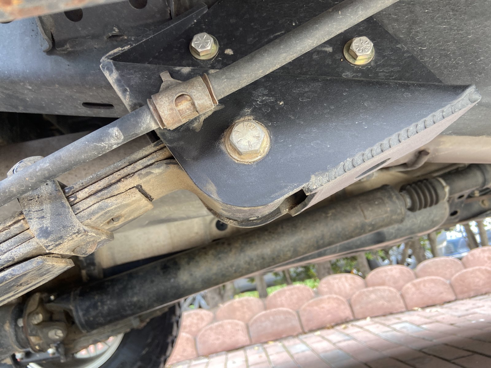

    #369289
    3,907
    Cory
    08 Taco

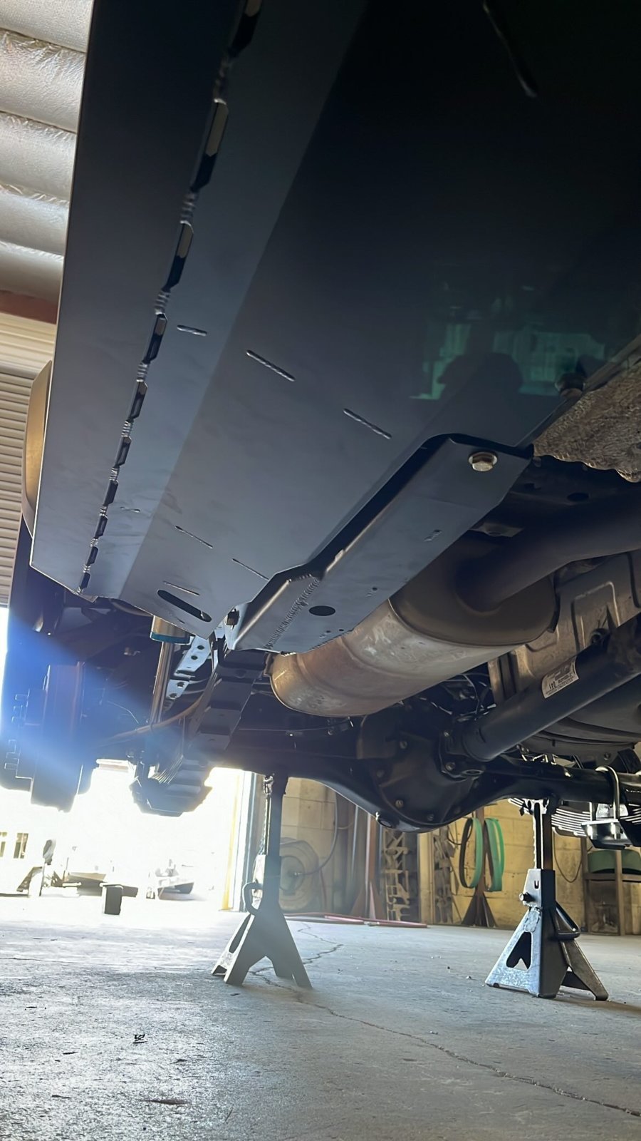

    I have 57” as a measurement right now. I had intended on bringing my front hanger back to compensate which would have also helped with shackle angle and centering the tire.
  2. Apr 13, 2024 at 1:07 PM
    Happysmiley
    Happysmiley Well-Known Member
    Jan 30, 2012
    #71746
    393
    Fabien
    Northern NV
    89 pickup 87 pickup 2016 4runner
    57" is way off, that shackle is too vertical at ride height
    moving the front hanger back 3-ish + inches is too far to get to a 53" ish spread
    can you get to your bolts/nuts for the shackle pivot boxes through the dimples on the frame boxing ?
    If you can drill new holes and mess with your shackle pivot box position, I'd move it forward at least 3 inches if not more
    Or once you get the pivot boxes off, strip the paint, tack the pivot boxes for cycling, and when you find the right spot just weld them on
    if you have room to move the front hangers back 1" or whatever you need for wheel base do that 1st then mess wit the shackle but i think you will still need to move the shackle on top of moving the front hangers if that's what you want to do
    AGAIN 53" is a ball park for a 9" shackle on the bottom of the frame going basically flat at full bump so use it as a starting point
    Go work on it now !

  3. Apr 13, 2024 at 1:20 PM
    906taco
    906taco Well-Known Member
    Jun 22, 2021
    #369289
    3,907
    Cory
    08 Taco
    Thought was moving the hanger back about 1.25” that would center my wheel and help with shackle angle, then yes the shackle pivot would be moved forward.
    Definitely H70 springs as well. Those dimensions have been checked numerous times now.
    I would need to make new shackle hangers as well as they will not allow the shackle to travel back much further.
  4. Apr 13, 2024 at 1:36 PM
    Happysmiley
    Jan 30, 2012
    #71746
    393
    Fabien
    Northern NV
    Looks like the shackle could pivot pretty far back if its in the bottom hole , maybe trim that angled cut of the back of the pivot box that goes to the side frame plate if it hits there ?
    I'll have to take your word for it if you say it won't clear because I'm just looking at pics online
    That's all your gonna get out of me, hope you get it sorted out, they are just leafs , good luck !
    Wishbone Runner and 906taco like this.

  7. Apr 13, 2024 at 2:05 PM
    SoCaltaco65
    SoCaltaco65 Well-Known Member
    May 10, 2011
    #56389
    7,656
    2011 DCSB 4x4 Offroad TRD
    The first picture looks like there is enough room to drill holes back or towards the rear shackle at least an inch.
  8. Apr 13, 2024 at 2:11 PM
    SoCaltaco65
    May 10, 2011
    #56389
    7,656
    maybe its just the angle but yours looks like it is forward of mine.
    Happysmiley and SoonToBeOn39s like this.

    It looks that way to me too but I cant compare because the frame brace changes that mount substantially. Which might explain why folks with newer revisions and/or the frame brace don't have this issue.

    Looking on JD's site looks like it is setup the way theirs is in the pics for the leaf kit
    You have the shackle pivot boxes all the way forward for the 3 holes and your front hanger looks like it's in the correct-ish area
    I have my way of setting up leaf springs inline with the way most people did on older Toyota pickups and 1st gen Tacomas using 12" shackles above the frame or 9" shackle either through the frame or on the bottom.
    Handles great but doesn't love bigger bed weight / payload changes
    I'm sure they designed their kit the way they did for a reason, they've been in the game for a long time.
    There is enough free travel in the shackle for the cycling of the spring so there is room for different ways to set things up
    If I had their kit I would move stuff around closer to the dimensions I listed earlier because that's just how I personally like to setup leafs
    The older I get the more I realize there is rarely a single "right" way to build things

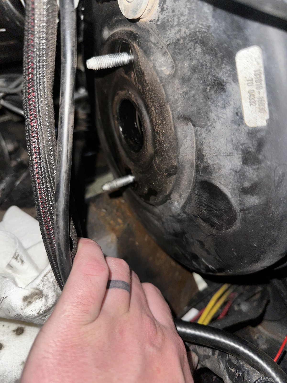

  16. Apr 13, 2024 at 7:48 PM
    Pittsy
    Pittsy Ex car guy, currently in rehab
    Jan 20, 2022
    #387923
    2,558
    AZ
    07 DCSB 4x4, 25 Tundra Limited
    BTF Fab +4.5 - DMZ SUA - TE Cage - LS6 Swap
    Welp. I can’t pull my OEM brake booster out because of the JD fab inner fenders. Time to cut out a chunk to get this out.
  17. Apr 13, 2024 at 7:51 PM
    RonRon23
    RonRon23 Well-Known Member
    Aug 25, 2013
    #111135
    1,302
    Ronnie
    Buena Park
    2013 MGM DCLB 4x4
    Front suspension: Work in progress JD Fab +4 LT, LCA pivot kit, steering slide rack, 934CVs Rear suspension: Archive Garage shock relocation and SUA Conversion,King 14x2.5 shocks, King 2x2 hydro bumps, FN wheels 5 stars, sliders
    I had to massage my fenders a lot to clear the booster.
  18. Apr 13, 2024 at 7:54 PM
    Pittsy
    Jan 20, 2022
    #387923
    2,558
    AZ
    It’s gonna take a lot more than massaging, it’s interfering by like over an inch
  19. Apr 13, 2024 at 8:07 PM
    RonRon23
    Aug 25, 2013
    #111135
    1,302
    Ronnie
    Buena Park
    2013 MGM DCLB 4x4
    Yeah. 4lb hammer massage
    tacotunner06 likes this.
  20. Apr 13, 2024 at 8:07 PM
    Pittsy
    Jan 20, 2022
    #387923
    2,558
    AZ
    I’m thinking angle grinder massage
