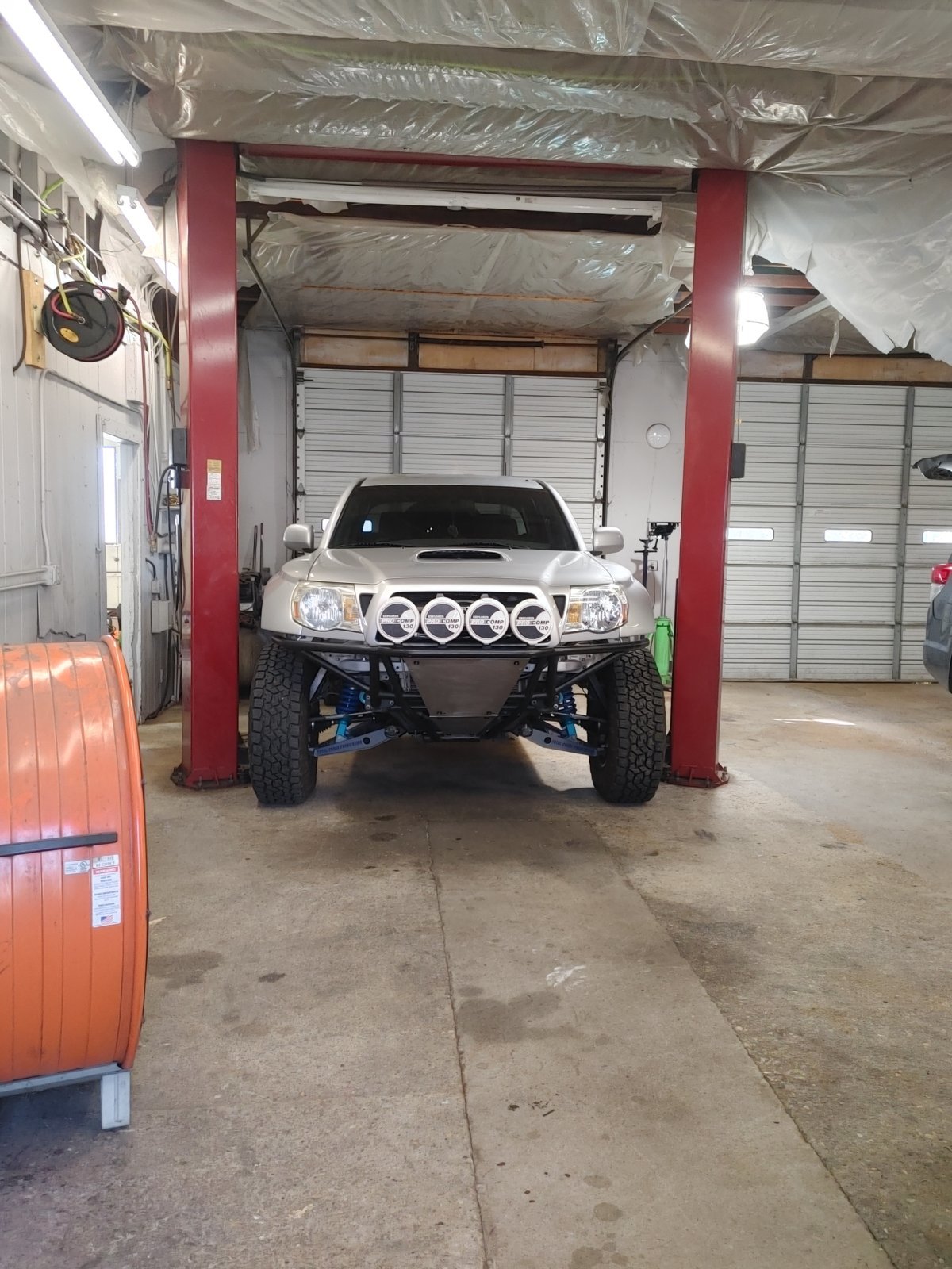

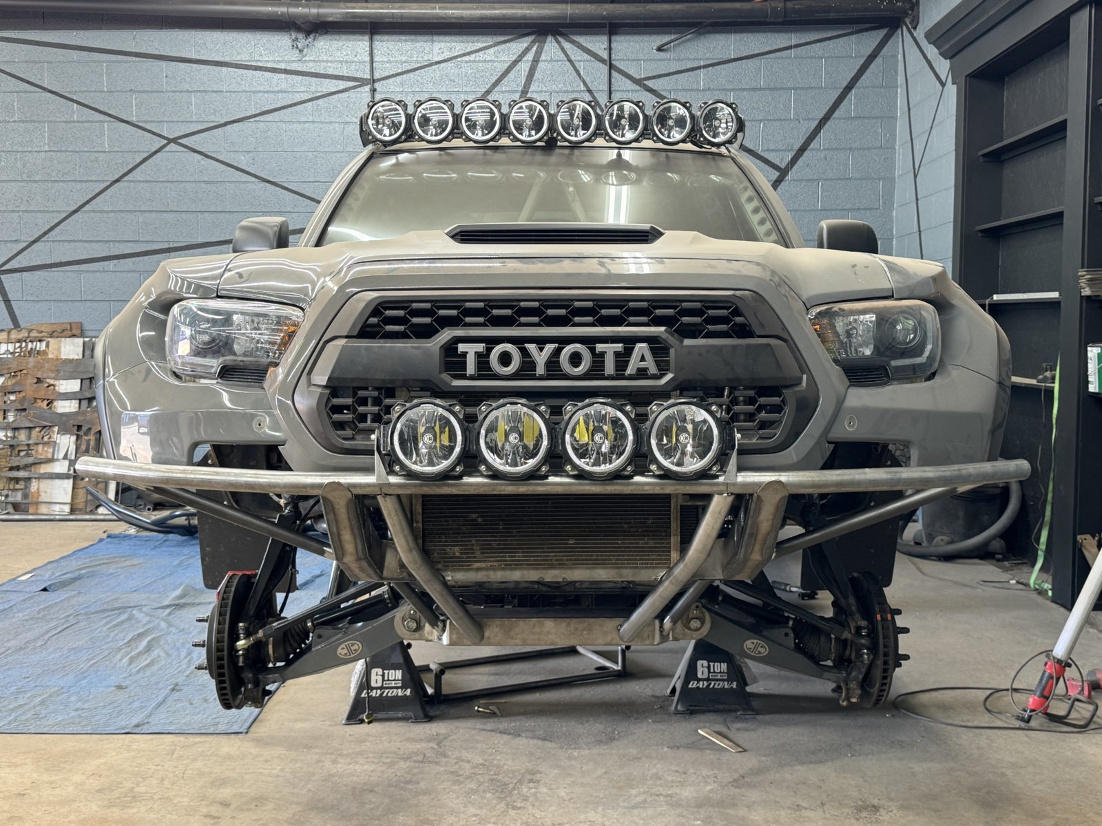

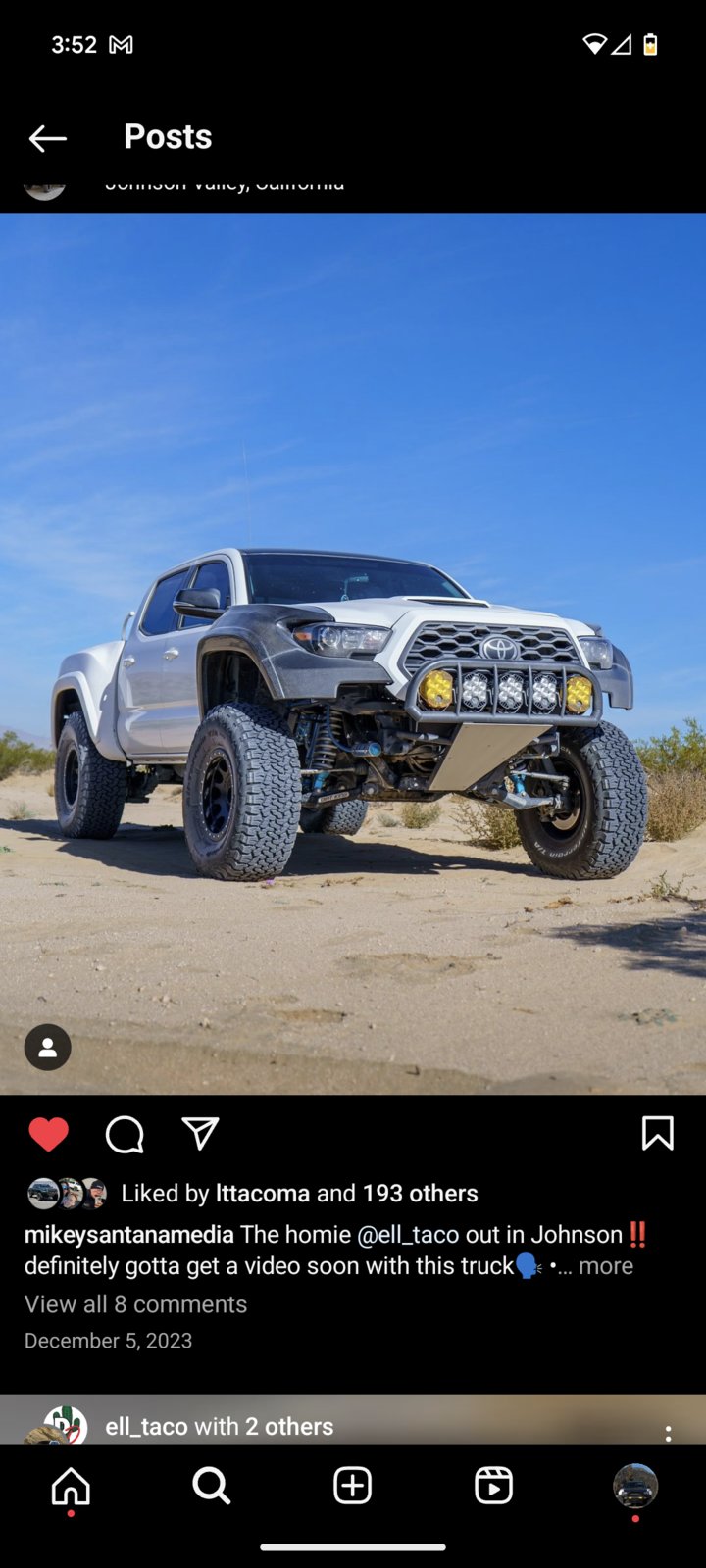

    I finally got bigger tires 2020 Long Travel Tacoma 1997 MAGNUM
    Hell yeah, excited!
    I'm wanting to make a bumper about this wide with those brackets

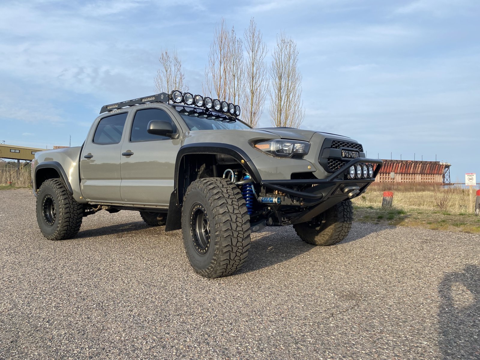

    Looks awesome!

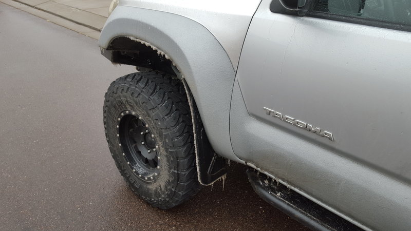

    I haven't installed glass fenders/bed-sides before. What all is involved with fitment? Is it trimming, adding glass? drilling holes?

    Depends on what kind of end result you want honestly. Easily have a couple hundred hours fitting and finishing on this. But for the most part it’s drilling holes, trimming and filling.

    On mine I used rubber well nuts. This made it so if I ever hooked a flap it wouldn’t destroy the glass. Glad I did too, because I tore a couple of flaps off now. But zero damage to the glass.

    Damn that's a good looking setup! Nicely done.

    I used L brackets and well nuts. 100% don’t recommend making them true solid mounted.

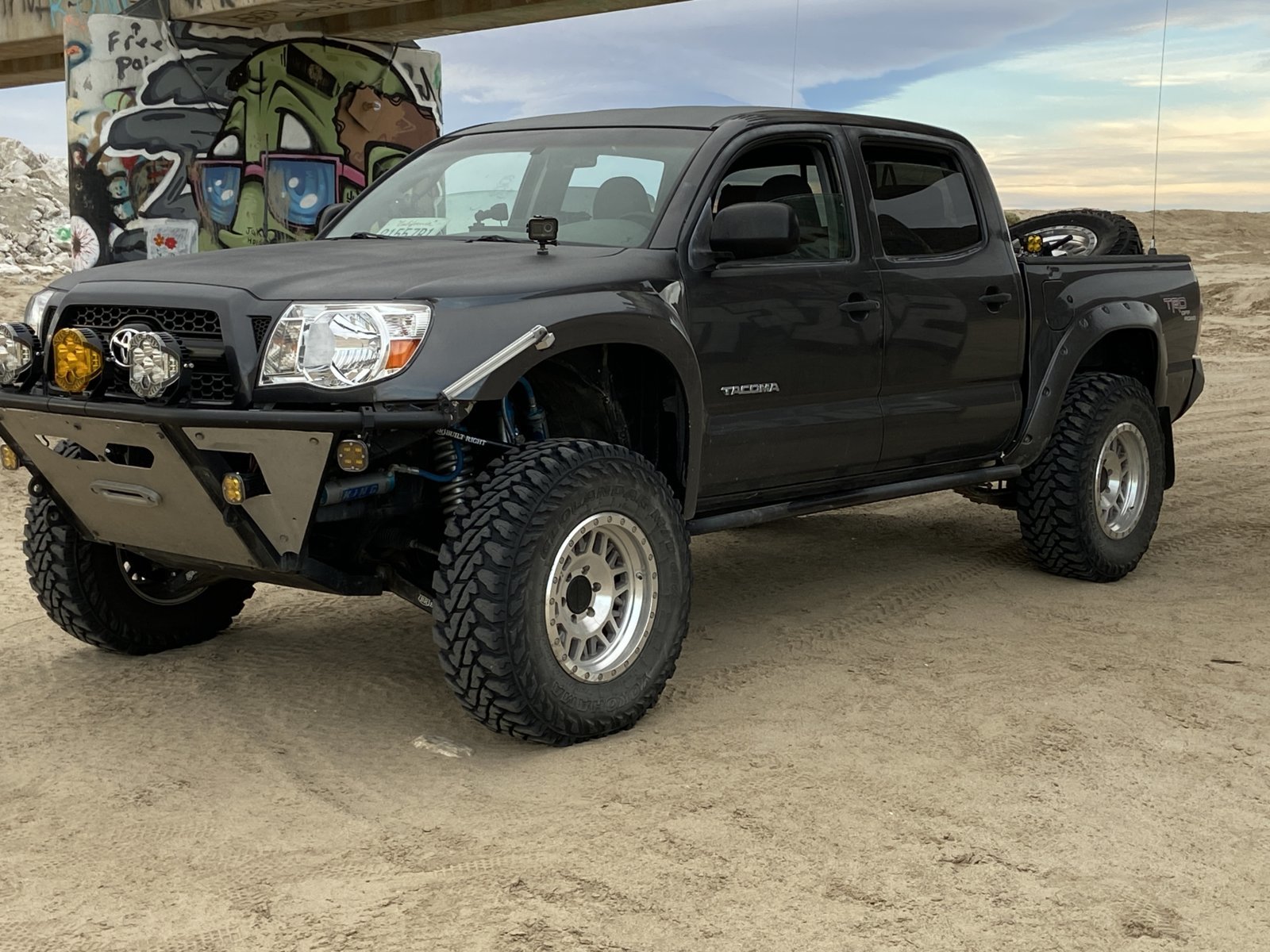

    Stock bedsides, trimmed with fender flares. McNeil front glass
